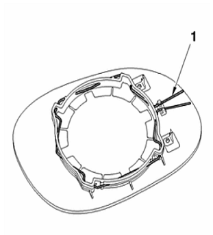

Xsara Picasso Only:
These sensors are available quite commonly - the original part number is: 6445F9 and costs £48.02 from Citroen - but you can google this part and pick them up quite cheaply
Here on Amazon: https://www.amazon.co.uk/External-Tempe ... B07VXQKFX7 for £7
Or a slightly cheaper OEM one from an ebay seller: https://www.ebay.co.uk/p/1938046634
Fitting it is similar, but will probably involve a bit of faffing to get to the wires - the mirror should be easy to remove - but you will have to see whether you can snip the wires internally just inside the mirror housing and join the new sensor, or whether you need to remove the door card panel and mirror to do it.
Unclip the clip ( 1).
Disconnect the connectors (according to equipment).
Remove the glass from the mirror.
Ensure that the spring clip ( 1) is correctly located in its mounting.
Clip the unit onto its support.
Once you get the glass out the way, you will have a better idea and hopefully can remove the sensor and reattach a new one at the local area of the housing.
