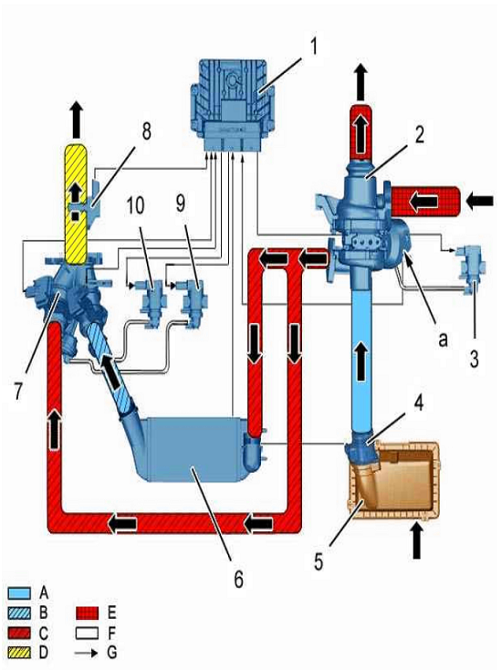

I'm looking for a diagram show where all the vacum pipes etc go from and to the Turbo and solenoid valves.
Citroen service parts show it partially but not fully.
Can anyone help ?

Re: Looking for
C5 X7 (DW10CTED4) Air Flow System
Click Image to Zoom
Key
Click Image to Zoom
| Reference | Designation |
| "a" | Turbocharger Blades Control Diaphragm (With Position Copy Sensor) |
| (1) | Engine ECU |
| (2) | Variable Geometry Turbocharger |
| (3) | Proportional Electrovalve Controlling The Variable Resistance Turbocharger |
| (4) | Air Flowmeter by Mass |
| (5) | Air Filter Unit |
| (6) | Turbocharger Air Cooler |
| (7) | Double Air Mixer With Position Repeat Sensors |
| (8) | Inlet Air Pressure and Temperature Sensor |
| (9) | Turbo Air Cooler By-Pass Control Electrovalve |
| (10) | Air Metering Unit Control Electrovalve |

Re: Looking for
Marc,
There appears to be only 1 position sensor on my air flow meter, is this correct.
Kenny
Kenny
C3 1.4 petrol (SWMBO)
- x 6956
Re: Looking for
The flowmeter for the air mass measures the flow and the temperature of the air entering the turbocharger and transmits the information to the engine ECU. It has a single electrical connection - there are no solenoids / electrovalves on this unless you mean something else.
Not to be confused with the Air Doser (7)

Re: Looking for
Marc,
I've got confused it's the air doser i'm talking about
Kenny
Kenny
- x 6956
Re: Looking for
Kenny - have a look at my posts here on this thread and the diagrams before, for this engine.
viewtopic.php?p=605199#p605199
I knew I put this up before, but just located it. So only one is used.....
