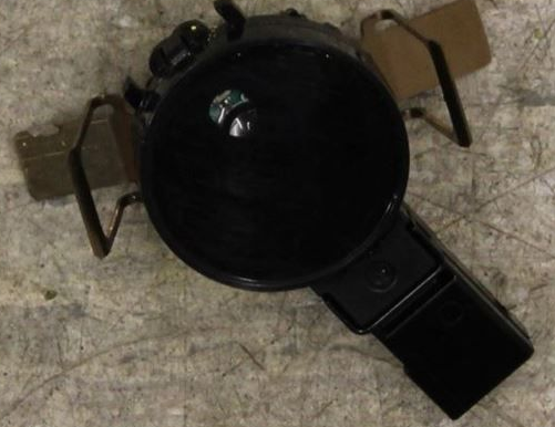

Re: Rain sensor not working on 308 T9
Here's the sensor - 2 examples
This one Is how it should look - nice and clear. | Here's a bad example - all the glue and debris - the sensor area is probably opaque and not much good. |
