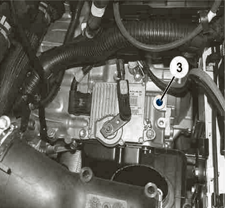

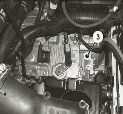

Draining & Refilling AM6C Auto Box (DS5)
Always replace the following parts:
Note: (zipdip) - You have a Euro 5 vehicle and therefore you need AW-1 oil oil - not JWS 3309.
The oil type "AW-1" in AT6 and AM6 gearboxes with engine version Euro 5 is specific and cannot be replaced with oil type "JWS 3309".
Drain& Refill
CAUTION: The gearbox must be drained when the oil is hot (60 °C minimum), to eliminate the impurities suspended in the oil.
N.B. : The oil change is partial, since the converter cannot be totally drained.
Put the vehicle on a hoist.
Remove the under engine protection.
Refilling
Fit:
Dry gearbox oil capacity: Approximately 7 litres.
Type of oil (Red):
EURO 5 engine: AW-1 oil
EURO 4 engine: JWS 3309 ESSO oil
Volume of oil remaining after draining: Approximately 4 litres.
Quantity of oil to be replaced: Approximately 3 litres.
Refit the filler plug (3) (equipped with a new seal).
Initialise the used oil counter (Follow the diagnostic equipment procedure).
Check the Oil Level
Prior conditions:

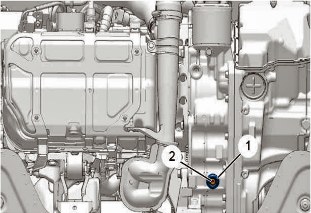

If there is a stream of oil then reducing to a sequence of drips:
Refit the oil level plug (2).
If there is a sequence of drips or nothing:
Refit the oil level plug (2) (equipped with a new seal).
Refit:
- Drain Cap Seal
- Gearbox Oil Filler Plug Seal
| Topping up Cylinder - Tool 0340 |
Drain& Refill
Remove:
Fit:
- The oil overflow and drainage plug (1) (equipped with a new seal)
- The top-up plug (2)
| Remove the filler plug (3). Use tool [0340]. |
Type of oil (Red):
Check the Oil Level
Prior conditions:
- Vehicle level
- Check that the gearbox is not in downgrade mode
- Remove the filler plug (3)
- Add 0,5 additional litres of oil in the gearbox
- Apply the brakes firmly and move the lever through the various selector positions
- Gear lever in position "P"
- Engine running at idle
- Oil temperature 60°C (+ 8 ; - 2 °C) (Measurement of the parameters using diagnostic equipment)
- Refit the oil level plug (2).
- Stop the engine.
- Add 0,5 additional litres of oil in the gearbox.
- Repeat the top-up procedure.
Refit:
- The oil filler plug (3) (equipped with a new seal)
- The protective panel under the engine
- The air filter housing
