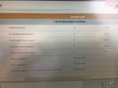

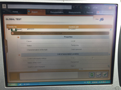

So, plugged the car into diagbox and here’s the results (not a bloody clue what any of it means by the way apart from The sidelight bulb).
Looks like the pics have loaded in reverse order so best to start from the bottom 😂😂

Not being funny or anything, but not much of that is going to help unfortunately as from the last picture you would seem to have 9 engine ECU faults - and the rest of the screenshots are not very helpful as some of these are missing the fault code, so we don't know to which of the 9 faults they relate to... I can just about make out a few codes....
A list of the 9 engine ECU individual fault codes would suffice initially so we can see what they all are.
Ditto for the 2 gearbox faults and the ABS fault.
It would seem you have a few issues going on here...
