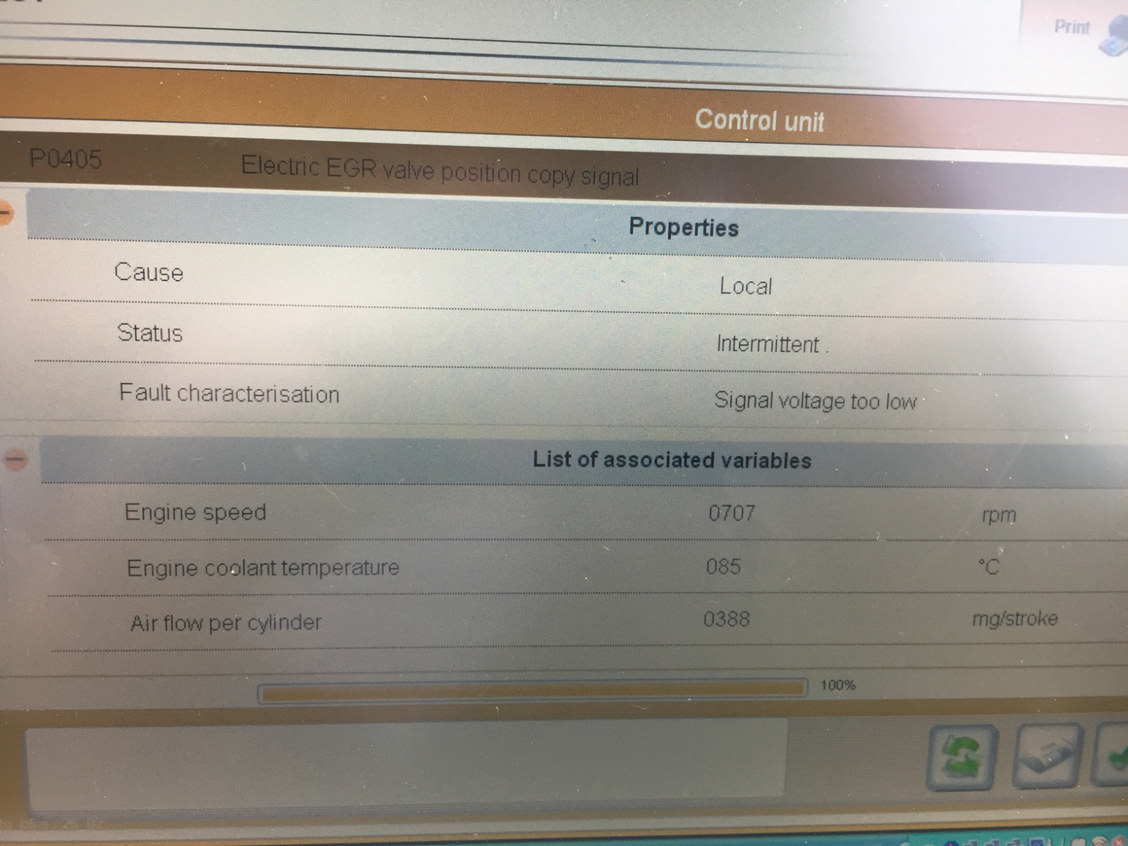

Re: New fault code P0405 help please
The ECU is reporting that the voltage for the EGR copy position signal is too low. So if you read the parameters with Diagbox, I suspect that whilst this fault is active it will show the EGR OCR as 0% and also the copy position as 0% as it says in the post. So you need to check the supply voltage to the EGR (which is a shared 5V supply) from the engine ECU.

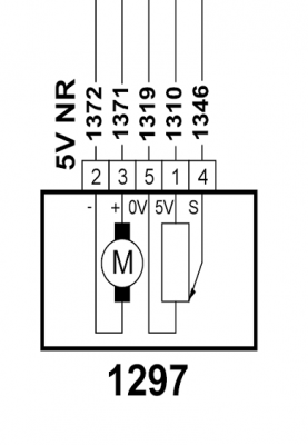

Ok, so basically this is telling you that the there is an under-voltage situation with the EGR Sensor.
Here is the internals of the EGR Key
Here is an enlargement of the EGR solenoid connector The engine ECU supplies voltage to the EGR solenoid valve potentiometer on pins (5) & (1). The otor is supplied by pins (2) & (3), and the copy position sensor is on pin (4).
Pin (1) 1310: "EGR" solenoid valve potentiometer supply
Pin (2) 1372: Throttle motor command by -
Pin (3) 1371: Throttle motor command by +
Pin (4) 1346: Exhaust gas recycling solenoid valve repeat sensor signal
Pin (5) 1319: EGR solenoid valve potentiometer earth
Below is the larger diagram on which you can see the 5 pin Black EGR connector (1297) with the wiring connections I have mentioned above. The engine ECU is shown as 1320. Connections from the EGR plug (1297) go to 2 different connectors on the engine ECU: Pins (5) and (4) go to the 32 Pin Grey Socket and Pins (1), (2) & (3) go to the 48 Pin Brown connector.
So I would get your auto electrician to test the circuits accordingly - and also check that the actual pins in the sockets have not retracted and are making good contact. Check for shorts in the plugs and or on the wiring between the EGR wiring plug and the 2 plugs of the engine ECU that these connections go to.

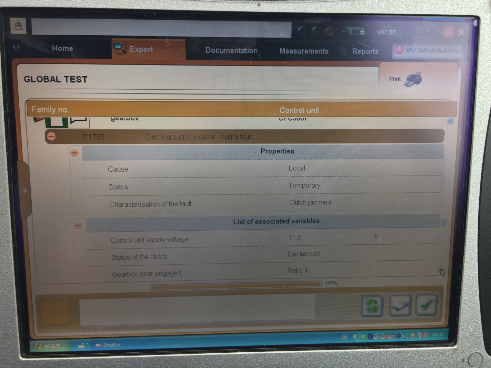

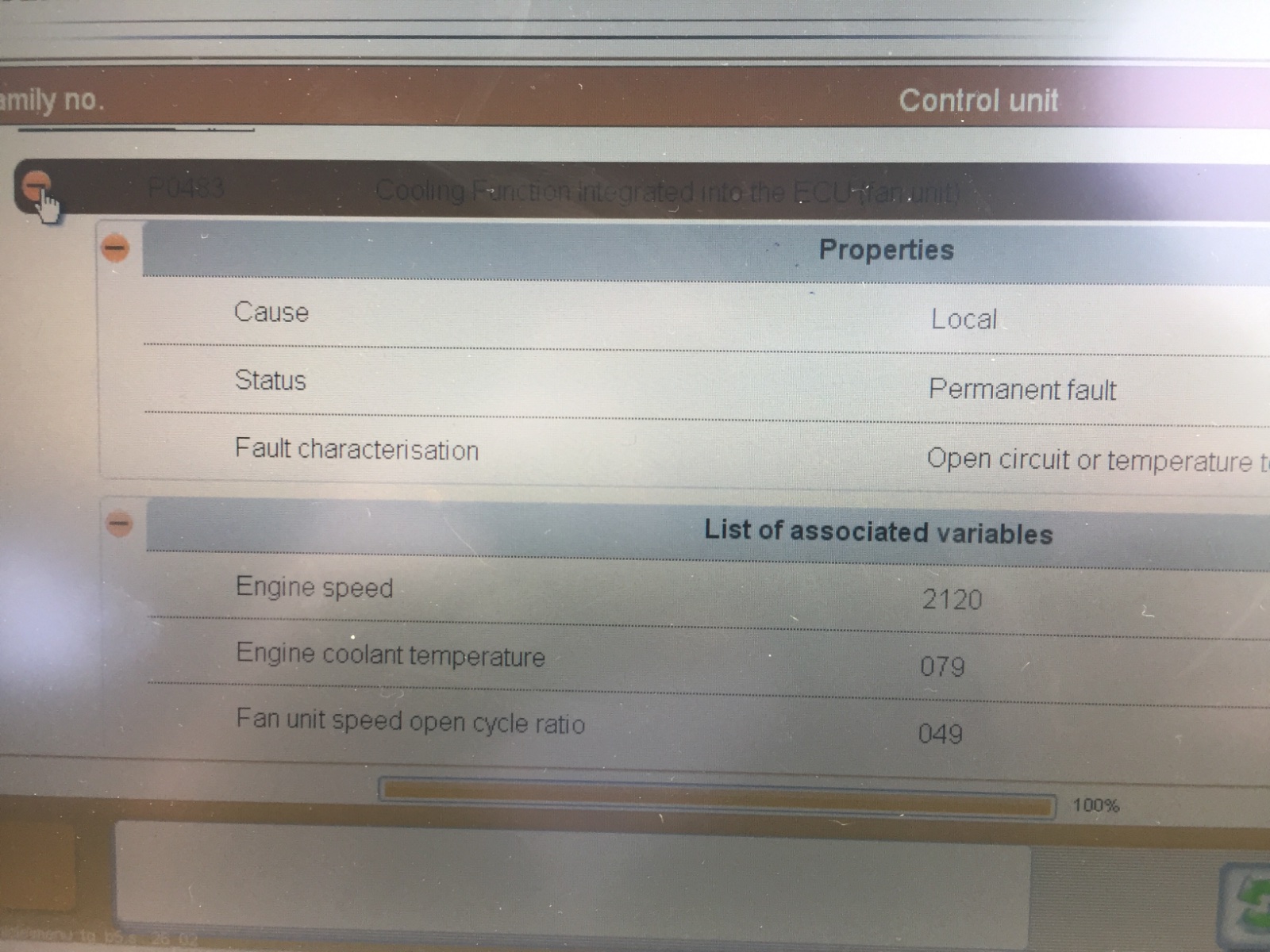

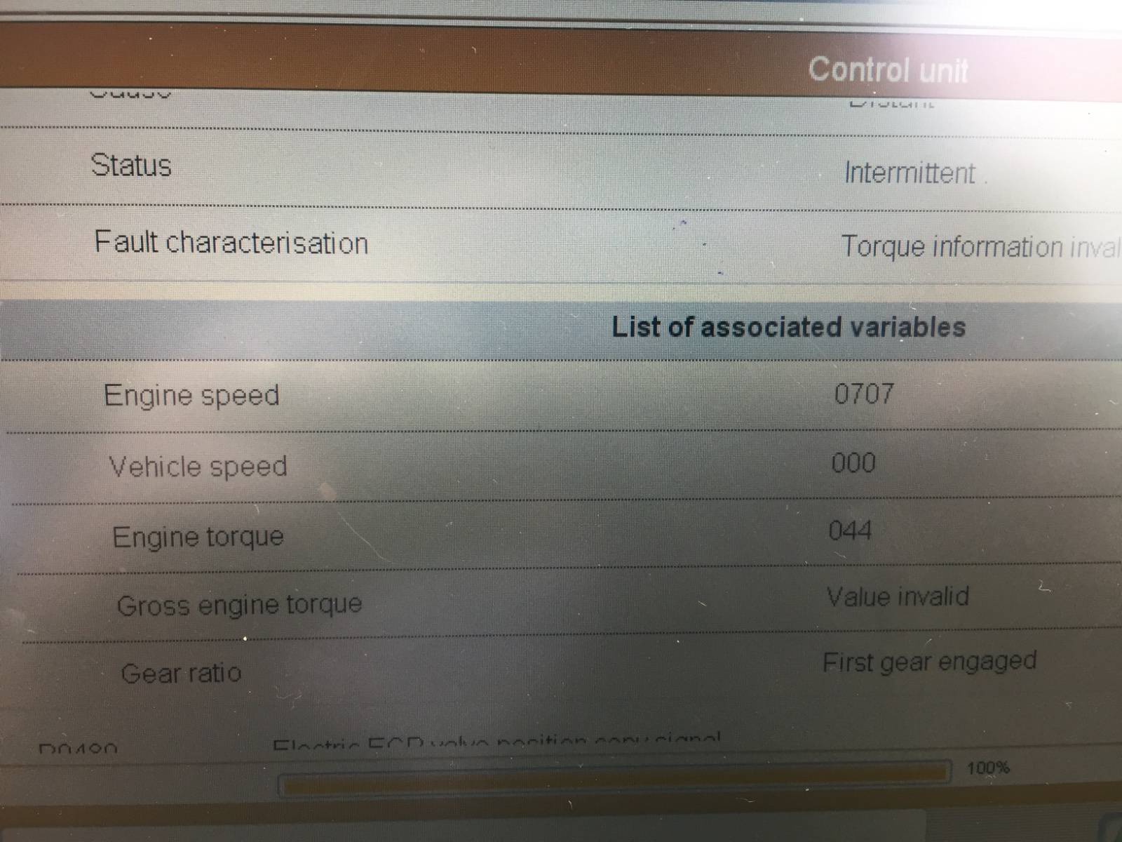

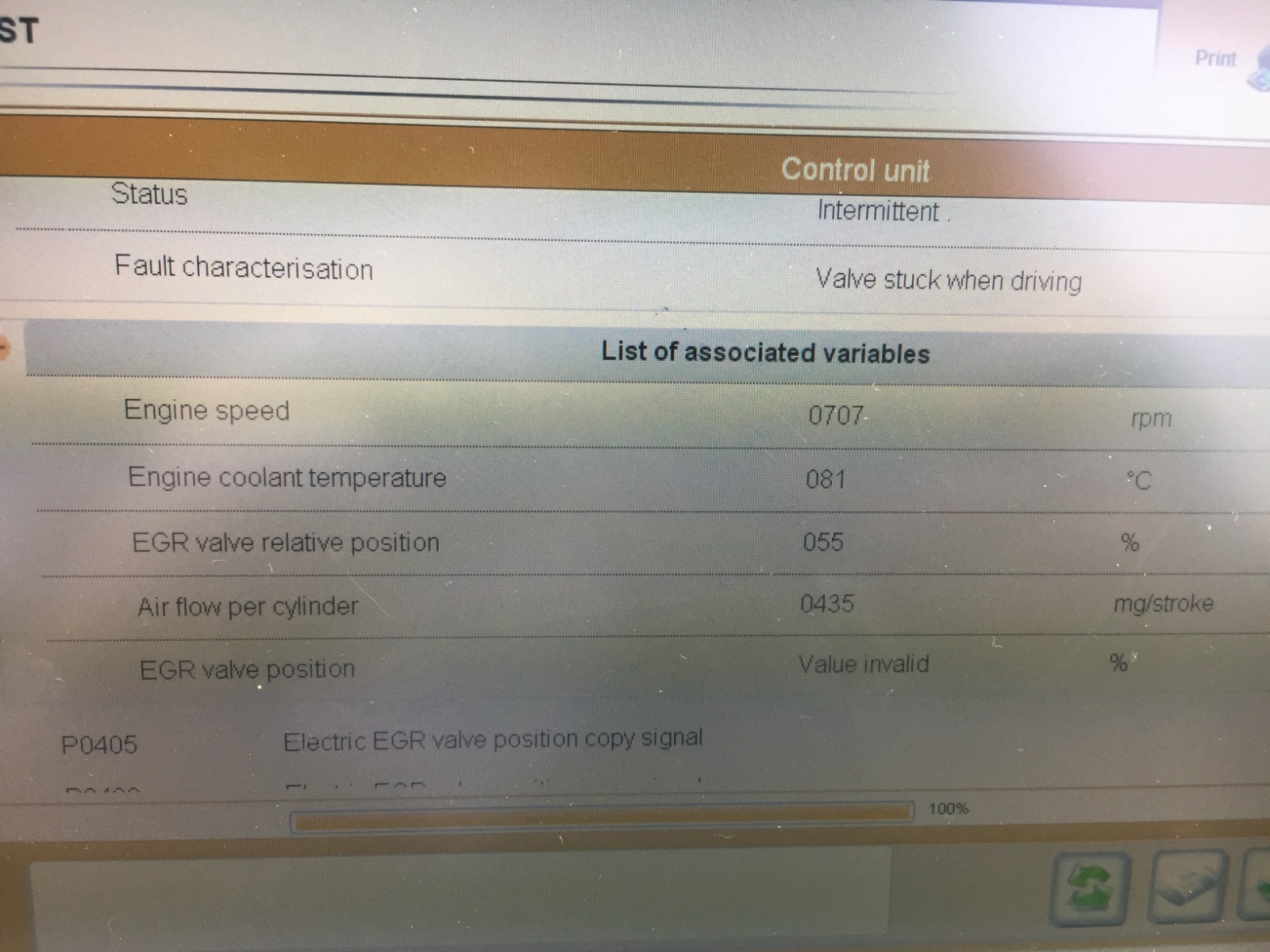

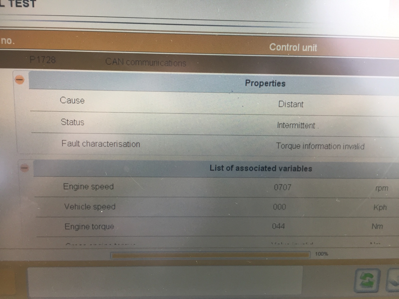

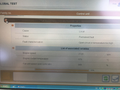

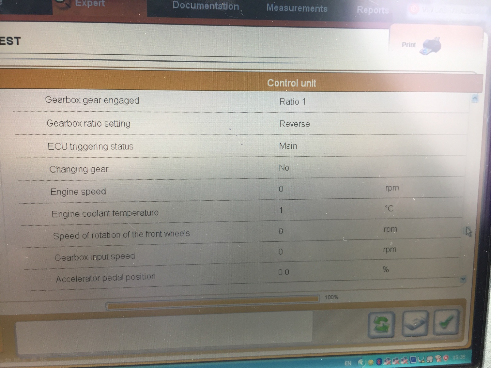

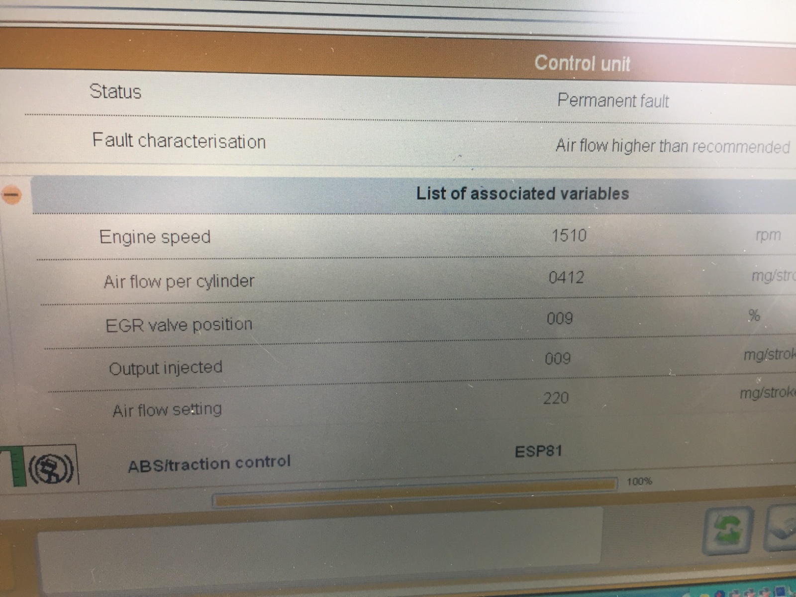

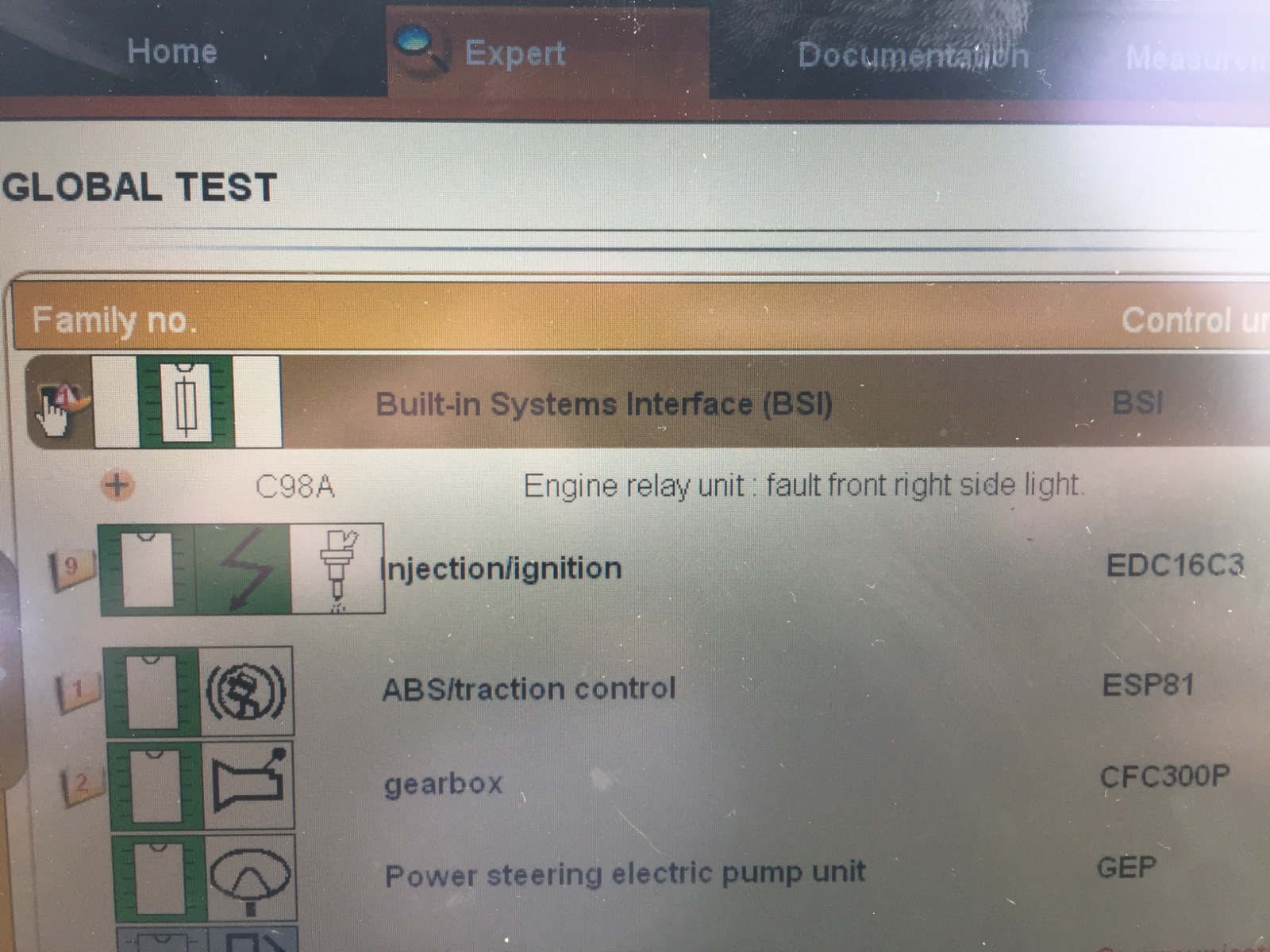

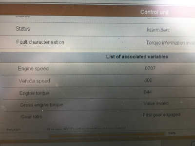

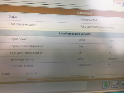

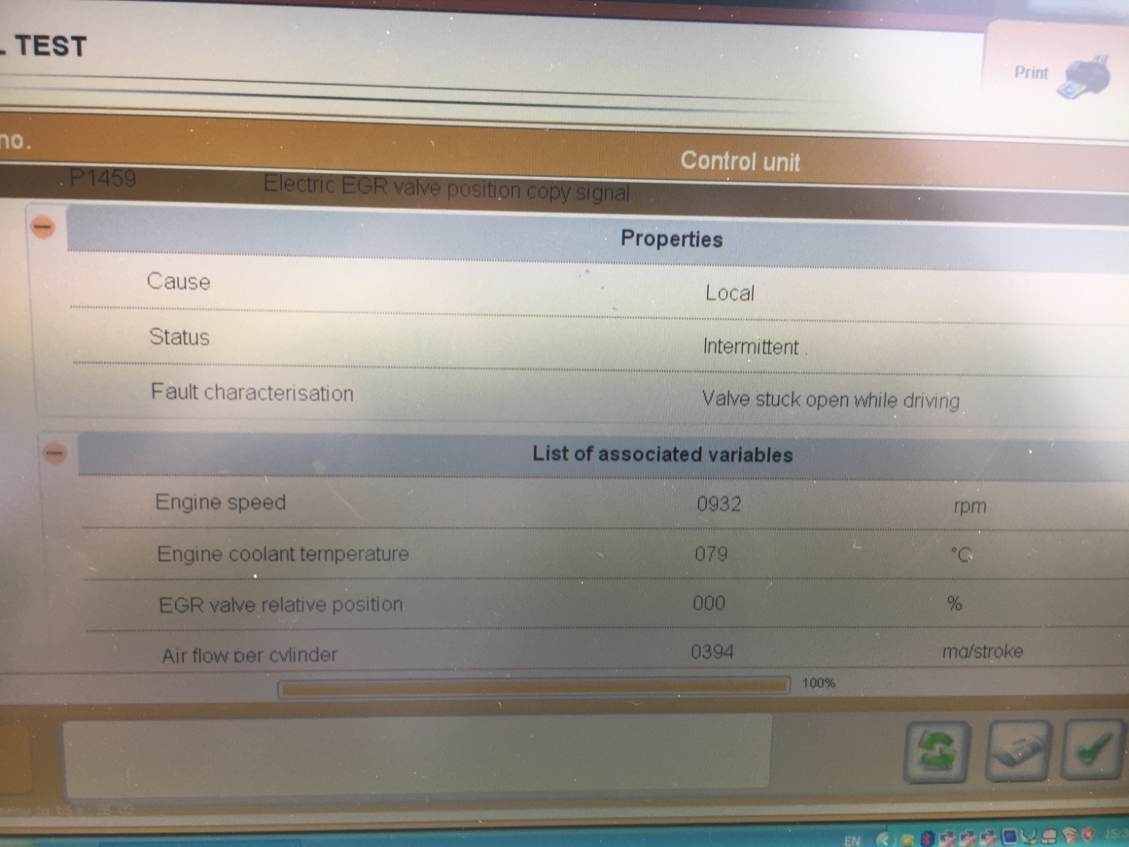

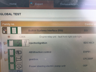

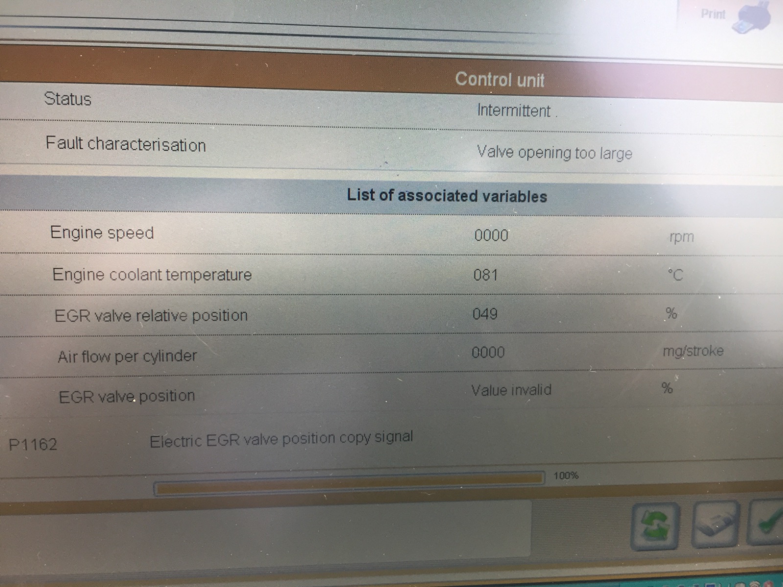

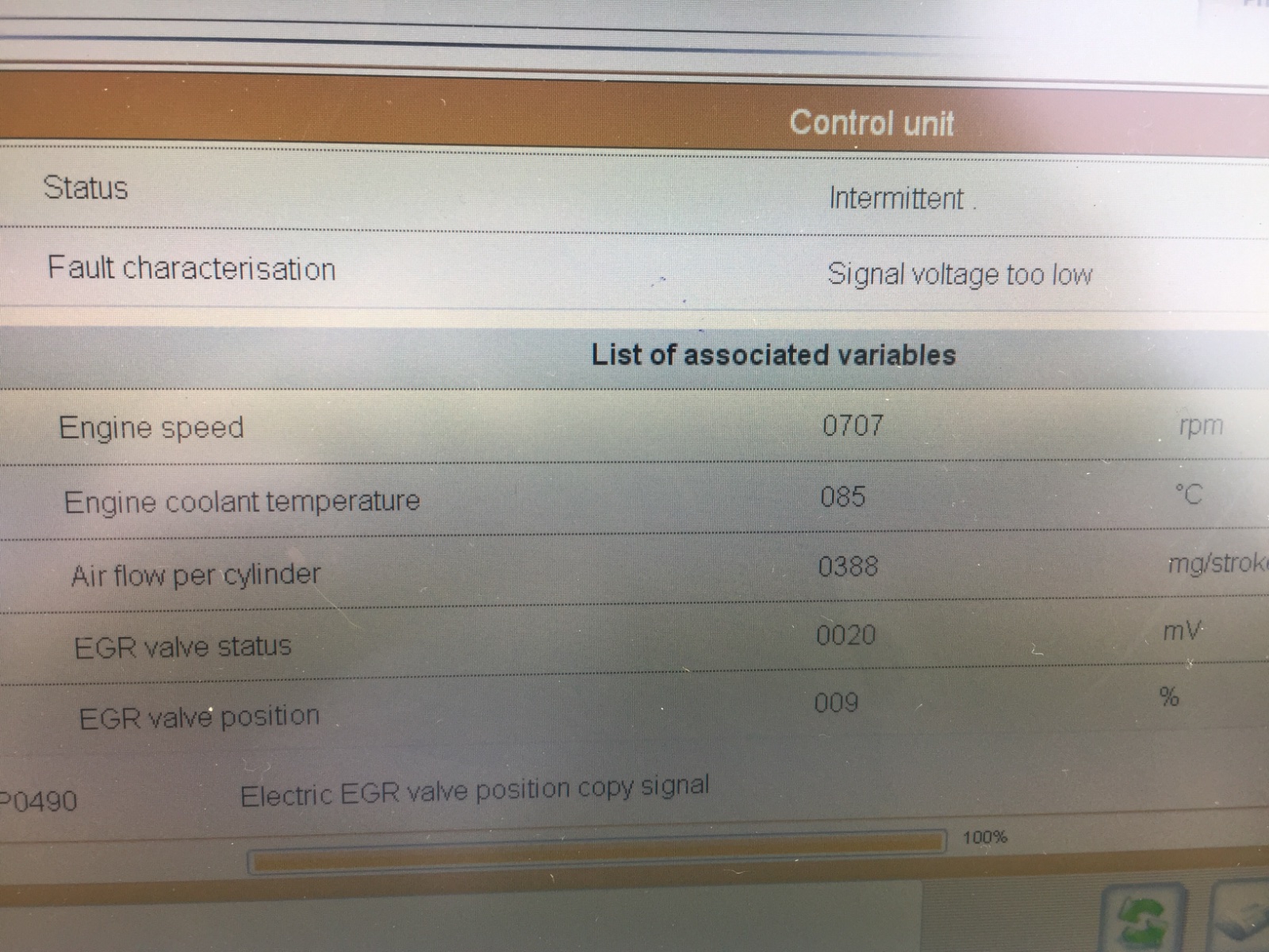

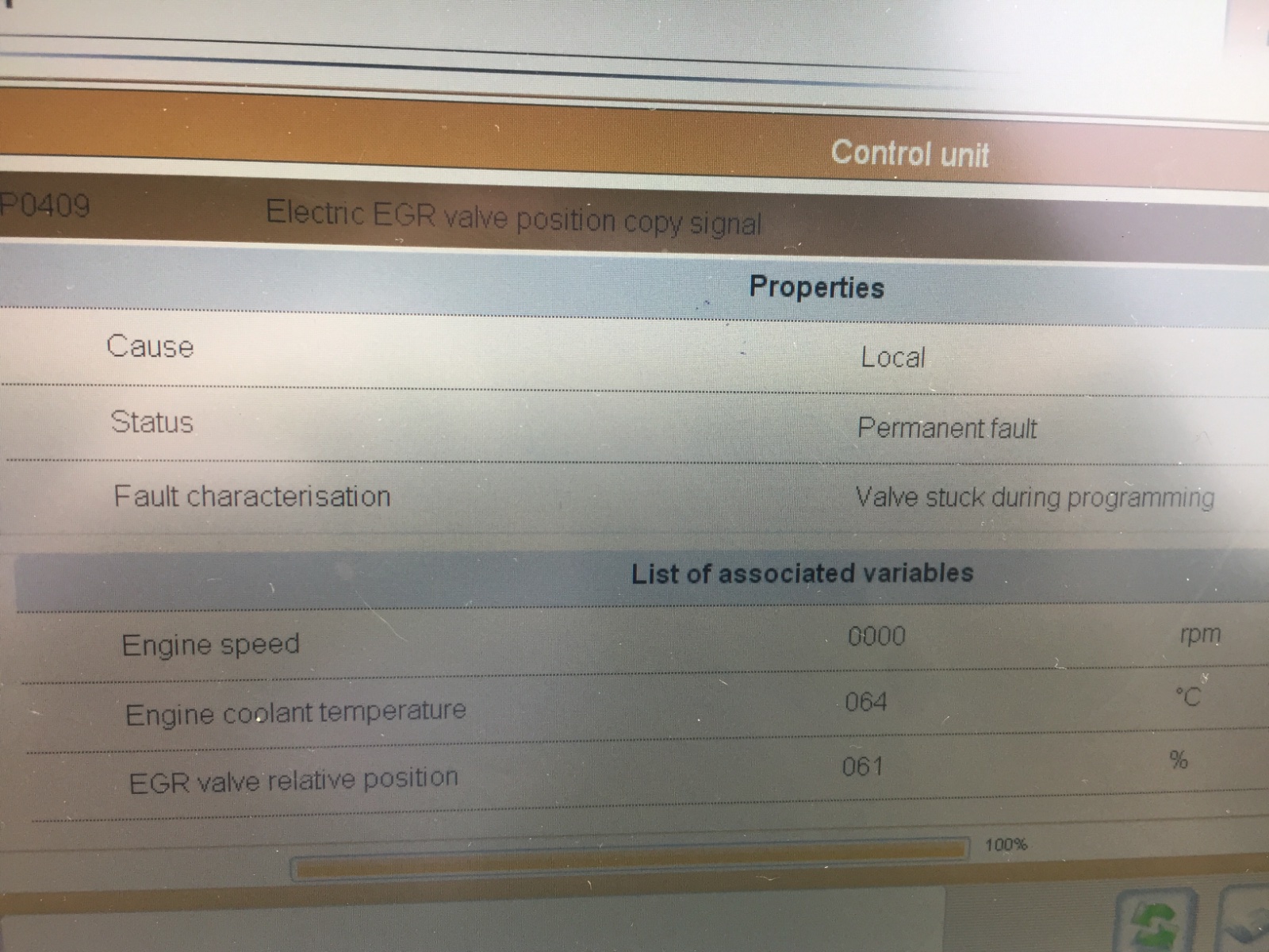

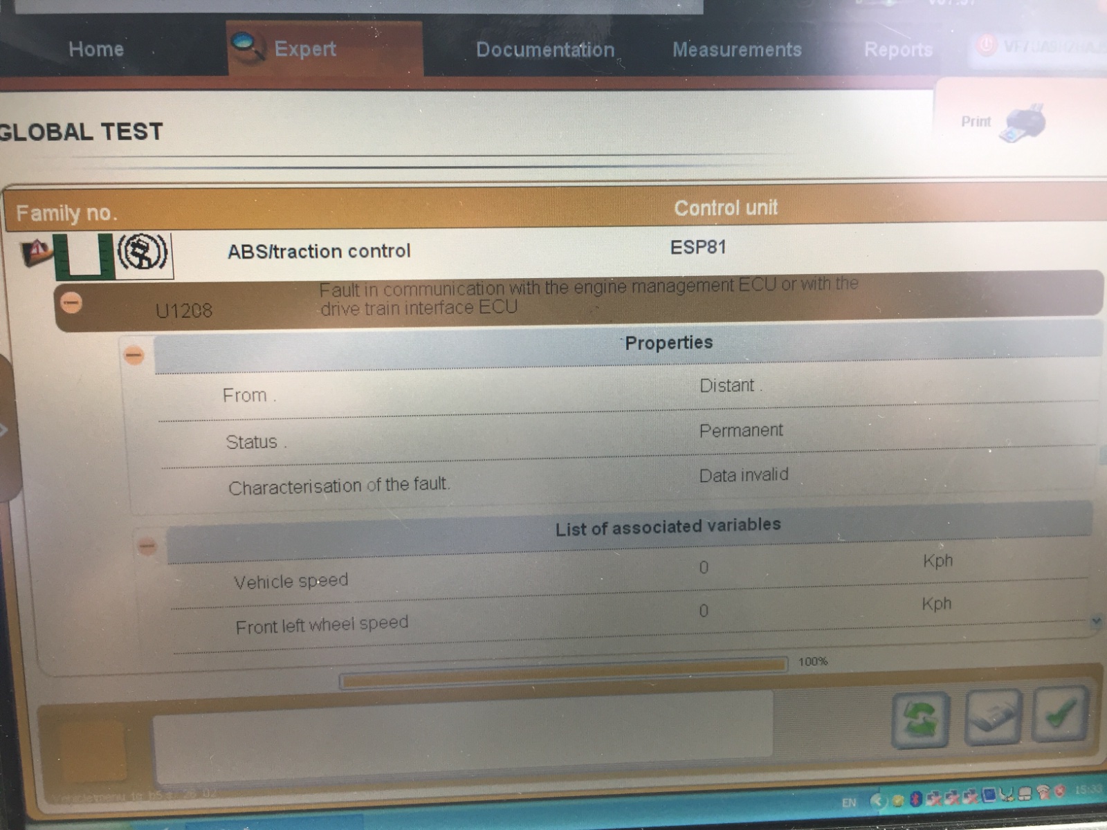

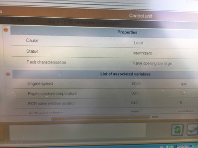

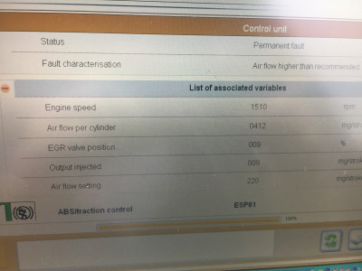

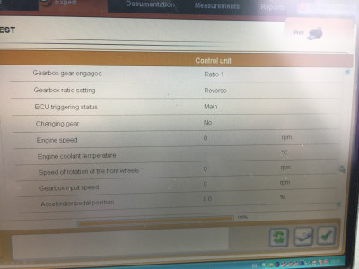

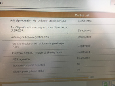

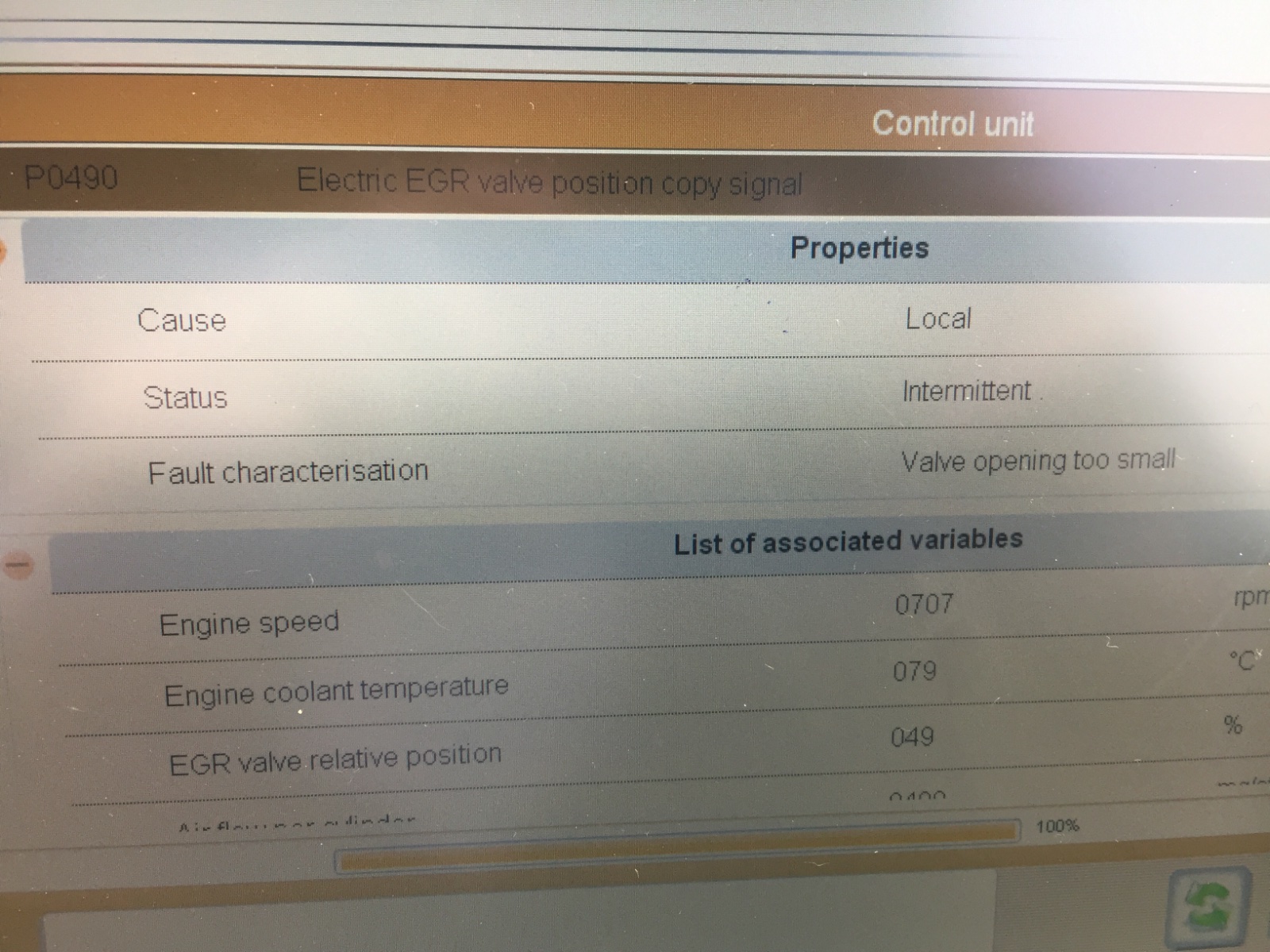

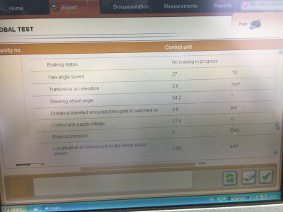

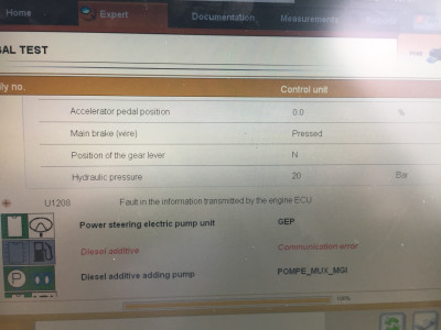

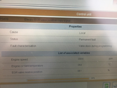

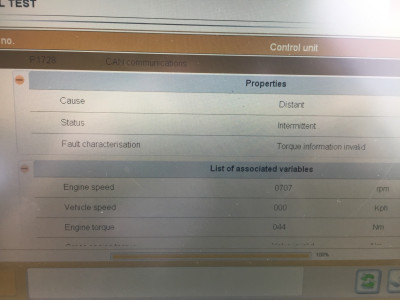

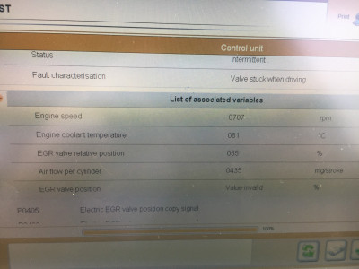

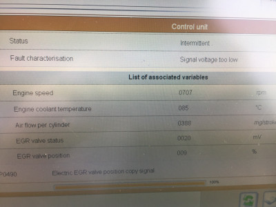

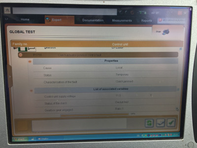

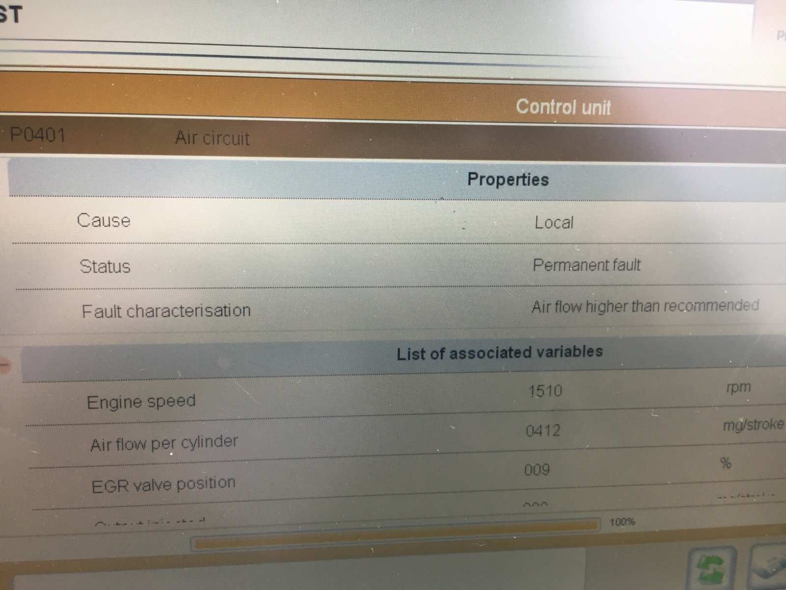

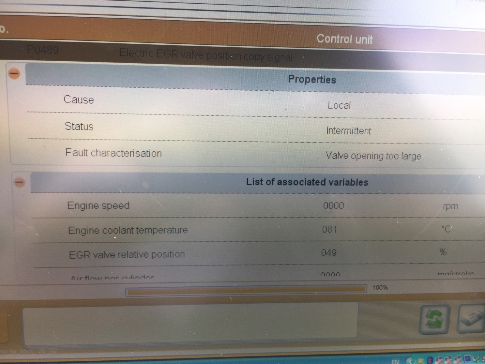

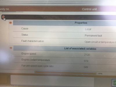

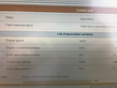

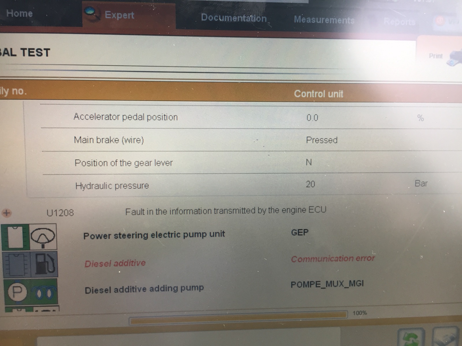

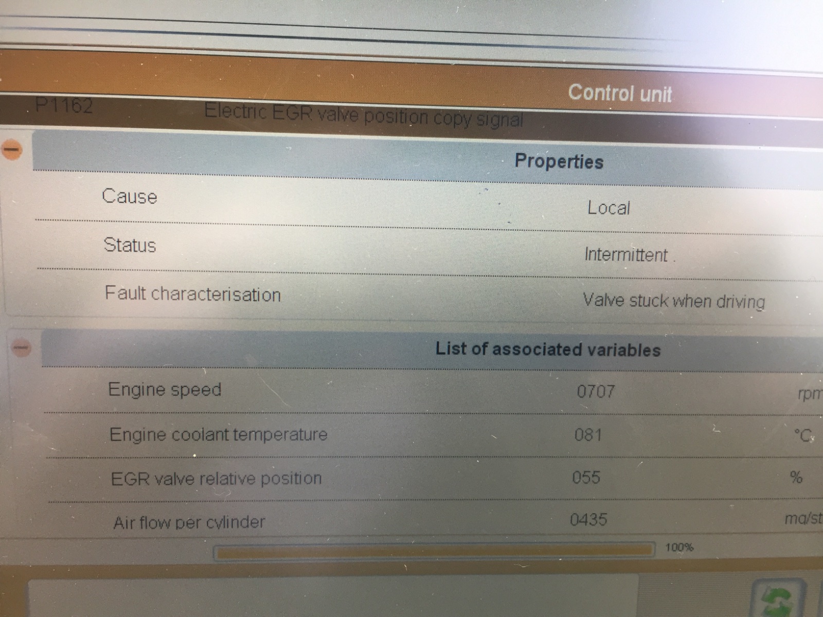

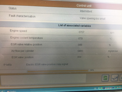

So, plugged the car into diagbox and here’s the results (not a bloody clue what any of it means by the way apart from The sidelight bulb).
Looks like the pics have loaded in reverse order so best to start from the bottom
- x 6956
Not being funny or anything, but not much of that is going to help unfortunately as from the last picture you would seem to have 9 engine ECU faults - and the rest of the screenshots are not very helpful as some of these are missing the fault code, so we don't know to which of the 9 faults they relate to... I can just about make out a few codes....
A list of the 9 engine ECU individual fault codes would suffice initially so we can see what they all are.
Ditto for the 2 gearbox faults and the ABS fault.
It would seem you have a few issues going on here...
It's not unknown on these C4 Picassos for the dense wiring loom to the left and under the engine fuse box to have a few broken wires as a result of the weight and tightness of the wiring bundle causing strain on some of the thin wires. I can't say this is what has happened in your case, but it is a possibility with so many problems.
I'll try and dig a video I saw of this issue and post it up.
On looking further I can see make out the following faults codes, so will put these up in a while, apart from the P0405 that I've already done for you in my last post.
There seem be a few duplicates there. Valve stuck, open too far etc. Note the codes on a piece of paper along with a brief description (see my post previously linked), delete all faults then rescan. See what comes back. If you click on the injector ecu it will bring up another menu, from there you can do an 'actuator test'. Electric EGR along with 'throttle egr' will be listed. Click on those and see if you can hear a clicking. If not check 5v to the egr pin Marc listed (ignition on, engine off). That will tell you if power is getting to the valve, if nothing is happening after that, look at the valve. Much of this was mentioned in my post.
