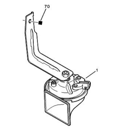

Re: 2005 Dispatch horn
I can't tell you exactly where it is, but this is what it should look like for your vehicle:

GiveMeABreak - the horn I can see looks pretty much identical to the pic you posted
