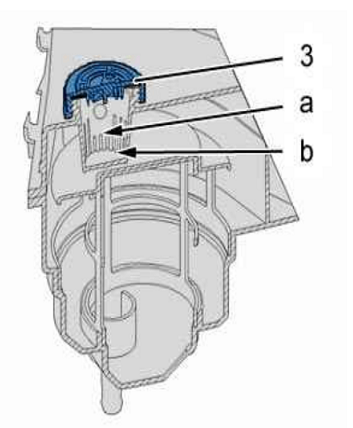

If the pump is constantly running, then there is likely either more air in the system and the pump isn't getting enough fluid or another issue. Do another check on the LOWEST suspension setting.
Now you have it working, raise to highest position, then lowest, then turn wheel lock to lock very slowly a few times. Switch off engine and check LDS level is between the marks shown previously. Top up if necessary. A lot of 'fizzing' of tiny air bubbles means there is air in the system.
Repeat the procedure several times until it settles down. The pump should not be operating continuously when the car is at normal height setting.

Fluid should be between 'a' & 'b' on the lowest suspension setting.
