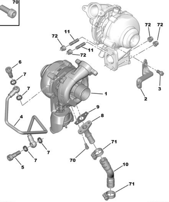

Looks tricky, You ever done it? take long to swap them out, and if i am swapping them out what all "new parts" would i require?
Any thing that i might not have to remove to swap over turbo?

Just make sure you replace all the seals and parts as stated in the procedure.
Copper Gaskets for the Turbo Banjo Bolt - Citroen Part: 015708
Any other part numbers you need from the diagram below, let me know the numbers:
