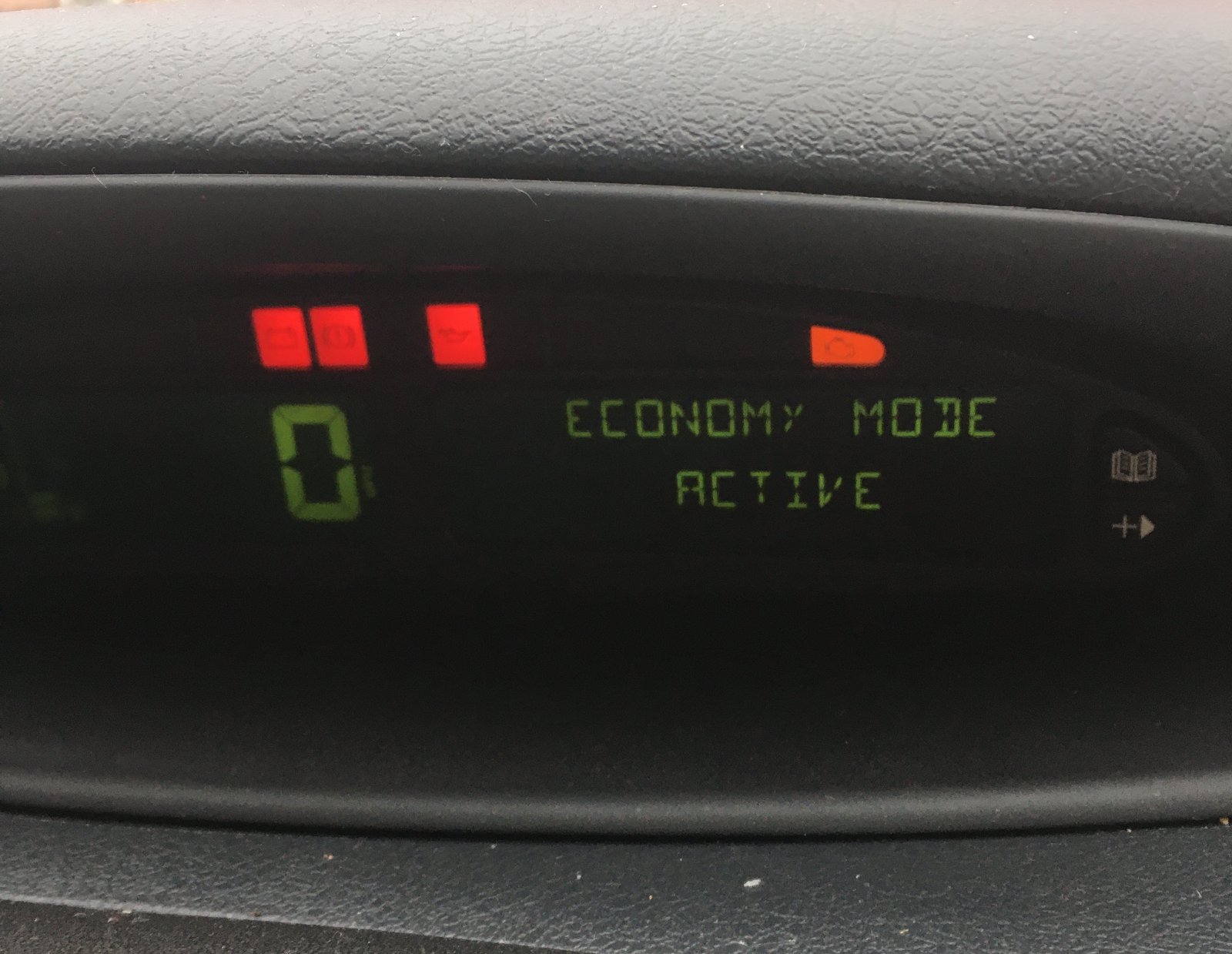

I tested the battery and the voltage was dreadful, it was dropping to 9 volts when trying to turn the engine. It did recover to 11.5 volts but that was it. I took it to a car spares shop and it failed with a shunt test.
Sadly, I fitted the new battery, followed the instructions, and still, nothing happened. I am seeing "Economy Mode Active" and have attached an image. I apologise for the poor quality. I have a video too, but I am not sure if I can upload directly to the forum?

Ok, so looking at that you have the engine management light on. The next step is getting it diagnosed (preferably with Lexia) to help determine what the engine management is not happy about. Without a diagnostic this will be pure guesswork. As you've replaced the battery, followed the 'Battery Connect Reset Procedure', resynched the fobs and there is no immobiliser fault showing, this needs to be the next step, as you've eliminated the easiest things to check.
