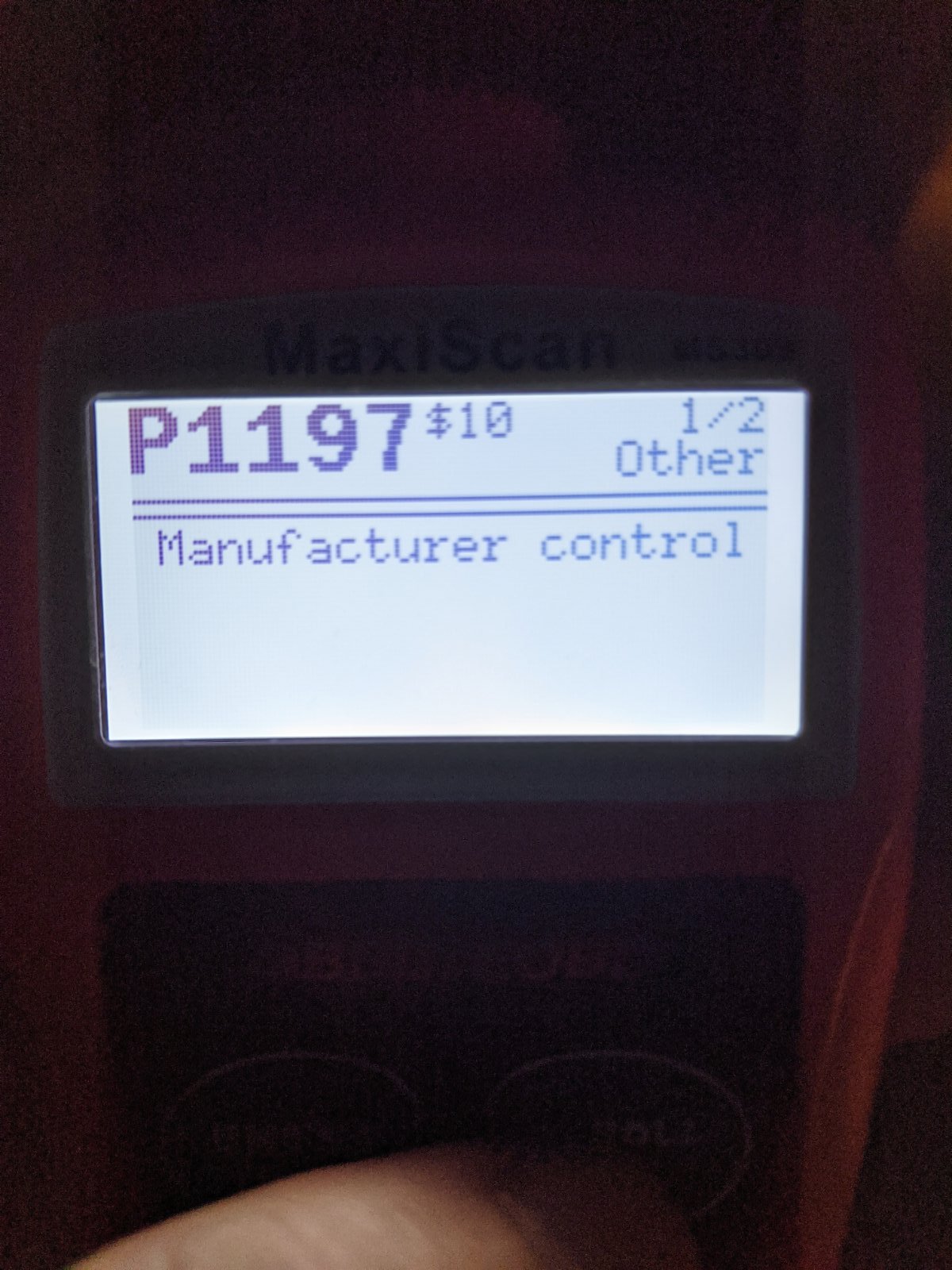

Re: Citroen berlingo 2.0 hdi possible fuel pump issue or electrical
Hope this helps?
Callum - put your VIN up so I can tie these codes into the specific engine management system you have.
