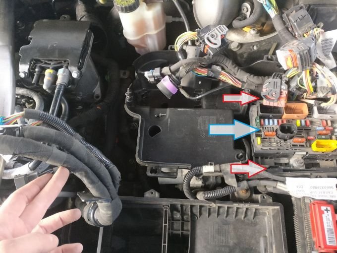

hi, my c5 2006 has a suddenly non working hydraulic pump. i think the fuse in in fuse box b- where exactly is that. obviously if it has blown, theres a reason, but at the minute the cars almost on the ground. help

The MAXI fuses are under the fuse box on a sceond "layer".
Mostly the pumps blow due to a build up of carbon crud inside and short. The pumps can be switched and the original ECU switched over. (have it cleaned and re-brushed before fitting it ?)

you wouldnt have a ;ink to a picture of where they are.most references point at internally

Similar to this in the C6
Two clips under the C6 top layer...not sure on the C5
