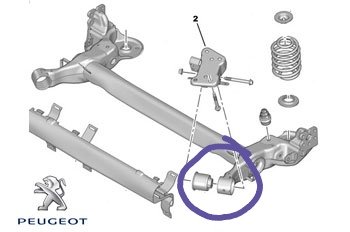

Re: 207 mounting bush (pivot bush)
Ah, yes! My bad, the rear axle mounting bushes.
The ones that attcach the trailing arm/axle beam to the mount.
These ones
These ones

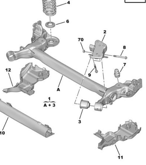

- Posts: 12603
- x 1493
Item 3? Not in English... (it's a 307, but it's basically the same)
[Video No Longer Available]
the OS you need to remove the mount from the car as the through bolt fouls the tank. Note that you need to mark the mount on the car before dropping it so it goes back in the same place - there are officially pins to locate it, I have heard of it being done with AA batteries wrapped in Gaffa Tape....
Peugeot 307 are the same then eh? handy to know...
and yes, item 3, both sides i will be doing. what part am i supposed to be marking the mount with the 4 bolts holding it to the chassis? is this just to help relocate it or is it to do with wheel alignment etc?
i had a quick look at the job today, gonna need to cut out the bolt that goes though the bush anyway as that seems to be sized within the bush and what not. so hopefully wont foul the tank if its going to be cut.
whats the tool hes using called? or can it be done with another type of tool?
- Posts: 12603
- x 1493
I expect there's a proper tool for the job, but AFAIK the bush is not that tight, so a bolt / length of bar and a few spaces / sockets should do the trick to pull it in.
The mount with the 4 bolts has slots, and the position of the bracket affects the wheel positioning - I would imagine that 3 or 4 marks with paint will ensure you get it back where it was (there might even be a sufficient witness mark on the car body itself).
