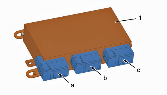

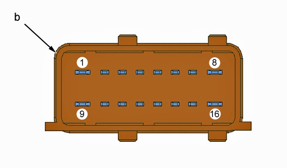

So here are the pin outs for the Audio Amp as they relate to the RT4 in the C5 X7:
Connectors
(1) Audio amplifier.
"a" 16-way black connector.
"b" 16-way white connector.
"c" 16-way blue connector .
Role
The audio amplifier amplifies the 4 audio outputs of the audio system/audio-navigation and divides them into 8 amplified outputs:
2 outputs for the front woofers
2 outputs for the front tweeters
2 outputs for the rear tweeters and woofers connected in parallel
2 outputs for the bass acoustic enclosure
Electrical Features
The connection to the audio amplifier is by means of 3 connectors (The 3 connectors are of the SICMA 16-way type):
Connectors
Role
Electrical Features
- The black connector transmits the low power information and the supplies
- The blue connector transmits the power information to the right-hand speakers
- The white connector transmits the power information to the left-hand speakers
| Connector 'a' | Connector 'b' | ||||||||||||||||||||||||||||||||||||||||||||||||||||||||||||||||||||
| Connector 'C' | ||||||||||||||||||||||||||||||||||

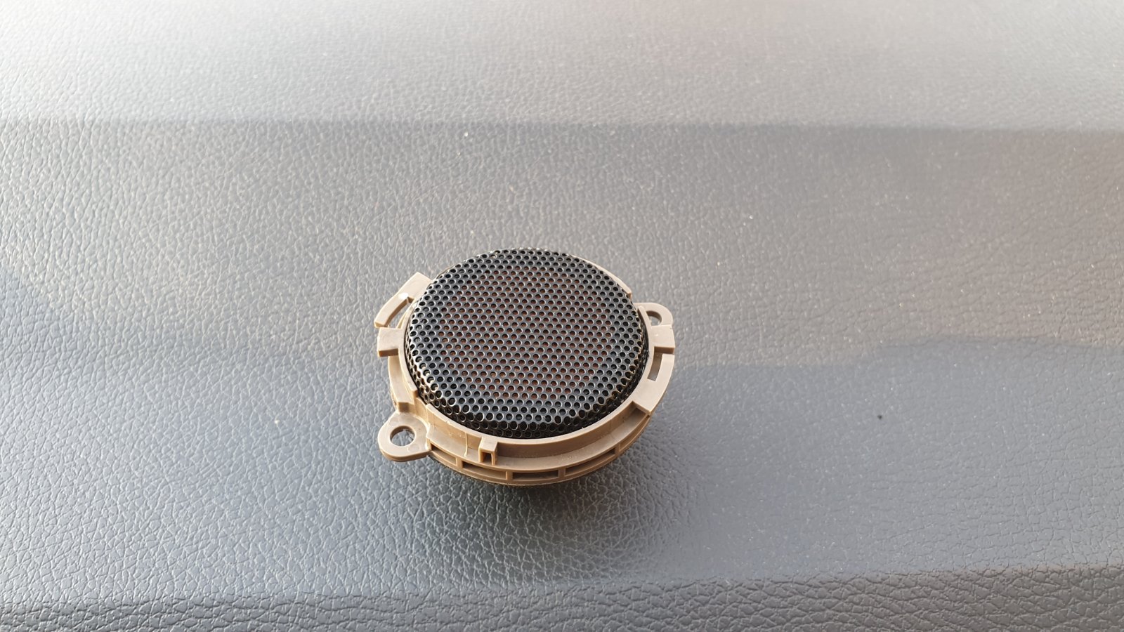

Again I want to mention that my head unit is not RT4, is RT3eV. I have attached 2 pictures with the HU.

I like a challenge, but I don't want to have different problems in the future.. If only I knew that before I bought the system...
I do have another question though: I've tested the 4 door speakers (woofers) on my system and they work fine, but each tweeter from this setup (Philips HIFI System tweeters) is heard very dim (you can almost not hear them at all). At first I thought that the first tweeter had a problem, then the second, and the third and the fourth. I thought that they don't work proper because the signal is not coming from the amplifier, hence the need and desire to install the factory amp...
I can not find any technical information about the speakers and the tweeters. No power output, ohms and so on...
- x 6946
Re: C5 X7 RT4 - Fitting Factory Amplifier
There are a different set of speakers for systems with the Hi-Fi option and the wiring that goes to them from the amp is specific, so they won't get powered properly from a normal system without the amp or the amp wiring to the speakers.
That's why is's such a job and often requires re-wiring all the speakers and tearing the car up to do it
