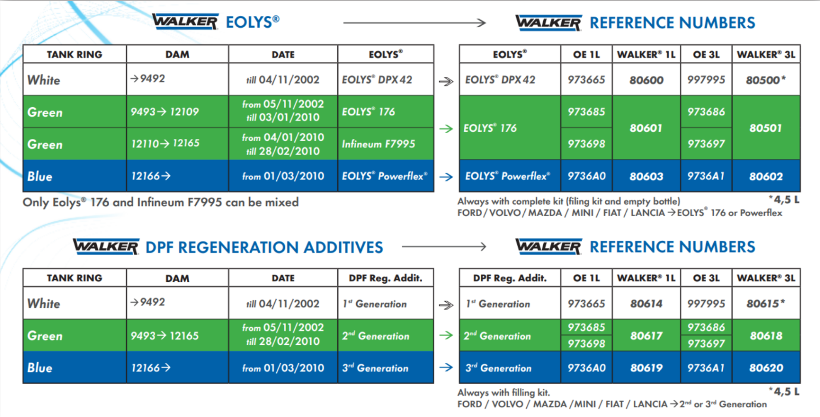

cornesoutafrica wrote: 22 Dec 2019, 20:00 Hi Marc.
A question. The correct Eolys fluid. If I remember there correctly. There are a few different versions? What type do I need to get?
Hi Corne. Your build date is 11097 and your have a Euro 4 engine, so you need Eolys 176 or Infineum F7995.
You should have a green click fit connector.

Hi Marc
I believe I do have the green connector.
Does this fluid look like the correct type? Just did a quick search.

That looks fine Corne.
