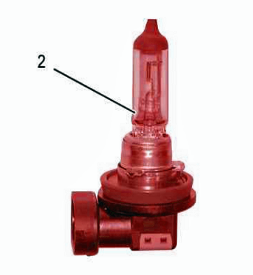

Use some trim removal tools (with flat plastic edges) to remove the areas shown at 'a' by inserting the flat tool and levering down to unclip the tabs. Do the top or bottom first and lever a little at a time as you go along - this should make it easier.
Then undo the 2 bolts:
Then turn the assembly a quarter of a turn in the direction of the arrow:
Note: The bulb does not detach from the plastic holder - replace the whole thing:

Even wiht a tools for trim removal I am unable to remove covers.....I don't wan't to break anything. Even to insert a tool between bumper and cover is a task...

Would a feeler gauge slide in?

Just push a plastic flat bladed tool in the locations arrowed so you can lever either the top of the bottom side off first, then one of the sides and the rest should be easy.

Thank you all guys. Just finished. Still managed to break one clip... In my opinion this cover removal could be designed a bit easier.
