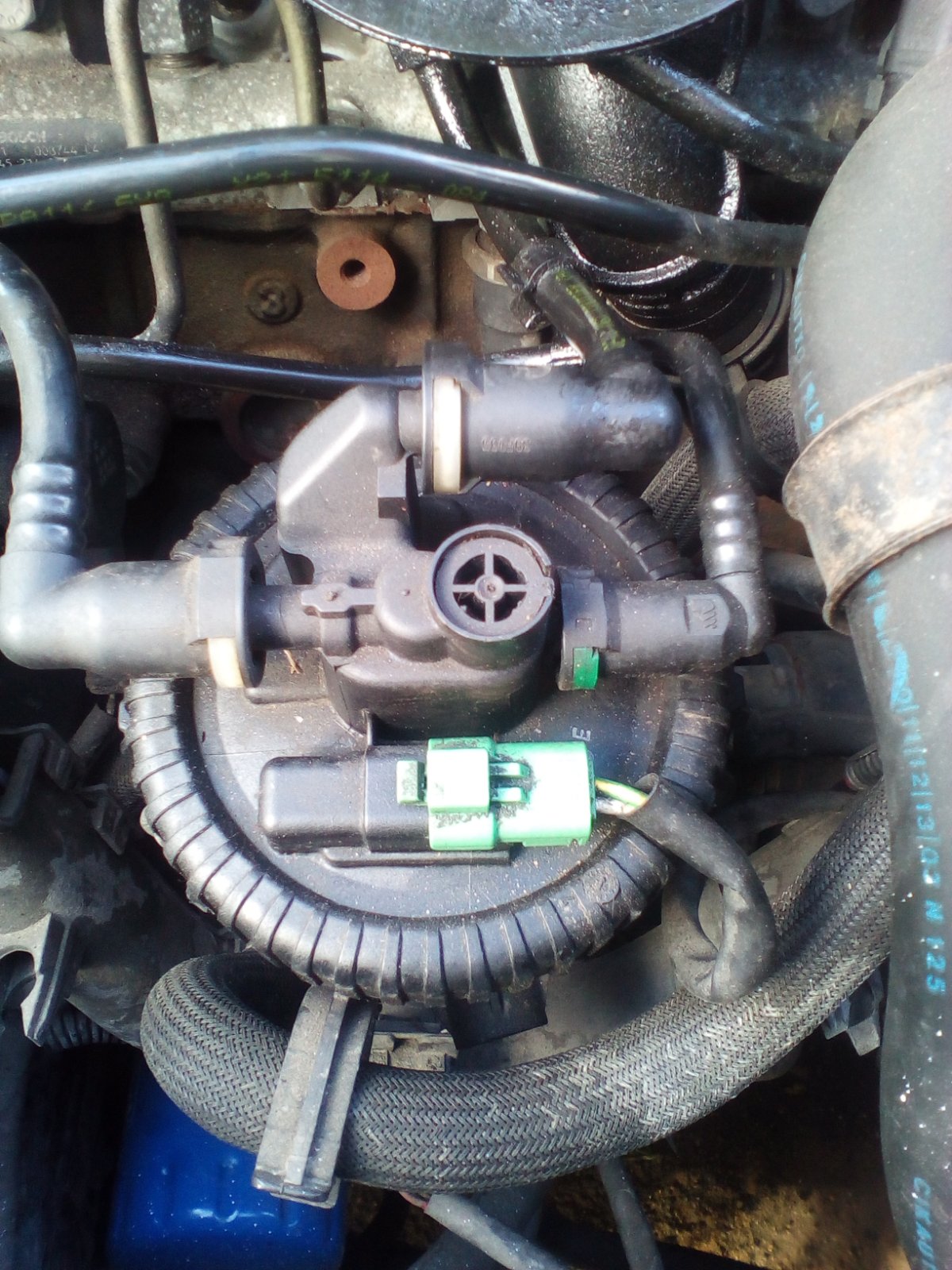

Anyone know how to undo this filter housing ?
Husky.
Onlinemyglaren
- Posts: 28631
- x 5646
Re: Picasso possible next car
I find mine a real pain.
Disconnect all the hoses - push the coloured clip in and pull - carefully, some have a tight grip.
The retaining ring can also be very tight. I use oil filter pliers to remove and replace mine.
I hate doing it and the new fuel filter is still in the boot after the last service I did, back in August.
Filter is always clean anyway
Car not long before recycling as bean tins too.
