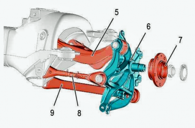

The C5 X7 is nothing like the previous C5 suspension. It is more akin to the C6, having a multi-link setup.
(5) Suspension upper arm.
(6) Rear pivot.
(7) Hub/bearing.
(8) Tracking adjustment rod.
(9) Lower suspension arm.
So to answer your question, yes, there is rear tracking at the axle:
ReferenceDesignationTightening torque
(1)Bolt - Nut (Tracking adjustment rod / Crossmember) (*)7,5 daNm
(2)Adjustment locking screw on tracking adjustment rod1 daNm
(3)Bolt (Tracking adjustment rod / Pivot) (*)7 daNm
Rear Camber: Not adjustable
Thrust Angle: 0° ± 0°30'
Tracking at the Axle: Adjustable, 0°34 ± 0°09'

Hmmmmm. Very interesting. 🤔
Thanks for that. I think I need to look at these links to see if they are rusted solid, and if necessary free them up.
Next step will be to try and find a local tyre company that has the ability to actually set the tracking on the rear wheels. 🤦???🤦???🤦???🤦???🤦???
The bit that has me puzzled is that they both appear to be out of kilter by exactly the same amount.
Possibly incorrectly set by a previous attempt at alignment perhaps.
