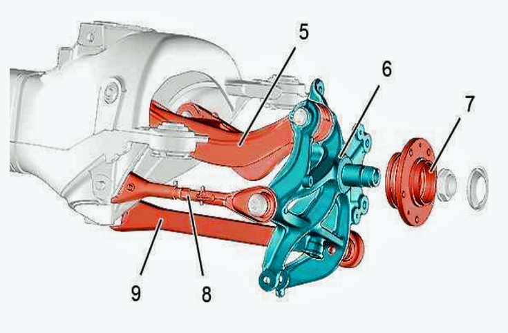

The C5 X7 is nothing like the previous C5 suspension. It is more akin to the C6, having a multi-link setup.
(5) Suspension upper arm.
(6) Rear pivot.
(7) Hub/bearing.
(8) Tracking adjustment rod.
(9) Lower suspension arm.
So to answer your question, yes, there is rear tracking at the axle:
Rear Camber: Not adjustable
Thrust Angle: 0° ± 0°30'
Tracking at the Axle: Adjustable, 0°34 ± 0°09'

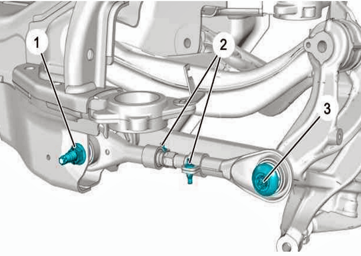

Reference | Designation | Tightening torque |
(1) | Bolt - Nut (Tracking adjustment rod / Crossmember) (*) | 7,5 daNm |
(2) | Adjustment locking screw on tracking adjustment rod | 1 daNm |
(3) | Bolt (Tracking adjustment rod / Pivot) (*) | 7 daNm |

Re: Rear tyre wear.
Hmmmmm. Very interesting.
Thanks for that. I think I need to look at these links to see if they are rusted solid, and if necessary free them up.
Next step will be to try and find a local tyre company that has the ability to actually set the tracking on the rear wheels.
The bit that has me puzzled is that they both appear to be out of kilter by exactly the same amount.
Possibly incorrectly set by a previous attempt at alignment perhaps.

Re: Rear tyre wear.
I would use some Plus Gas on the threads, so if they need to be adjusted they should be able to be done with little effort.
