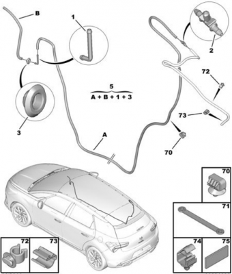

1) When you operate the rear wash / wipe do you hear a noise from the pump? If you do, then it's likely a blocked or kinked pipe somewhere. The somewhere is probably why they are quoting as much - as they'll need to trace where the blockage is.
Routing to the rear:
