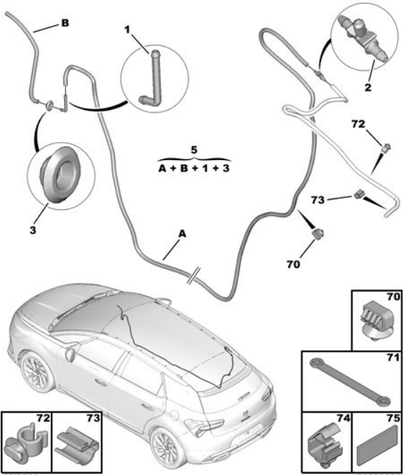

No it doesn't - it's a reversible pump unit, but there are several variations depending on options. There's the reservoir about £66 and the pump unit about £50 - but depends on your specific vehicle. I can tell you which, when you provide the VIN - however, very rare for these to go.
1) When you operate the rear wash / wipe do you hear a noise from the pump? If you do, then it's likely a blocked or kinked pipe somewhere. The somewhere is probably why they are quoting as much - as they'll need to trace where the blockage is.
Routing to the rear:
