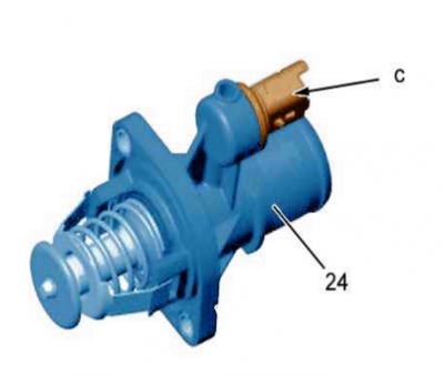

Here's some info on the system incorporated into the TU3AE5 engine, which uses a piloted thermostat Colin.
Its role is to accelerate the engine temperature increase in order to improve the exhaust gas emission control and to obtain a higher engine operating temperature to reduce friction and fuel consumption.
The thermostat is open (whether in piloted or non-piloted mode if the temperature is above 105°C).
During normal operation, the thermostat is not piloted, it regulates the coolant temperature at 105°C.

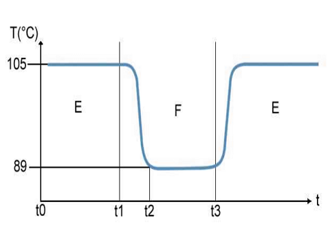

For full engine loads:
The piloted thermostat opening control is determined in relation to the following parameters:

The energy stored by the catalytic converter determines the activation of the cooling fan unit control.
- The injection ECU controls the regulation of the thermostat at 89°C
- The injection ECU controls the piloted thermostat heated resistor (26) in order to add the 16°C which the coolant lacks in order to melt the wax (25)
Time | Operating Phase | Description of the Operating Phase |
t0 and t1 | Partial load | The engine management ECU does not activate the piloted thermostat regulation control. The engine coolant temperature is regulated at 105°C guaranteeing a reduction in consumption |
t1 and t2 | Full load | The engine management ECU detects a full engine load and controls the opening of the piloted thermostat by means of the internal resistor which melts the wax, simulating a temperature of 105°C. The engine coolant temperature decreases and stabilises at a temperature of 89°C |
t2 and t3 | Full load | The engine cooling is regulated at an engine coolant temperature of 89°C in order to avoid an excessively high engine operating temperature |
t3 | Partial load | The engine management ECU detects a partial load and no longer controls the activation of the piloted thermostat internal resistor. The piloted thermostat again regulates the engine coolant temperature of 105°C |

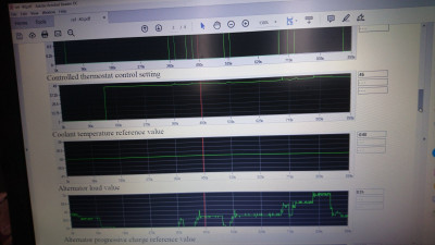

Just a quick update
Tonight it seems that whilst driving the car it sat around the 70 degree mark whilst in heavy stop start traffic and then leaving it running whilst chatting to a friend he says the gauge went up close to 90 degrees.
Any thoughts before i shell out hard earnt cash

Marc do you know the part number for #5 which i think is the coolant temperature sensor if you have a spare 5 minutes.GiveMeABreak wrote: ↑11 Feb 2020, 16:11 Yes, a bleed screw as shown at 3:
This is a Euro 5 standard engine - so they run at higher temps to reduce emissions and get there more quickly.
Thanks Colin

Replacement part: 9636777180 Original is £54.14 from Peugeot Colin inc.
M12 X 150 2 Pin Green.

Really going to need some expert help now.
Have taken it for a test drive and got some live test data which is now concerning me.
The engine temp never got above 63 degrees and gauge was showing correct reading.
Sat in a lay by and revved till engine temp got 80 degrees drove off and engine temp dropped back down to 63
In the first pic it shows the coolant temp reference value as -40 degrees, that was from the previous stationary test.
In the next 2 pics it shows the driven test, and although it shows the reference as 105 degrees in the test this value was -40 not the 105 showing ??
Also the controlled thermostat value is 02 no idea what that means.
Hoping what it means is that the stat is fully open.
