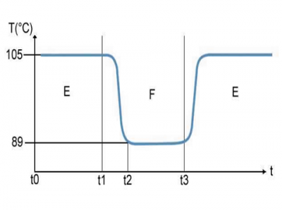

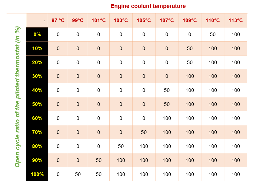

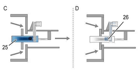

Here's some info on the system incorporated into the TU3AE5 engine, which uses a piloted thermostat Colin.
Its role is to accelerate the engine temperature increase in order to improve the exhaust gas emission control and to obtain a higher engine operating temperature to reduce friction and fuel consumption.

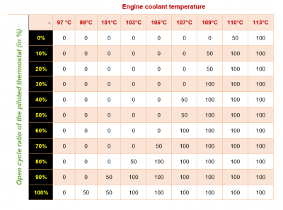

The thermostat is open (whether in piloted or non-piloted mode if the temperature is above 105°C).
During normal operation, the thermostat is not piloted, it regulates the coolant temperature at 105°C.
For full engine loads:
  • The injection ECU controls the regulation of the thermostat at 89°C
  • The injection ECU controls the piloted thermostat heated resistor (26) in order to add the 16°C which the coolant lacks in order to melt the wax (25)
TimeOperating PhaseDescription of the Operating Phase
t0 and t1Partial loadThe engine management ECU does not activate the piloted thermostat regulation control.
The engine coolant temperature is regulated at 105°C guaranteeing a reduction in consumption
t1 and t2Full loadThe engine management ECU detects a full engine load and controls the opening of the piloted thermostat by means of the internal resistor which melts the wax, simulating a temperature of 105°C.
The engine coolant temperature decreases and stabilises at a temperature of 89°C
t2 and t3Full loadThe engine cooling is regulated at an engine coolant temperature of 89°C in order to avoid an excessively high engine operating temperature
t3Partial loadThe engine management ECU detects a partial load and no longer controls the activation of the piloted thermostat internal resistor.
The piloted thermostat again regulates the engine coolant temperature of 105°C
The piloted thermostat opening control is determined in relation to the following parameters:
  • Vehicle speed (Guarantee of the performance of the engine cooling)
  • Intake air temperature (Guarantee of the performance of the engine cooling)
  • Ambient air temperature (Guarantee of the correct temperature under the bonnet in cold climates and of no adverse effect on the temperature in hot climates)
  • Engine load
  • Engine coolant temperature
Note: Bleeding of the cooling system uses a special injection ECU strategy.
  • Vehicle speed
  • Engine load
The parameters of the cooling fan post-cooling triggering and duration map are set by the coolant temperature and the exhaust line temperature sensor.
The energy stored by the catalytic converter determines the activation of the cooling fan unit control.

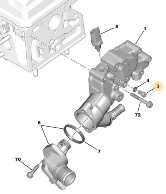

Yes, a bleed screw as shown at 3:
This is a Euro 5 standard engine - so they run at higher temps to reduce emissions and get there more quickly.

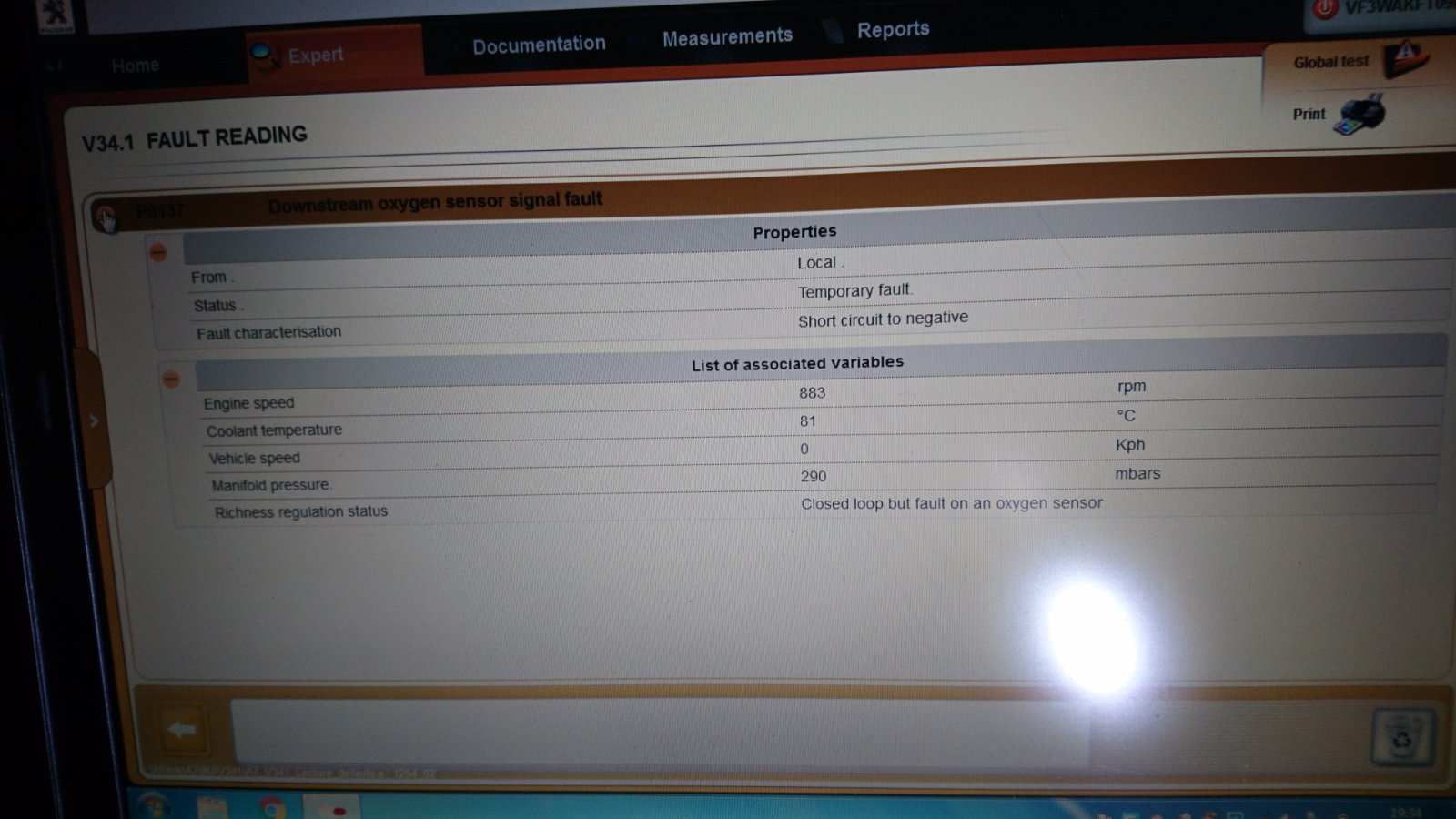

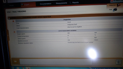

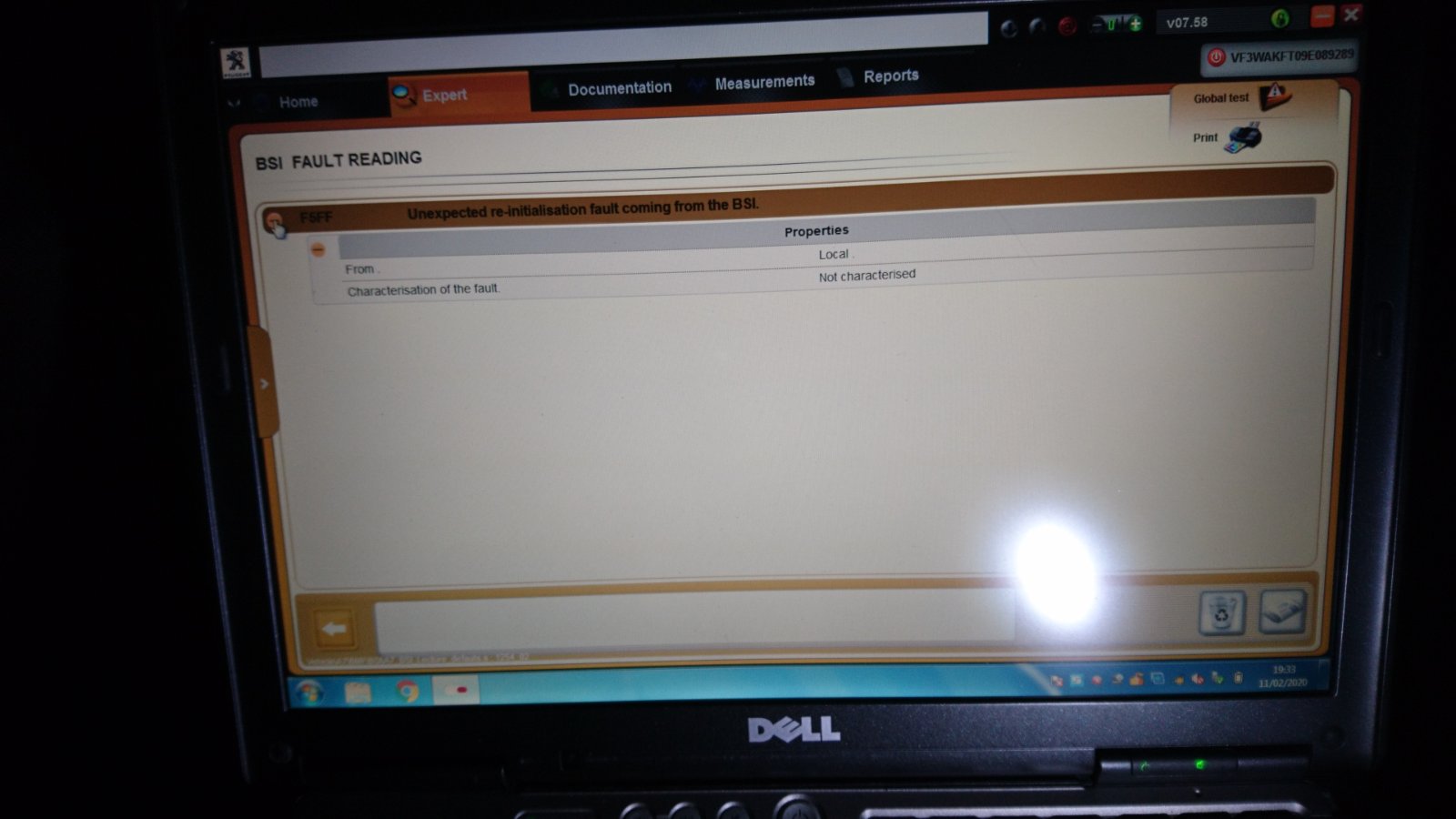

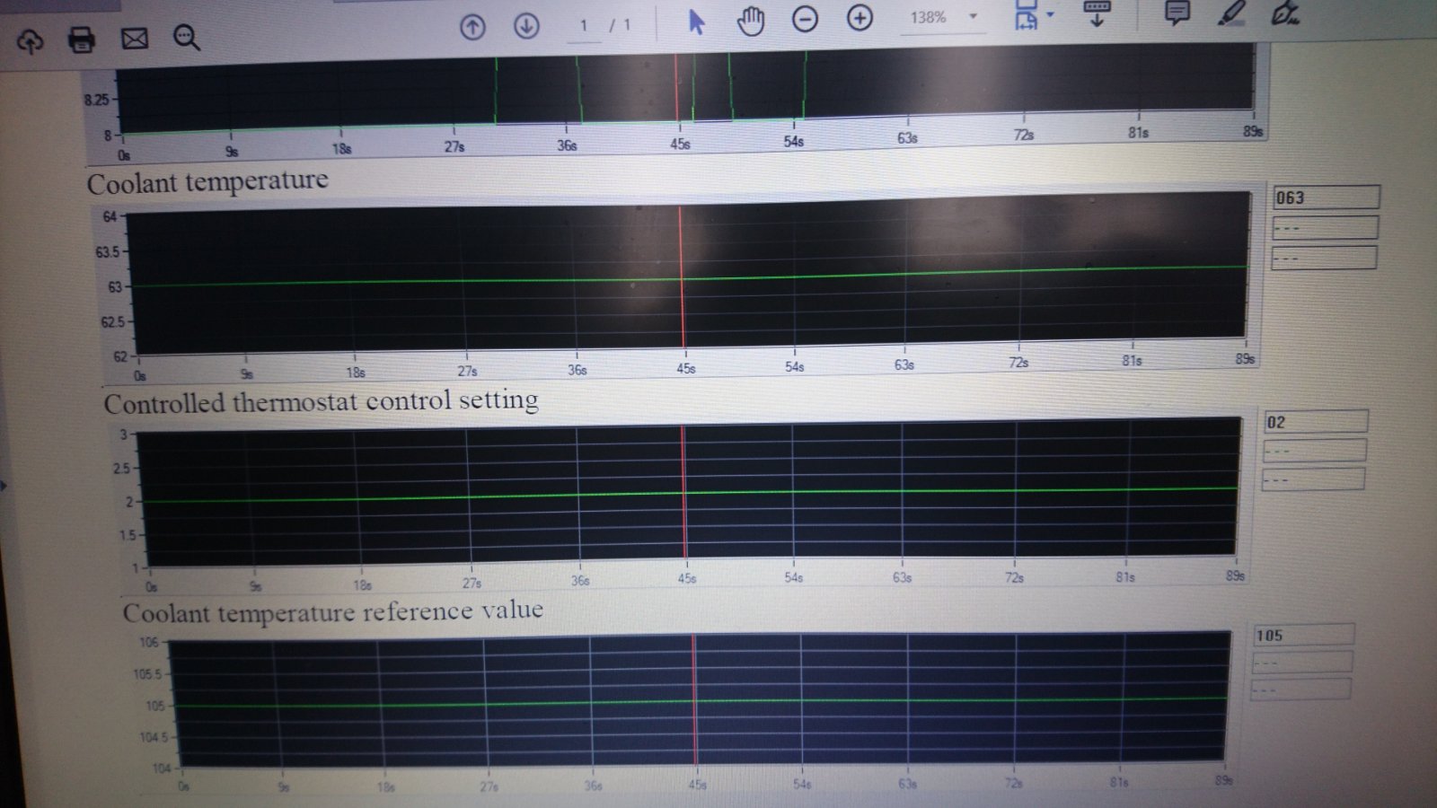

Done a global test and apart from both speakers not working the only faults found are the below.
Not too worried about the BSI one, will do another Global over the weekend to see if the oxygen sensor pops up again.
Can i go into Diagbox and tell the ECU i want it to go to bleed system mode or trust that 10 secs idle, 10 secs 1500 revs and 10 secs idle will work ?
May just get a new Stat if they are cheap enough, seen a few that state 103 degrees opening that fit and others at 105 degrees so will need to keep an eye on part numbers and opening values + the electrical control opening.
Thanks in advance and for everything posted so far to help my boy out
Colin

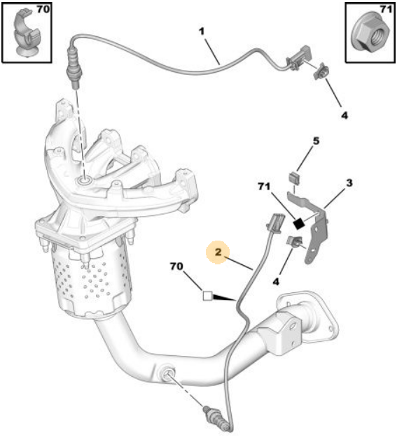

Ok, so the BSI one you can ignore.

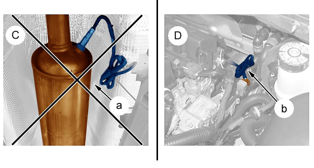

P0137 is the Downstrean Oxygen Sensor signal fault: Short circuit to earth. The downstream oxygen sensor voltage is lower than 29 mV.
The engine ECU will deactivate the monitoring of the air intake whilst this fault is active and put up the engine management lamp and driveability will be downgraded.
The suspect areas are the Downstream oxygen sensor (ON/OFF), Electrical harness or Engine ECU. So the first stop is the sensor itself - the lower one on the diagram below:
Now a word of caution:

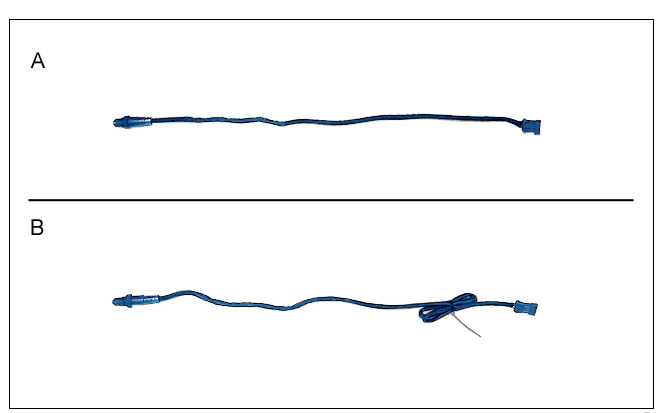

Although 1628NY is the original replacement part, they now suggest replacing it with part 1628TH. This has a longer cable and needs tying securely and away from the exhaust. On several PSA vehicles the original sensor cable is too short and gets burned by the heat from the exhaust, this then causes a short.
There are several technical service bulletins on this - and although not specific to the 207 - they have decided to roll this modification to affected vehicles and the 207 is included. So don't bother with the original part - it will just be building up to the same issue at a later date no doubt.
"A" Original Part - This is the original sensor
"B" Modified part - This is the new part
"C" Fitting incorrect: The excess electrical harness is secured too
close to the exhaust line (at " a").
"D" Fitting correct: Secure the excess electrical harness close to the connector (at " b").

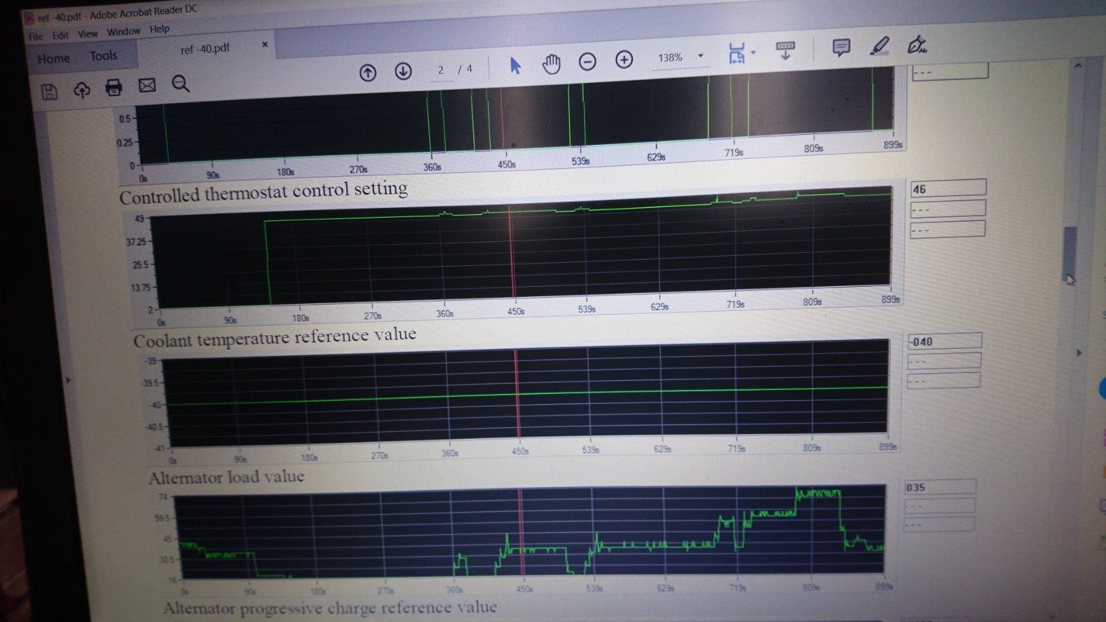

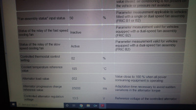

I do not have the time of the fault with the sensor but looking at it the coolant temp is showing as 81 degrees.
Whilst i wait till the weekend to run another test and look at doing the bleeding procedure if the temp sensor is not too expensive would it worth getting one and replacing it as he has no history of it ever being done.
Reports from him today says the temp gauge barely moved above 70 degrees, albeit on a short 16 mile run in stop start traffic.
Colin

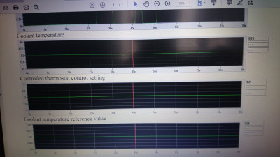

Just a quick update
Tonight it seems that whilst driving the car it sat around the 70 degree mark whilst in heavy stop start traffic and then leaving it running whilst chatting to a friend he says the gauge went up close to 90 degrees.
Any thoughts before i shell out hard earnt cash :)

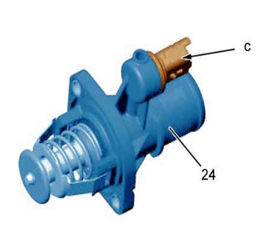

Marc do you know the part number for #5 which i think is the coolant temperature sensor if you have a spare 5 minutes.
Thanks Colin
Posts: 37005
Location: West Wales
C5 MK I 2.0 HDi SX Wicked Red
C15 Romahome White
XM 2.0 SX Polar White
CX 20 Polar White
GS 1220 Geranium Red
GS 1000 Cedreat Yellow
x 5646
Re: New owner 2009 207 1.4 thermostat/temp sender question
Post by GiveMeABreak »
Replacement part: 9636777180 Original is £54.14 from Peugeot Colin inc.
M12 X 150 2 Pin Green.

Update and all tests done stationary in driveway
Some good news some not lol
Done another Global test, only faults showing are the rear speakers which is nothing to worry about, oxygen sensor not showing so fingers crossed.
Still learning with Lexia but did manage to find the engine ECU and managed to check live data on temp and cooling fan operation.
The engine temp seems fine, watched it go from 52 to 89/90 and then slow speed kicked in followed by full chat and temp dropped to 83, fans then switched off, fast first then slow fan.

Really going to need some expert help now.
Have taken it for a test drive and got some live test data which is now concerning me.
The engine temp never got above 63 degrees and gauge was showing correct reading.
Sat in a lay by and revved till engine temp got 80 degrees drove off and engine temp dropped back down to 63 :(
In the first pic it shows the coolant temp reference value as -40 degrees, that was from the previous stationary test.
In the next 2 pics it shows the driven test, and although it shows the reference as 105 degrees in the test this value was -40 not the 105 showing ??
Also the controlled thermostat value is 02 no idea what that means.
Hoping what it means is that the stat is fully open.
Over to the experts :)
