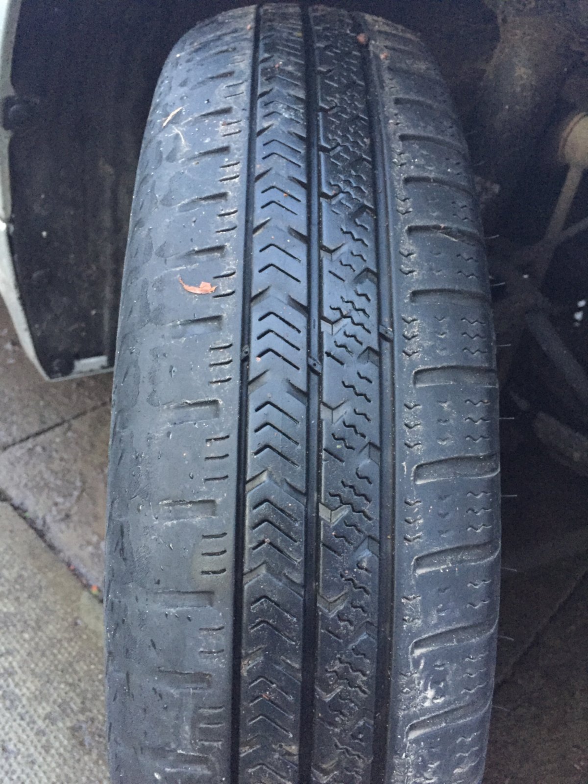

That tyre will pass - 1.6mm min across the central 3/4, outside can be bald and it will pass (as long as the cords are not visible. Looks like it's running too much toe in however!!

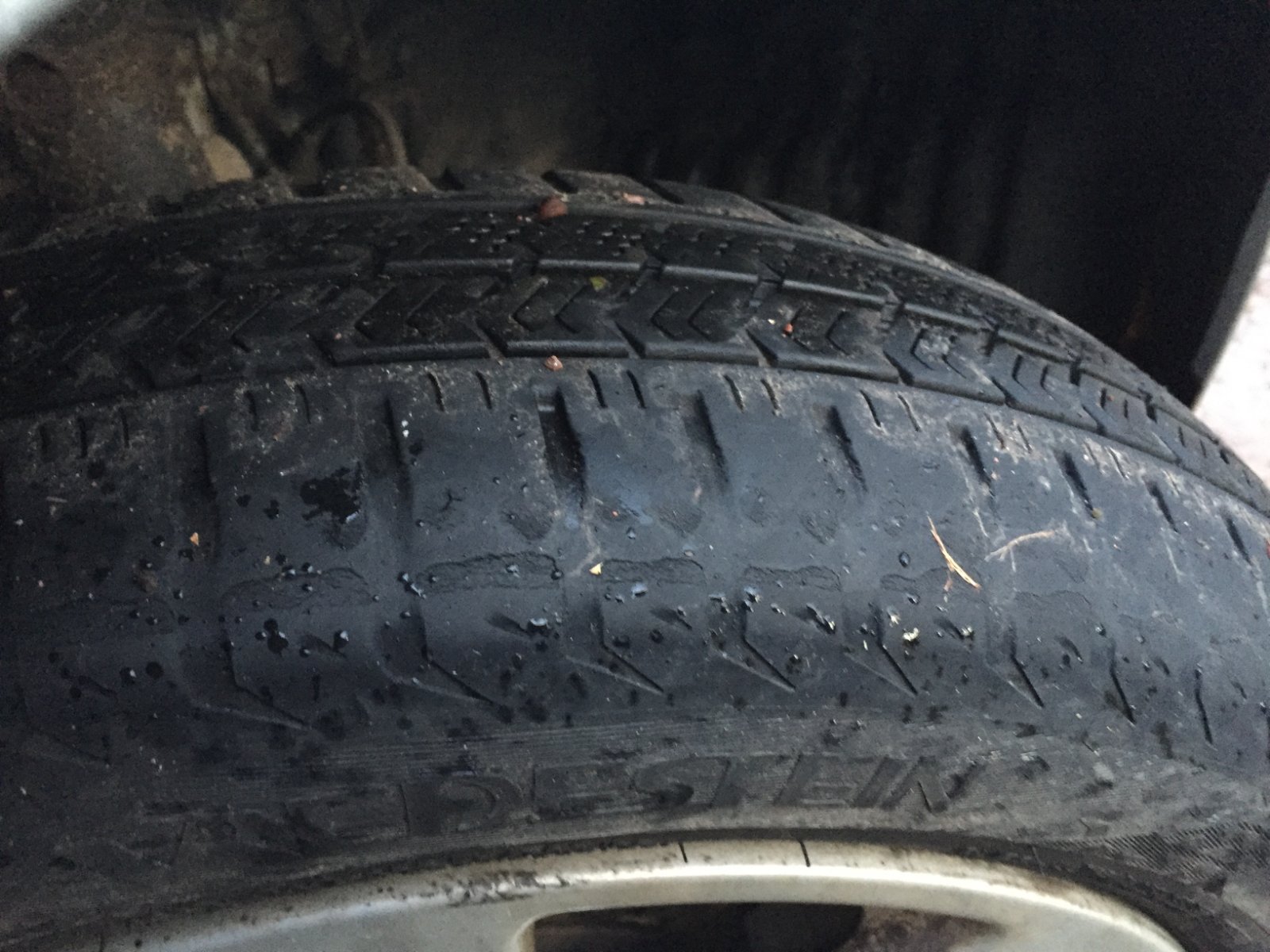

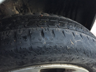

Cords not visible yet, but very close. See the strange patches on the edge of the bald bit where it has worn completely through the outer carcass to the inner carcass - that's how the rear tyre with the dented rim went just before the wire cords started showing through and within a thousand miles there were snapped wire cords.RichardW wrote: 11 Feb 2020, 19:27 That tyre will pass - 1.6mm min across the central 3/4, outside can be bald and it will pass (as long as the cords are not visible. Looks like it's running too much toe in however!!
That tyre was originally on the front left - which is the corner that got the lower suspension arm bent when it hit a traffic island, however I think that arm might have been slightly bent prior to that due to pothole impacts... after the arm was replaced the tracking was set by the garage and I swapped the front tyres to see if there was any further wear on the front left outer edge on the other tyre but there hasn't been. So I think the original source of the wear is gone.

1.6mm over 75% of the tread width is the rule, the tyre should pass but will get an advisory, the tyre also looks to have been run slightly underinflated.RichardW wrote: 11 Feb 2020, 19:27 That tyre will pass - 1.6mm min across the central 3/4, outside can be bald and it will pass (as long as the cords are not visible. Looks like it's running too much toe in however!!
