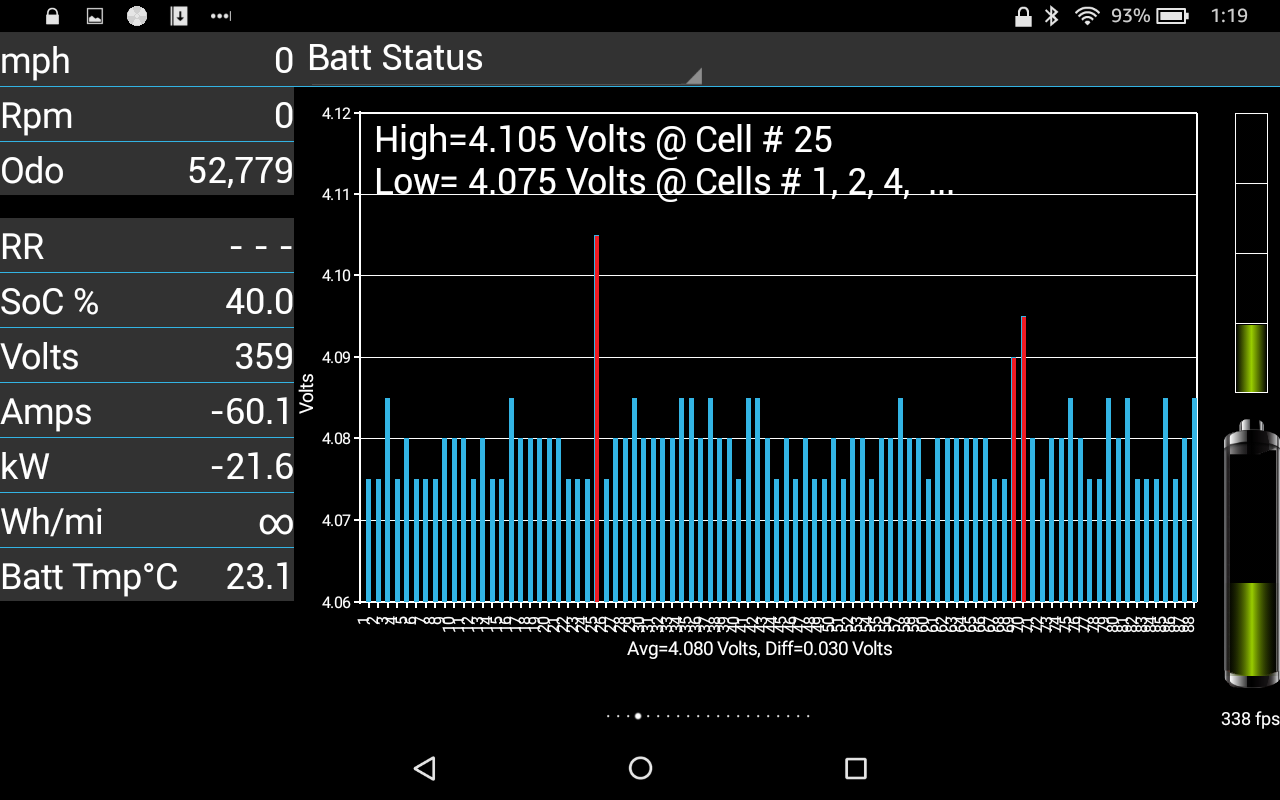

The test does return some data though, the capacity of the best cell in the pack and the worst cell, without identifying which the best and worst cells are. In other words it just tells you the spread between best and worst. The first time I ran the test in April 2018 it reported the best cell was 41Ah and the worst 38.1Ah. When I re-ran the test in May 2019 it reported 40.5Ah for the best cell and 34.8Ah for the worst cell - the spread is increasing. This is very apparent in the data I have been collecting on the Ah figures:

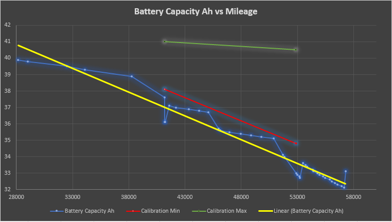

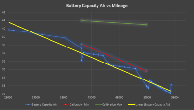

There's a lot of information to unpack in that graph. The blue line represents the Ah for the pack as a whole as reported by the BMS with dots being specific measurements, and this is the figure it goes by to calculate range. The initial blue line up to about 38k miles is fine, and the slope of the line is representative of "normal" cell degradation with age and use. Around 38k miles it suddenly took a turn for the worst and started dropping at around 4x the rate. The yellow line is a linear interpolation as calculated in Excel which gives a good idea of the overall downwards slope.
The green and red lines show the two data-points of best and worst cells from the battery calibration process, from this you can see the degradation of the best cells (green) follows a similar slope to the blue line before 38k miles, while the degradation of the worst cells (red) very closely tracks the linear interpolation of the actual measurements. Uncannily so. (You can also see the 1Ah buffer between the yellow and red lines)
So I know what the spread of capacity is between best and worst cells and that it is spreading further apart with time (worst cells degrading faster than the good ones) but I still don't have actual measurements of individual cell Ah capacities to know which the worst cells are. The nearest you can come to this is by using voltage estimation.

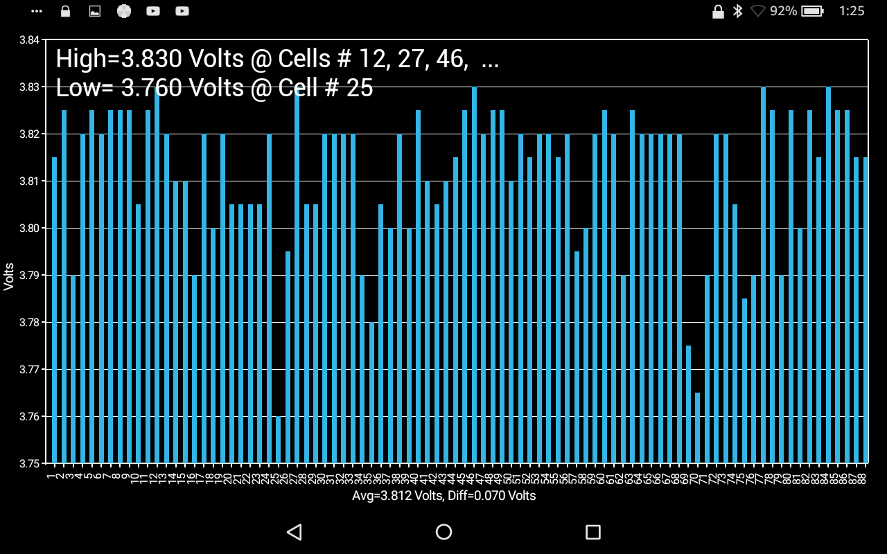

The basic technique is to first fully charge the battery and let it finish balancing the cells. The CMU's and BMU will work together to ensure that all cells reach 4.1v +/- 5mV at full charge.
You then discharge the battery as a whole to a relatively low state of charge - I find about 20% works well, and look at the voltages of the cells. Here is an example that I took just before removing the battery on the weekend:
When all cells are discharged from the same starting point the difference in voltage when they are nearly discharged is representative of their usable Ah capacity. So in this example cell 25 is worst, then 70, then 69 then 35, and those are the cells I have replaced. There are a few others which I would have liked to replace as well in hindsight, however as they're £50 a pop and this replacement is still experimental I'm only replacing four for now.
Unfortunately the voltage to state of charge relationship of Lithium Ion cells is very non-linear and "stretches" out a lot once you get below about 30%. As a result, the lower the state of charge of the pack as a whole when you take the voltage measurement the larger the differences in cell voltages will be. So it's important to choose a reference SoC to use in measurements and stick to it, but also keep in mind that while you can rank cells from worst to best using this measurement method you can't determine the actual Ah figures of the cells, apart from the worst and best cells that the battery calibration routine will report. It's just too non-linear to read too much into the specific voltage readings apart from rankings.
While there's only 70mV between best and worst cells in that table and that might seem small, it actually represents a capacity spread of more than 6Ah, or about 15% capacity.
A second test that can be done on the cells is an indirect test on the internal resistance of the cells. Cells that are damaged or have suffered abnormal deterioration such as through overheating, physical shock, or perhaps which have hidden manufacturing defects that come to light over time often show signs of increased internal resistance.
Measuring this directly is nearly impossible on the bench as the normal resistance of one of these cells is 1.5mO or about 0.0015 ohms - good luck measuring that with alligator clips and a tester of some sort...

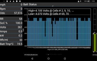

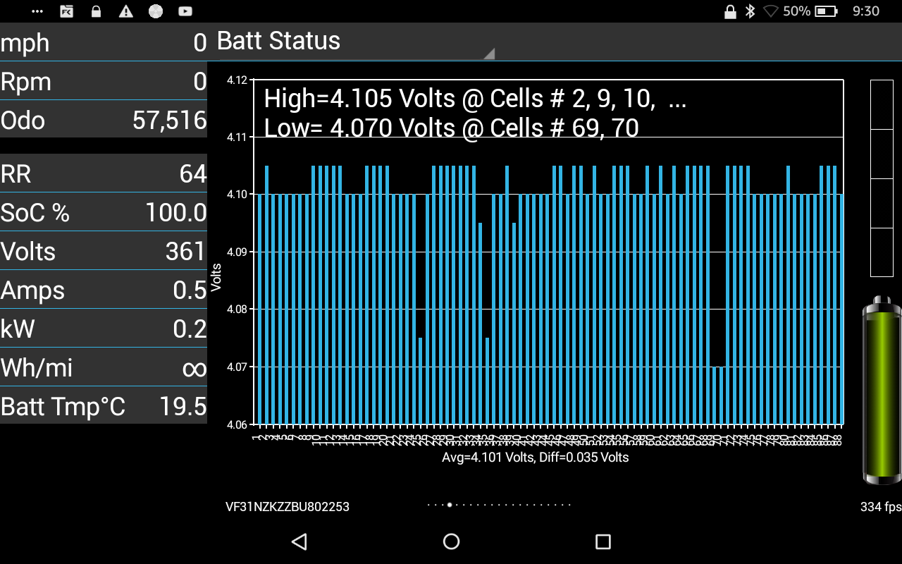

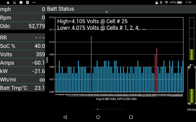

So if you start at a low SoC and start rapid charging at ~40kW it's charging the cells at over 100 amps, and this is high enough for small differences in internal resistance to show up as the cell terminal voltage rising unusually high relative to other cells. And here is an example of this:
The guilty cells highlighted in red. Moments before the rapid charge started those same cells were the lowest voltage of all the cells, and within about 30 seconds to a minute after starting to charge they're on the order of 30mV higher than other cells. This sudden change from being lower voltage than the other cells to higher voltage when charging starts is a sure sign that the cells have high internal resistance.
This 30mV spread may not seem like much but the charging system will not let any cell go above 4.105 volts during rapid charging, this means the current must be throttled back to keep the weak cell down to a safe voltage, this causes the charge rate to throttle back a lot on what it should be - the cells that are currently at 4.075 volts could handle a lot more current without going over 4.105 volts.
Notice that cells 25, 69 and 70 all show high internal resistance but 35 and some of the other so-so cells do not. So it's possible for a cell to have only low capacity but internal resistance is OK, or to have both low capacity and high internal resistance. High internal resistance is usually a sign of either a latent fault, damage or the cell is just getting close to the end of its life and chemical/physical changes are happening like the SEI layer on the electrodes starting to get excessively thick.
I hope that explains how the cells have been diagnosed and identified. In truth there are another approx 5 cells that are "so-so" - not terrible but not great either which could have done with swapping as well, maybe next summer when the days are long and warm, and assuming this current cell swap is validated.

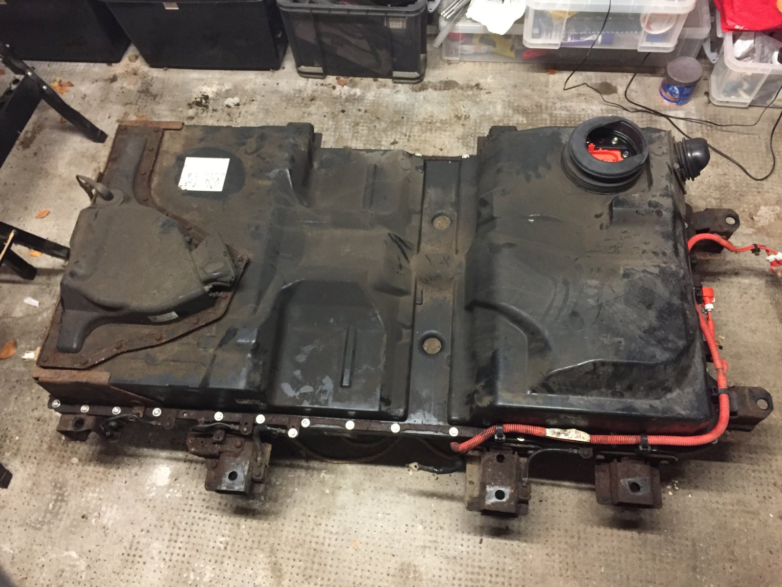

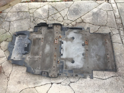

On Friday night I reassembled the cover on the pack which should have been an easy job except for all the rusted bolts. The original arrangement is an M6 x 16mm bolt with a semi-washer head, with a ferrule like spacer (presumably to prevent too much torque cracking the plastic cover) into a threaded insert similar to those you would use in wood except into ABS plastic here.
I ended up replacing all 48 (!) bolts as they were badly rusted, some had snapped etc. The spacers were rusted solid to the bolts so I couldn't retrieve those but I decided they weren't really needed when I was using a much larger washer than the original washer heat bolt, and the bolts clamp down a metal frame that goes around the plastic as a load spreader anyway, so as long as I didn't over tighten them they didn't need a spacer. So that was the pack ready to go back in the car on Sunday:
On Sunday I started refitting the pack. First I had to deal with eight snapped off M6 bolts for holding the bottom plastic covers on...
I tried to remove the stubs with vice grips, hacksaw the protruding ends of (not successfully due to limited access) and all sorts of different approaches, in the end I was forced to drill out and re-tap every single one of them.
I discovered I had an M6 tap that I'd previously ordered to do a thread repair on one of the Xantia's and it literally saved my bacon. It took me nearly 2 hours but I was able to repair and re-tap all the mounting holes on the bodywork so that they all work perfectly now. There are still a few more that need repair but they're on the bottom of the battery pack chassis so I couldn't do those ones until the battery was in!
Mundane stuff like drilling out snapped bolts and re-tapping the holes really spoils what would otherwise be a relatively satisfying job, and makes it take twice as long as well!

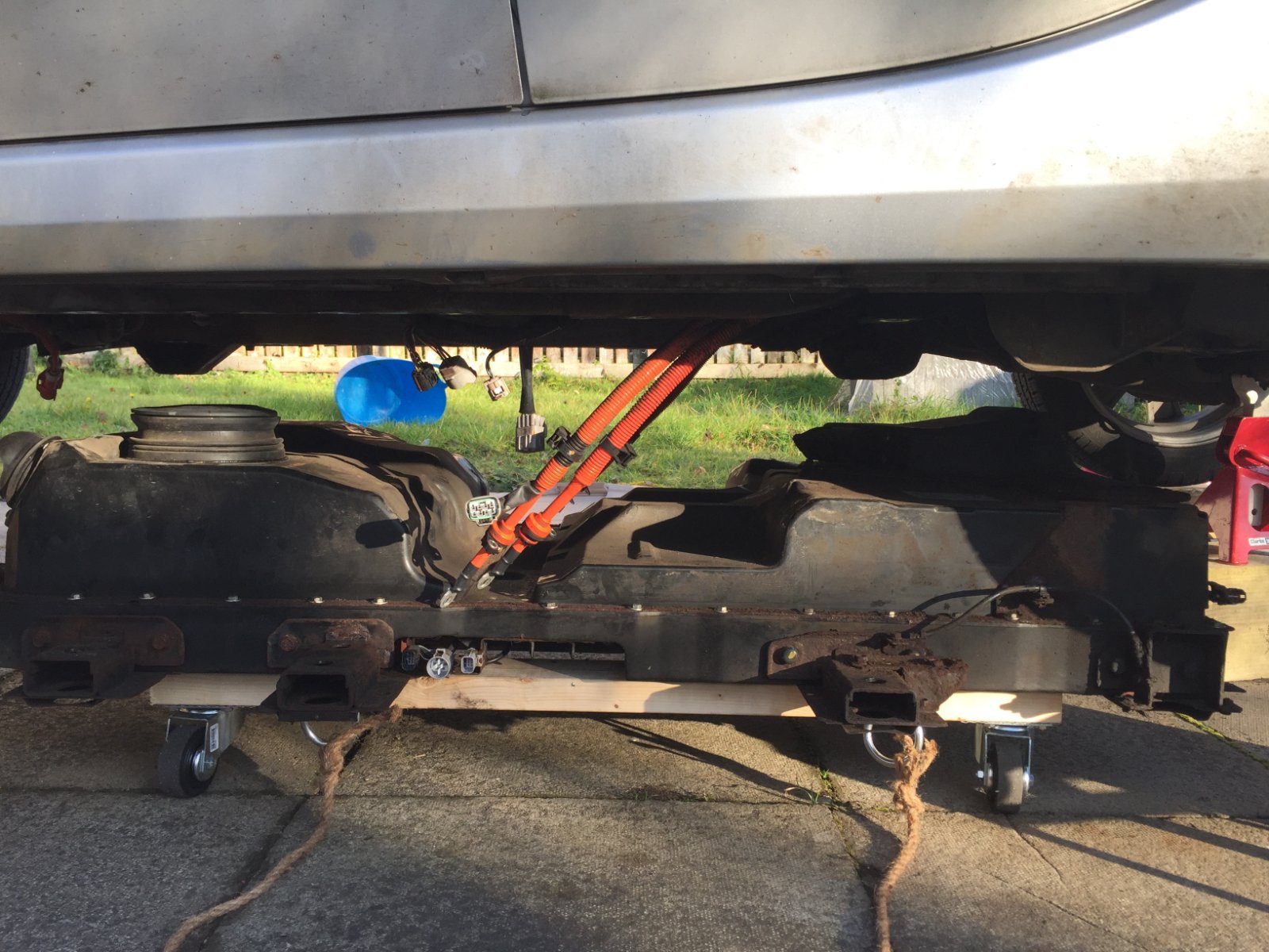

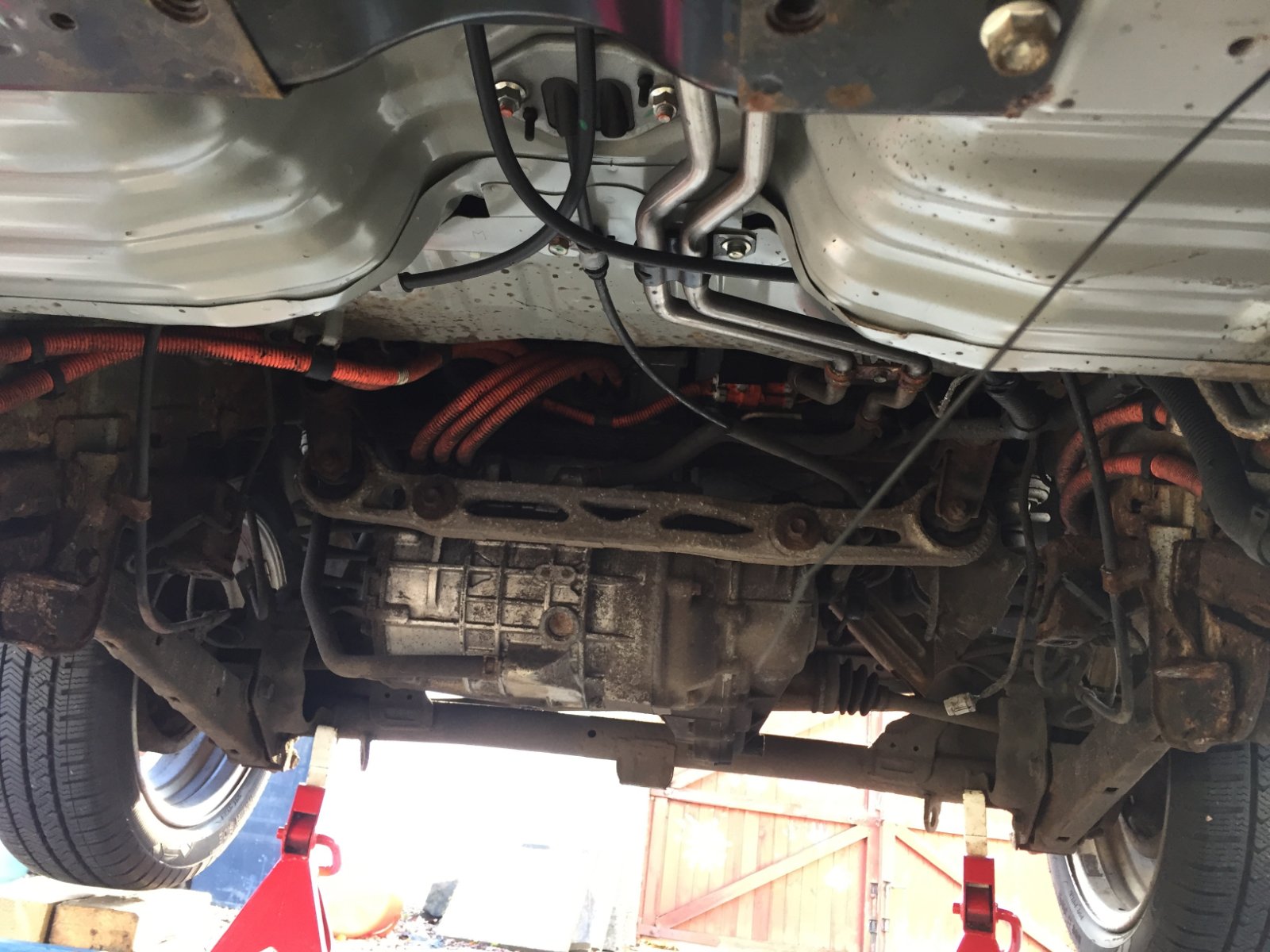

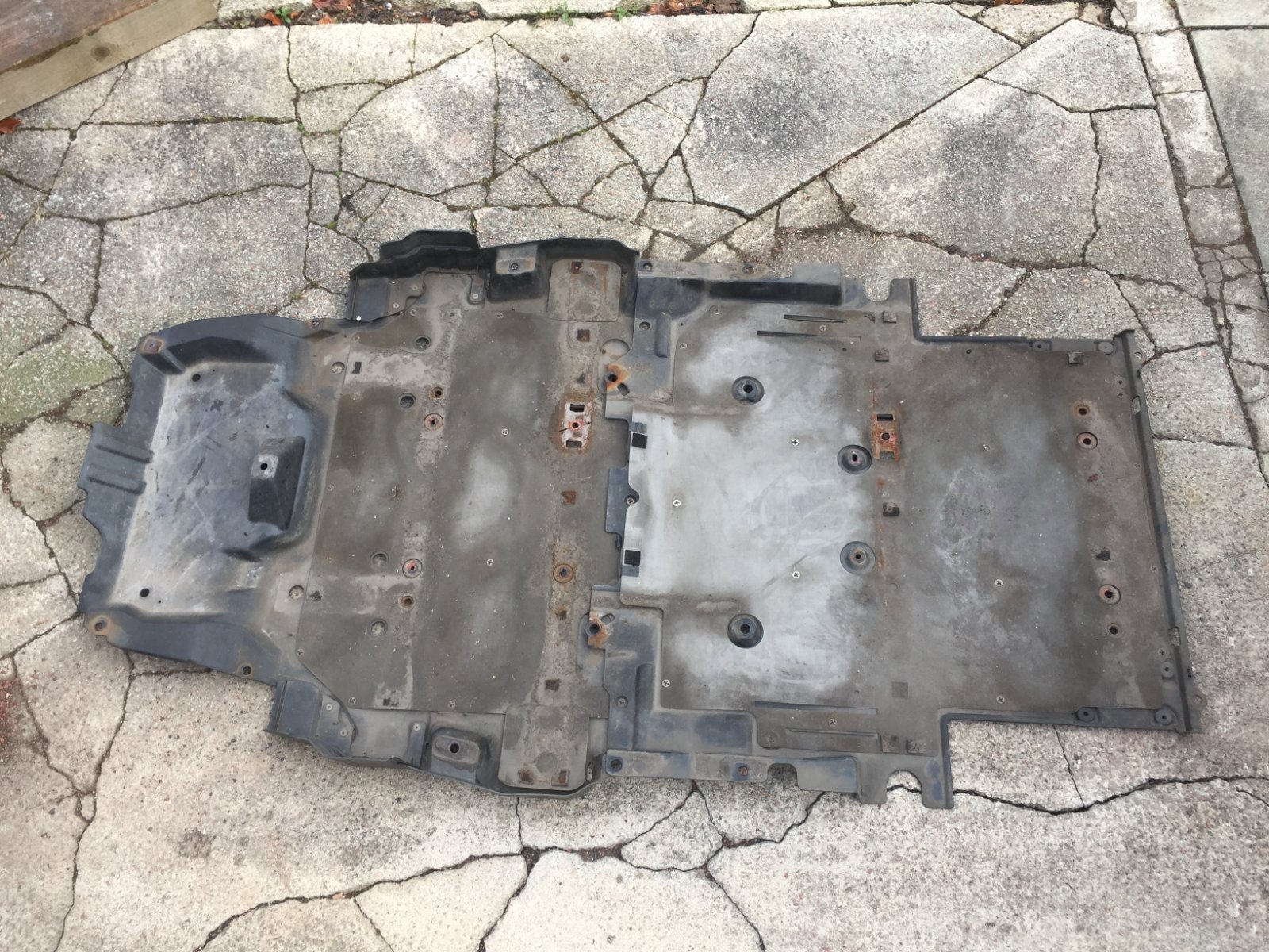

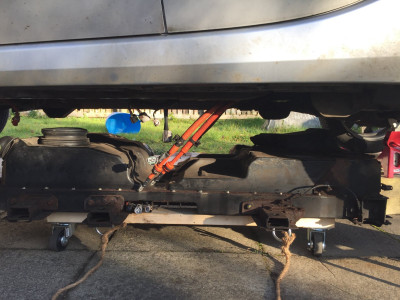

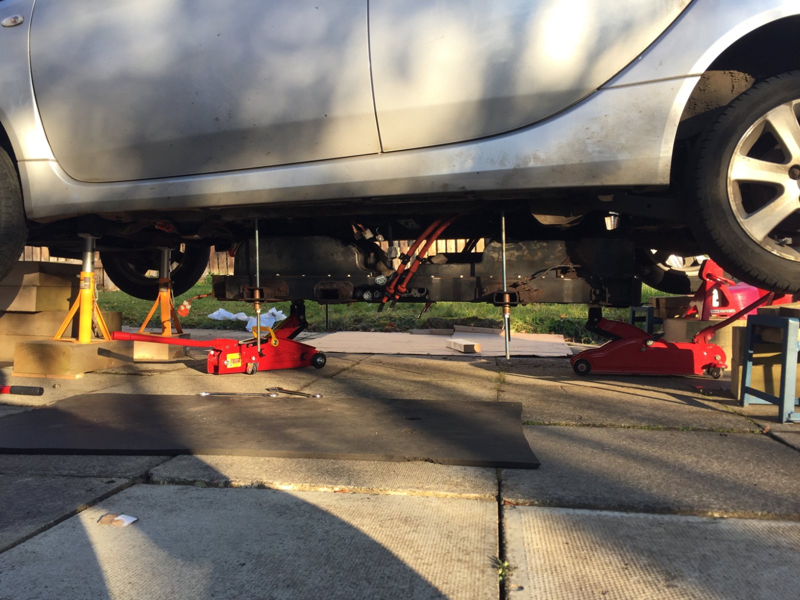

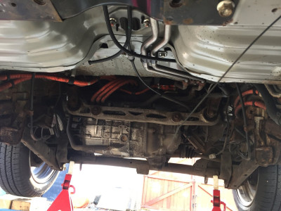

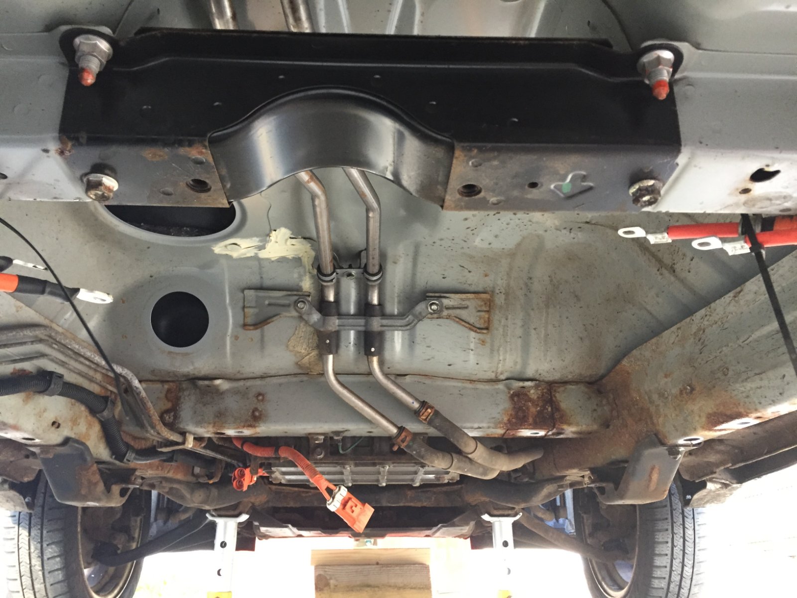

Here are the promised pictures of just how hollow and empty the underneath of the car is without the battery fitted!
Towards the front: Towards the rear: Ready to go back in: Half way up: The technique I adopted was to have one jack at each end, jack one end up a few inches then spin the two support nuts for that end up by finger, then jack the other end and spin those up etc.. Took less than half an hour to actually raise it using that method. Once nearly in contact I installed the remaining bolt 4 bolts, removed the threaded rods one by one and replaced them with their own bolts and then it was in! A couple of little brackets to fit as well.

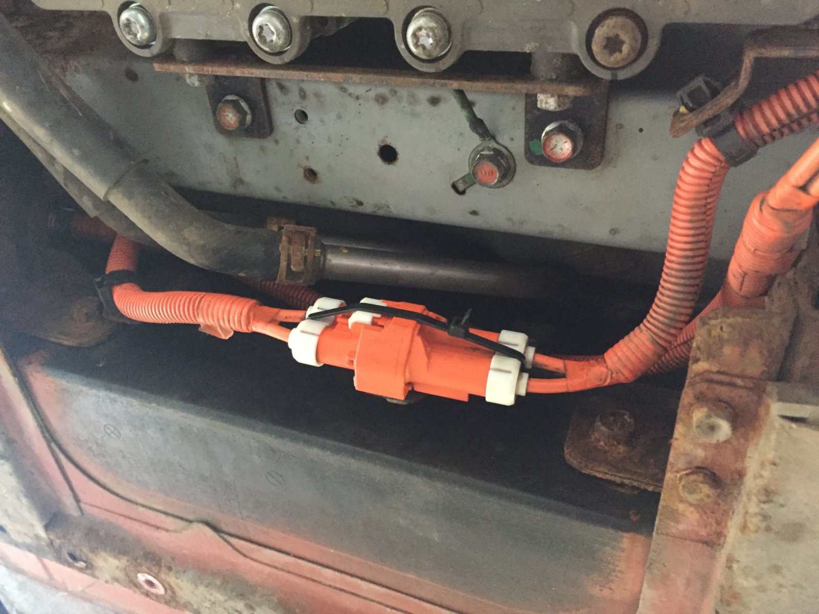

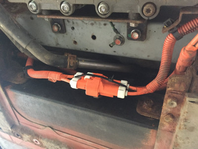

After that the high voltage and data cables were refitted, the high voltage access hatches were refitted and extractor fan reconnected and the safety link plug refitted! I'd managed to snap the locking lug on the high voltage connector for the PTC heater so I had to use a cable tie to make sure the plugs stay pulled together. Whoops.

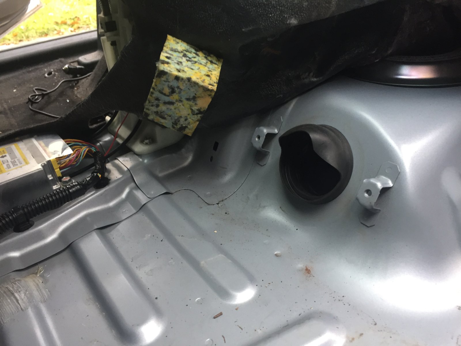

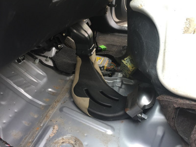

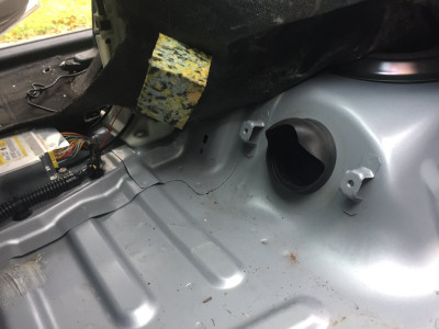

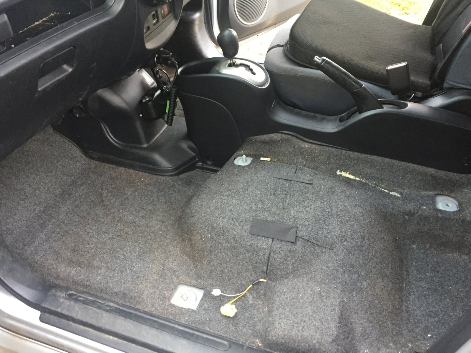

One snag I ran into is that the air inlet vent for the battery is just in front of the passenger seat under the carpet, this allows cold air from the aircon to blow into the pack during rapid charging. This has a big rubber grommet to seal against the body and simply raising the battery up and bolting it into place does not engage this grommet properly and ends up partially crushing it and leaving a non-water proof gap, so not OK to leave it like that.
So I then had to pull up the carpet and disconnect the air vent pipe that attaches to it under the carpet so I could pull the rubber grommet through and clip it into place for a good seal on the bodywork. While it's probably covered in the workshop manual this is a step that could easily be missed in a DIY repair because you can't see that it's not sealing from underneath or from inside the car unless you lift the cabinet and remove the air vent pipe!
When I moved the air vent across on the floor it then detached itself from whatever it's attached to in the heater unit in the centre console...
So before I can finish properly I'll now have to pull the passenger side front footwell carpet right out and disassemble the lower middle console to fix up the attachment of the air vent pipe as I'm not sure whether it just pushes into place or whether I've disengaged something. Annoying but not a big deal.

I think the whole of the UK has a high tolerance to rust on the underside of cars...white exec wrote: 18 Nov 2019, 17:47 You do seem to have a high tolerance for rust, though, Simon. Before refitting the battery unit, I really would have treated those rusty chassis parts with some protective wax. I know you have an aversion to the stuff (it shows on the Xantia underside) but with the cars spending their time in Scotland, it seems a shame not to provide protection against all that winter weather and salt.
My first Xantia over here would have failed the warrant of fitness in NZ without doubt due to severe corrosion on the suspension components and I was extremely worried taking it in for it's first test yet it passed here with nary a comment from the MOT man. My current Xantia has very little in the way of body rust including underbelly due to good under-sealing from the factory but once again suspension components have a lot of corrosion that would fail in NZ - here it's a pass without a batted eyelid presumably due to the expectation of high levels of surface rust due to road salt.
I don't plan to keep the Ion for more than another couple of years I think - by then I can hopefully find and afford something a bit bigger with a bit more range. It's been a good foot in the door for EV ownership that has taught me a lot about what I want for my next EV but its limitations are starting to wear on us a bit now, mainly range, limited space and uncomfortable (for me at least) seats, and just a lack of refinement - when new it was basically a cheap car with a very expensive battery!
Also I noticed in the photo looking towards the front the rush patch you see on the cross member on the right hand side actually had water dripping out of the bolt holes from ice melting on the window while the battery pack was out - so clearly there is a flawed drainage design that leads to water draining from the top of the car running down inside the cross members under the floor that the battery pack mounts to...

The plastic covers went on without too much trouble:

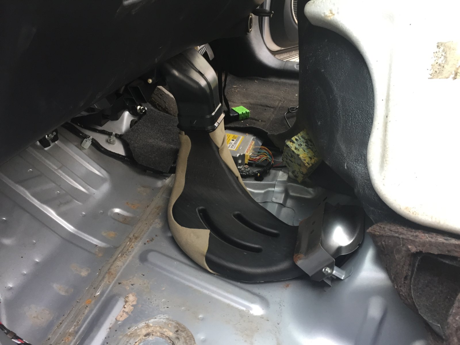

Then I disassembled the bottom of the centre console which turned out to be very easy and lifted the carpet, revealing the ill fitting rubber gasket that is now snugly clicked into place:
I then refitted the air vent:
And all back together - you would never know there was an air vent for the battery under the passengers feet.
Quite a clever arrangement. At a time when most EV's had no cooling for the battery at all (The Leaf still doesn't have any!) Mitsubishi were smart enough to connect the A/C system to the battery pack and blow air through it when rapid charging.
If the cells are below 20C no air is blown through as the object is to warm the battery up above 20C to speed up charging rates and improve efficiency. If the cells go above 20C the blower fan is diverted through this pipe into the battery enclosure (ambient air only) and the exhaust fan in the enclosure kicks in as well to suck air out the back. If the cells go above 30C the A/C compressor kicks in as well to cool the air blowing into the pack and it will automatically work harder the hotter the cells get above that. Above 40C the car will start to throttle the charge rate back. Ideal cell temperatures for rapid charging is between 20C - 40C.
The seat then went back in and I then went for a test drive and test rapid charge, all of which worked fine.
I'm still quite miffed that I got the cell state of charge balance between old and new cells so far out, this can be seen in the following screenshot taken at 100% charge where the new cells are about 35mV below the others:
Normally balancing happens while charging between about 80% and 100% SoC and by the time the cells reach 100% they are all balanced +/- 5mV and charging stops. However it's so far out that once it reaches 100% it continues balancing for approximately 2 hours before giving up and stopping. I worked out earlier that it will take at least 20 hours of balancing over the next 20 charge cycles or so (several weeks driving for me) before it comes right, but at least it will do it automatically.
So far the BMU has not reported any difference in Ah capacity of the traction battery but I wasn't expecting it to - it's not aware that some cells were changed out from under it and the battery has not been discharged low enough yet for it to perform an opportunistic measurement, and with the cell balance a fair way out the usable capacity will be down a bit from its full potential anyway.
I don't plan to run the battery calibration routine in Diagbox until the cells finish balancing, however it will be interesting to see whether the BMU detects any change for itself and revises the Ah figure. I believe that if the battery is discharged below about 30% and then fully charged and it sees an increase in capacity across several such measurements it will revise the Ah figure upwards but only by about 1Ah per time, whereas performing the battery calibration does an explicit calibration which will jump immediately to the measured value.
Until then I'll just have to wait and wonder whether it has made enough of a difference in range for all the work to have been worthwhile...!

The long road to reach cell balance continues...
Still 30mV out when fully charged, with the car continuing to perform balancing for about 3 hours after reaching full charge.
Normally I get home and plug in around 6:30 to 7:00pm and the charging is finished by 10:30pm at the latest however due to the balancing it is still going until after 1am in the morning...not charging as such as it's drawing next to no power, it's just sitting there running the small bleed resistors for all cells except the lowest ones, bleeding them very slowly at 100mA...
The Ah figure reported by the BMU has changed by itself a couple of times since the battery was reassembled - it was at 33.0Ah when I first reassembled, then it dropped to 32.9Ah the day afterwards, then this morning it has jumped up to 33.9Ah by itself.
The 0.1Ah drop was just part of the normal degradation model - in the absence of measurements it will slowly tick down the Ah figure at the expected rate of battery degradation (which seems to be 0.1Ah / 1000 miles roughly) and then over the last couple of nights charging from <30% to 100% it must have measured significantly more than the capacity it was expecting, so it has made an upwards correction of 1Ah.
From what I've seen of a couple of other people who have done battery or cell swaps in their cars without access to a diagnostic tool to do a battery calibration, the BMU will bump up the capacity 1Ah at a time every few hundred miles if it continues to measure a higher capacity than the current figure over a full charge cycle. So even without a battery calibration it will eventually increase the usable capacity, but it could take a long time compared to running an explicit calibration.
The fact that it went up at all, by itself, is a good sign that the BMU is seeing an increased capacity when it charges and is willing to increase its estimate.
