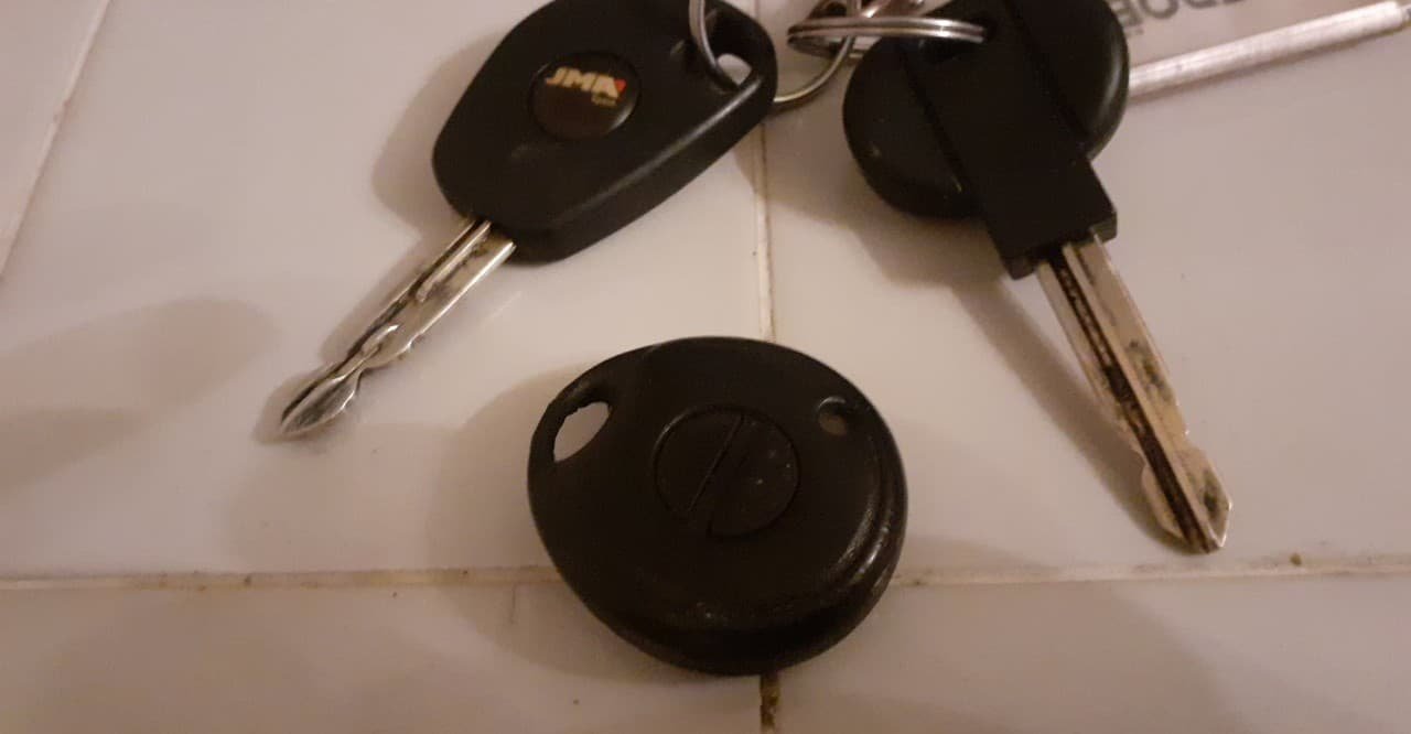

Buddy has a 2005 Dispatch, 2 keys, and a round 'pebble' remote.
Key 1 works the ignition & the petrol cap
Key 2 works the 2 front doors & the back doors. It just spins in the side loading door locks & doesn't engage any manual or central locking action.
In either front door, key 2 operates central locking which locks the opposite front door as well as the front door the key's actually in, and also both side loading doors. However in neither front door, does key 2 operate central locking on the rear doors.
The rear doors are lockable with key 2, and one can hear a sort of electrical servo type noise (like a motor being forcefully driven manually by the shaft) when the key is turned. However, turning key 2 in the rear doors only results in the rear doors being locked or unlocked, there is no actual response from the central locking and all other doors remain locked or unlocked, in whatever state they were in to start with.
Key 1 sometimes 'sticks' in the ignition barrel such that if the operator doesn't have 'the knack', they cannot start the engine or release the steering lock. I can occasionally with trouble undo the steering wheel and start the ignition; the owner simply can't, he's too ham-fisted & just doesn't have the mechanical empathy required.
The 'pebble' remote supplied with the vehicle (by way of it being left in the glovebox by the last owner, but never actually referred to during sale) lights up green when either button is pressed, but it does not seem to engender any response from the vehicle. Tried walking round the vehicle closely, twice, whilst alternately pressing each button - nothing. Checked it's batteries, together they give 5.7V total.
Key 1 has a red insert on the edge, I don't know if this is access for an ID chip of some sort
In the image, key 1 is on the left.
Any suggestions that might help me get the locking system on this vehicle fixed up to a usable standard would be good

Ok, so as I suspected the keys are not originals, These are the ones originally supplied back in 2005:
They even supplied spare button diaphragms back then.
Anyway, from what I can see it had simple central locking and no BSI or multiplexing, so no fancy door opening options back then. So it looks like a separate lock / locking system has been installed for one reason or another - and that is going to make it difficult to work out what has been wired into where - but evidently it has impacted on the locking system.
When an aftermarket solution has been installed it can have unintended consequences on the other locks, as from what I can see they are all supposed to open from the central locking system using the original keys.
It may of been that there was a break in the wiring to one or more of the doors and this other aftermarket unit has been fitted and wired into a power source that has its own receiver / lock.

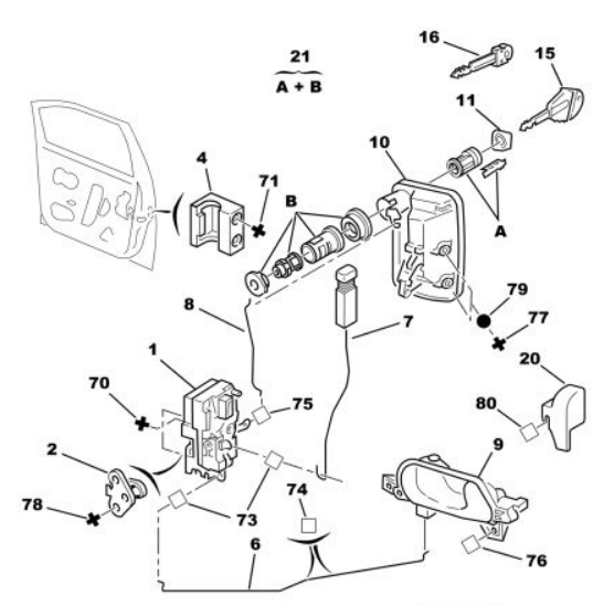

Here are the locking components - some parts no longer available, but item (21) - Cylinder Block is available (part 9170AY random combination) or part 9170AZ for combination specified on ordering (to match keys).
The front locking module (1) is also still available
