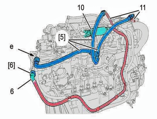

Rich, Have you bled the system? This is a requirement when replacing the fuel filter - if it is not done you are going to have problems - it's not just a matter of swapping parts over.
2 People are necessary to bleed it.... one to prime the pump and one to action the starter motor.

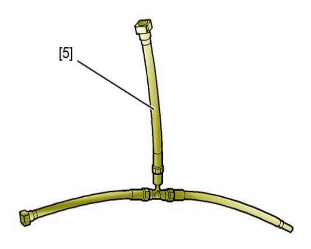

You'll need tools like these:
Couple up the female union (Ø 10 mm) of the tool [5] in place of the union (6) (at "e").
Close the union (6) using tool [6].
Clean the union of the fuel return pipes (11).
Uncouple the union of the fuel return pipes (11).
Couple the unions (Ø 8 mm) of the tool [5] to the unions of the fuel return pipes (11).
Operate the manual priming pump 120 for (10) seconds to prime the fuel circuit.
Remove:
Couple up the union of the fuel return pipes (11).
Operate the manual priming pump (10) several times to prime the fuel circuit.
Action the starter and the manual priming pump until the engine starts.
Union Tool [5] | Plug Kit [6] |
Remove:
- The tool [5]
- The tool [6] from the union (6)
Allow the engine to idle for 2 minutes.
