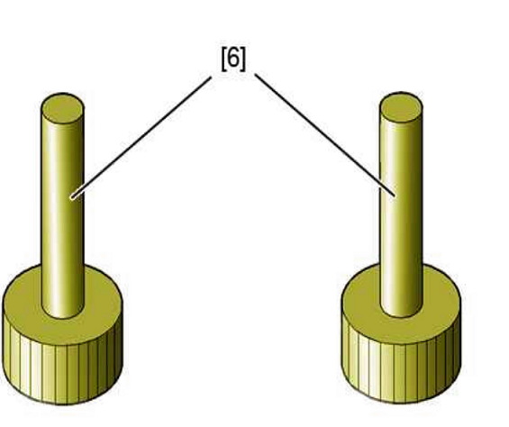

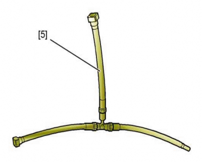

You'll need tools like these:
Couple up the female union (Ø 10 mm) of the tool [5] in place of the union (6) (at "e").
Close the union (6) using tool [6].

Couple the unions (Ø 8 mm) of the tool [5] to the unions of the fuel return pipes (11).
Union Tool [5] | Plug Kit [6] |
