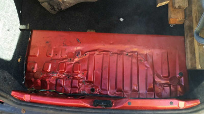

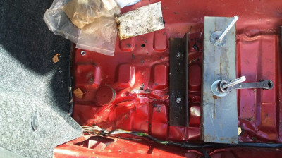

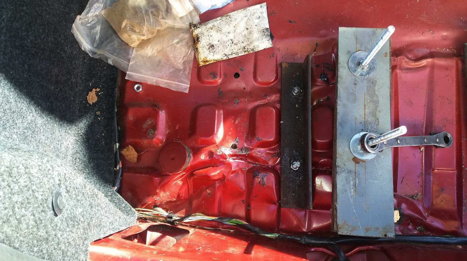

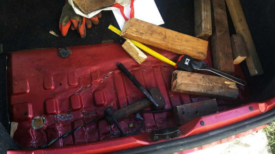

Hi Guys, aware things have been quiet the past few days. Still alive & well and making progress, but things have been mega-busy
Daughter's Ford has been cleaned, an online Owners Manual sourced and a replacement Wheeltrim ordered; no preventative maintenance yet, but I don't intend leaving it long
The bits of wood have been of some use straightening the 206's Boot Floor, having Routed them with a Router I was given some time ago but had never used.
I've also created some wooden Wedges and cut down a Brick Bolster to use as a Drift . .... but the real key bit of kit in sorting it out has been a couple of sturdy bits of Angle Iron; its not yet finished but I'm delighted with the results so far
The 405 misbehaved on a regular run, with the temp reaching 105c; and I was fearful of being completely transport-less, but running it without the cap on the Header Tank has provided further respite. Its 'Sun Holiday' time again and as such its booked on a Cross-Channel Ferry for late May
Back soon.... ish
Back soon.... ish

Re: 405: Major Works
Now that looks a helluva lot better than what it did
, that boot floor's never going to win any beauty contests & nor is Daniel's cars inner rear quarter but the shell's at least close to the shape it started out as & should serve well whilst the 405 gets some love. Just have to hope the 206 bug doesn't bite you as hard as it has me, else we'll have some competition! (the more time you spend driving that thing, and knowing it has virtually free tax as well as great economy and decent power, they really do grow on you!)

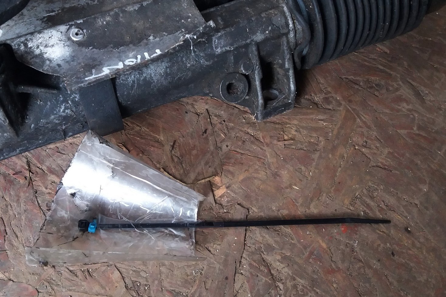

Meanwhile... check out my 'improved' Steering Rack Gaiter fitting Cone, tested on the spare rack; will report shortly on whether it makes the job any easier with the rack in situ.
The 206 has a rattly noise at Tickover, after its warmed up; which sounds a lot like an Aux Belt Idler to me. Certainly hope its not a Cam Belt idler as I'm far too busy to think about spannering on it. Am I gonna have to remove the Aux Belt to check it out, or is it likely to be visible if I look in the right place? The car has AC, so its a serpentine set up

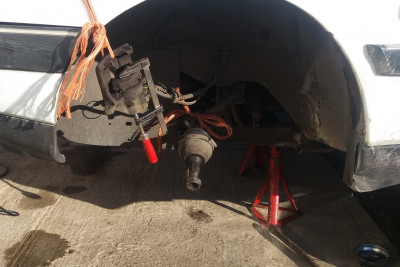

Little bit of an update....
... I really needed an MOT Fail like a hole in the head. This year it was
Wishbone Bushes
a Ball Joint
Steering Rack Gaiters, both sides
and a CV Boot
As well as imbalanced Back Brakes, which were easily rectified.
That's all been taken care of for the princely sum of £35's worth of parts the old girl's got a fresh new MOT and her spare set of Struts & Wishbones on til I can find some time & energy to sort the old ones
...but that's the last time I attempt to replace a Rack Gaiter in Situ. It would've been considerably easier to have had it out.
...but I've got really good at getting recalcitrant Ball Joints out (Angle Grinder) and I was able to complete the works just before the weather turned really nasty; so now engine works can recommence, hopefully !
Meanwhile the 206 now runs lumpy when cold, feels like its not burning its diesel properly. I'd think GP's, but it starts immediately without any cranking and I've not noticed any unburnt diesel smoke. Its fine when its up to temp....
...unlike my 405 which I know has very iffy Glowies, starts reluctantly and is not a pretty sight on a cold start, but its getting very little use, so it'll 'keep'.
I'd be sad if the 206 died and it'd be a waste of all the hours I put in at the back end of it, but I'm sick to death of things getting in the way' of sorting the 405 and really getting quite anxious about it; so hopefully that'll 'keep' too.
Next!! Header Tank Bracketry
