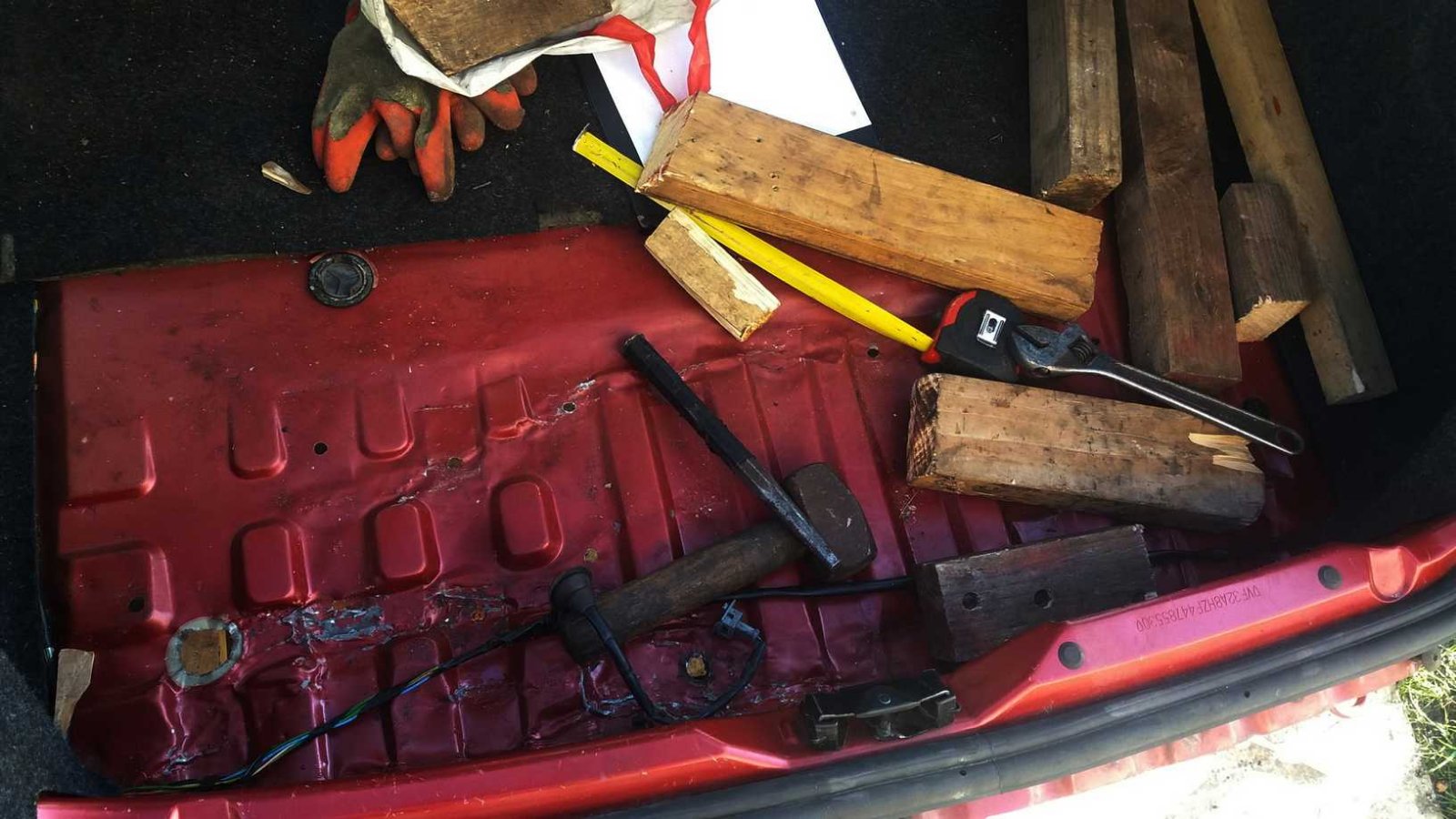

Hi Guys, aware things have been quiet the past few days. Still alive & well and making progress, but things have been mega-busy
Daughter's Ford has been cleaned, an online Owners Manual sourced and a replacement Wheeltrim ordered; no preventative maintenance yet, but I don't intend leaving it long

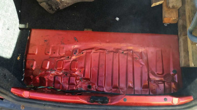

The bits of wood have been of some use straightening the 206's Boot Floor, having Routed them with a Router I was given some time ago but had never used.
I've also created some wooden Wedges and cut down a Brick Bolster to use as a Drift . .... but the real key bit of kit in sorting it out has been a couple of sturdy bits of Angle Iron; its not yet finished but I'm delighted with the results so far

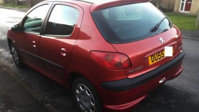

2: the 206 is sorted for now (I've replaced the Fog Light since the pics were taken) and so is ready to be pressed into action when the 405 comes off the road for its much delayed work
1: just purchased Low Ash oil for the Focus, Euro's have a 60% off sale so Mobil's Super £49 a gallon 3000 5W-30 works out very reasonable. It'll also be used on the Polo... but the 206 has a record of an oil change 2k ago, so no need there.

Now that looks a helluva lot better than what it did
, that boot floor's never going to win any beauty contests & nor is Daniel's cars inner rear quarter but the shell's at least close to the shape it started out as & should serve well whilst the 405 gets some love. Just have to hope the 206 bug doesn't bite you as hard as it has me, else we'll have some competition! (the more time you spend driving that thing, and knowing it has virtually free tax as well as great economy and decent power, they really do grow on you!)

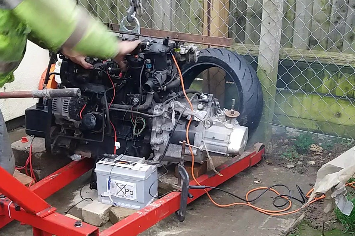

At last some progress with the 405. After overcoming inadequate Earths, weeping Injectors pipework, badly set Timing and the fact that this is the first time I've started an engine outside of a vehicle.

Well done, but I have to say I don't think you'll win any awards for Health and Safety!!
Onward and upward!!

no probably fair comment with regard to some seriously 'iffy' / absent H&S.
I did at least ensure that I wasn't in contact with the metal framework of the Crane while it was cranking.
Can't say I've yet experienced firing up an engine without its Gearbox, how'd you work that with regard to the Starter Motor?

Starter mounts on the block, I'd already fitted the flex plate/flywheelPug_XUD_KeenAmateur wrote: 05 Feb 2020, 09:19Can't say I've yet experienced firing up an engine without its Gearbox, how'd you work that with regard to the Starter Motor?
Come to think of it, that's likely another reason it was so lively (like an angry fish on a hook!) would have been the lightness of the flex plate compared to a manual flywheel (most of the mass is in the torque convertor so the flex plate is super light).

Aha, that'd work then.

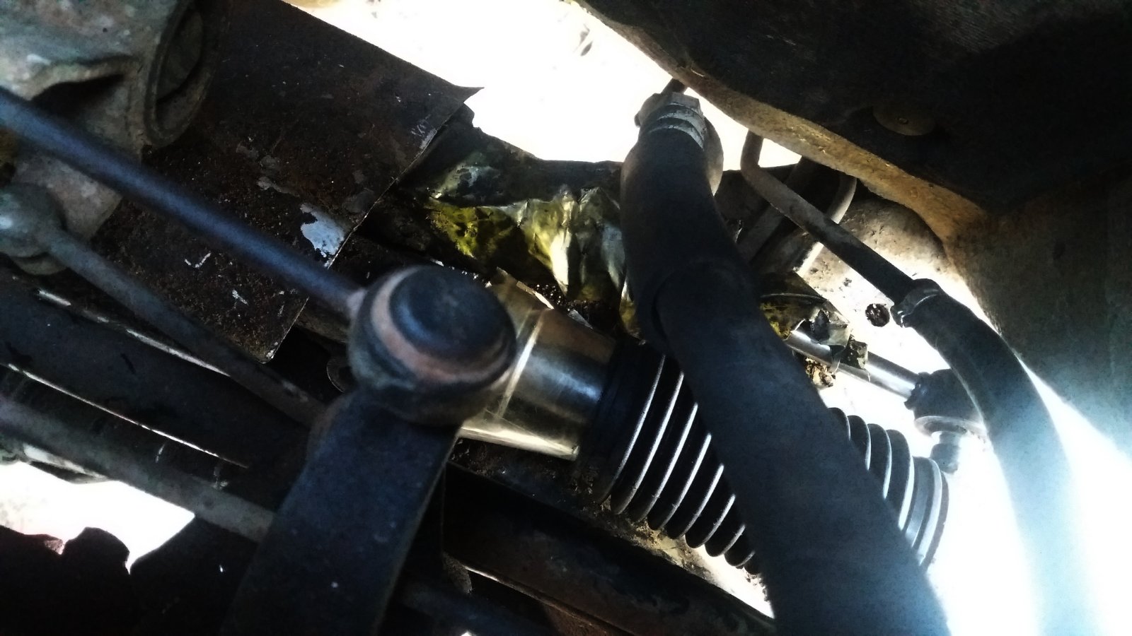

Meanwhile... check out my 'improved' Steering Rack Gaiter fitting Cone, tested on the spare rack; will report shortly on whether it makes the job any easier with the rack in situ.
The 206 has a rattly noise at Tickover, after its warmed up; which sounds a lot like an Aux Belt Idler to me. Certainly hope its not a Cam Belt idler as I'm far too busy to think about spannering on it. Am I gonna have to remove the Aux Belt to check it out, or is it likely to be visible if I look in the right place? The car has AC, so its a serpentine set up

...but that's the last time I attempt to replace a Rack Gaiter in Situ. It would've been considerably easier to have had it out.
...but I've got really good at getting recalcitrant Ball Joints out (Angle Grinder) and I was able to complete the works just before the weather turned really nasty; so now engine works can recommence, hopefully !

Naa, dat-ill-be bree allreetekjdm14 wrote: 04 Feb 2020, 19:22What's that?![]()
quite a thrill when a "loose" engine fires up and starts dancing on the chain/blocks... Though I daresay it was less "lively" with the gearbox attached, first fire of Black's replacement lump it tried to do a backflip and then when the wire came off the stop it tried to headbutt me
All good clean fun. (but in seriousness, do stay safe. )

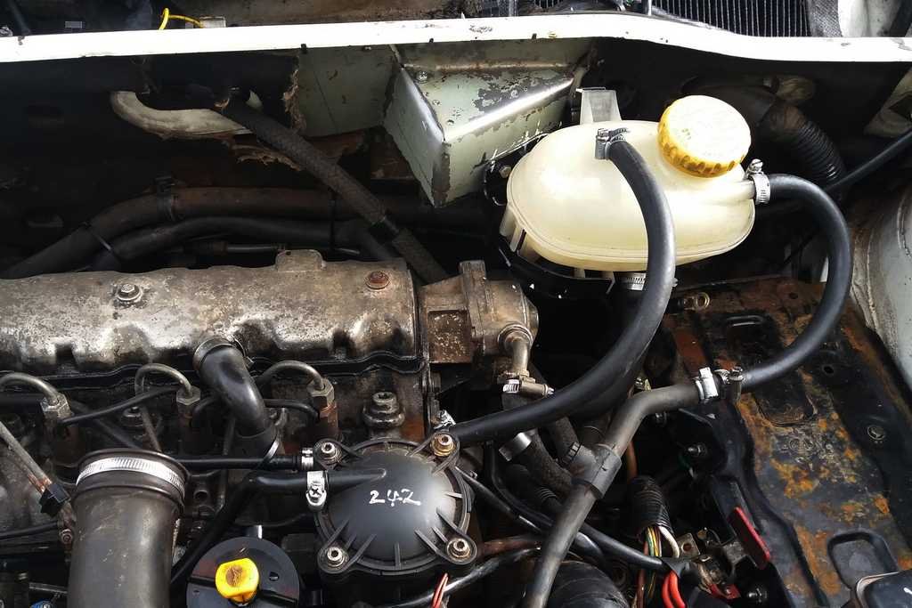

Header Tank is physically fitted and appropriate plumbing is in place with many thanks to Chris who, many moons ago, supplied helpful Diagrams As yet its un-tested...
