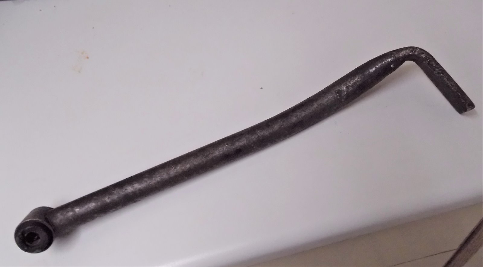

This is my home made pad pusher, it's a bit of Triumph Herald suspension link and I've been using it since disk brakes became popular on everyday cars.

Gibbo2286 wrote: 04 Feb 2020, 18:43This is my home made pad pusher, it's a bit of Triumph Herald suspension link and I've been using it since disk brakes became popular on everyday cars.
How very appropriate. IIRC one of the great advertising features of the Triumph Herald was that it had disc brakes fitted as standard. Might have been the 12/50, rather than the original 1200, but they had disc brakes long before Minis did.
