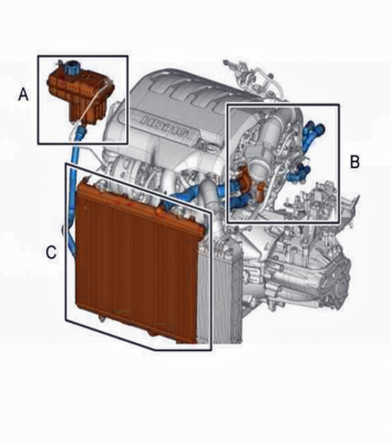

Ok, so best to do a clean and watch session to identify leak and then let me know which are the suspect zones from either of the 2 diagrams:

This is the circuit away from the Engine towards the Radiator
| Zone "A" | Area of header tank |
| Zone "B" | Area of coolant outlet housing - Exhaust gas recycling |
| Zone "C" | Area of cooling radiator |

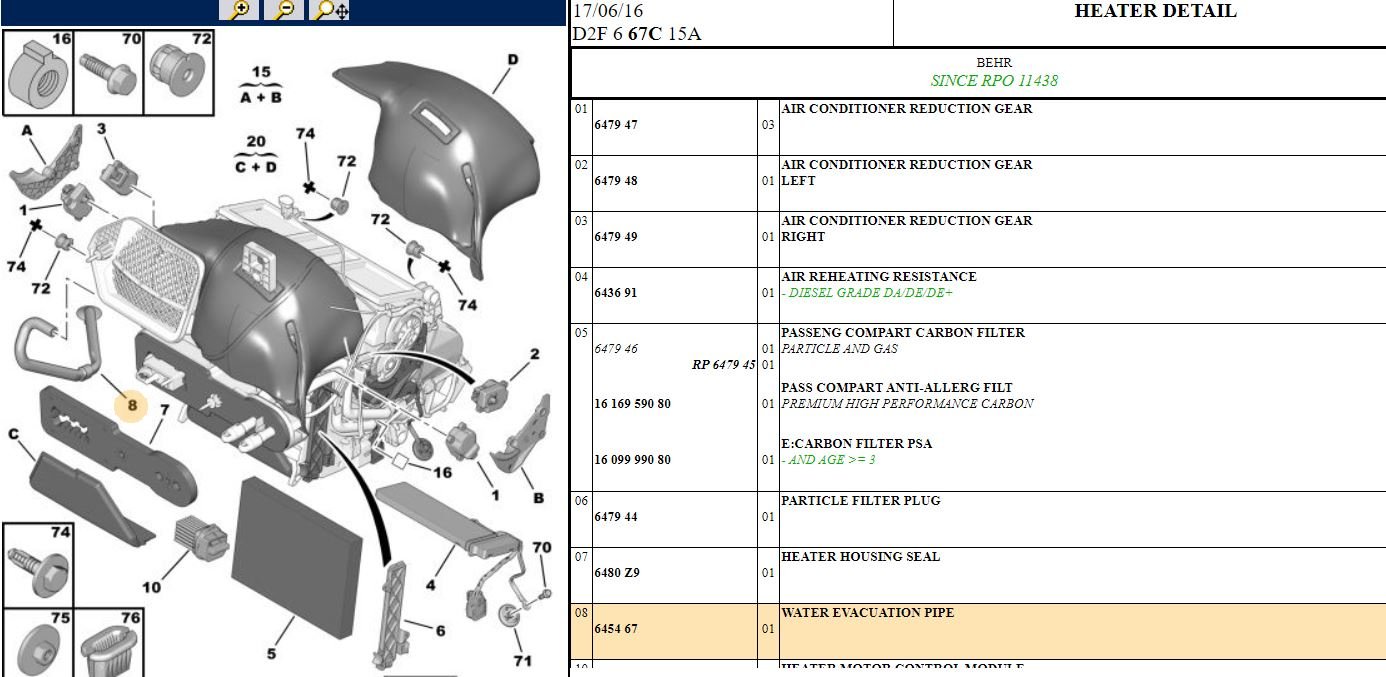

Are you sure that's not the water evacuation drain pipe from the Air Conditioning Evaporator?

Re: 407 heat exchanger
Is it diesel? These have a fuel cooler under the floor that fits your description. Air cooled though, so no water...
AC drain, item 8
This view is from the front of the car, so the drain appears to exit on the RHS - I assume yours is LHD so it should be on the passenger side somewhere. However, that's not to say it's not running across the subframe and dripping off a low point somewhere. I would check that it's not diesel leaking, however.... but having said that these coolers rarely give trouble.

Thanks very much Richard. Mines a RHD the the positioning would be correct. I held my hand under the drips when I saw them, give them a smell test, definitely water. That puts my mind at rest.
