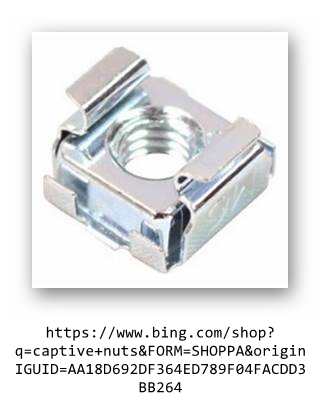

What sort of captive nuts? Citroen ones are usually in a spring steel case that just clips into the frame, if it those cut the head off the bolt and hit them out.
These:
These:

Re: Yet again thos van bites me on the a r s e
I have no idea, but the subframe still needs to come off to access them.
