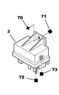

Re: peugeot 406 HDI. Igniion on pulls a good battery down to 11.15v
Tony,
GP relay will look like this, and is usually near the battery.
Heavy duty connections are on the underside - one perm +12 direct from battery, other is output to the GPs.
Small connector is control from IGN sw etc. The innards contain a small timing circuit for pre-heat and post-heat, duration depending on coolant temp.

- x 1751
Marc can advise on BSI reset - he's the expert on that one.
Glad you narrowed it down to the GP relay.
When you get your new one, and before bolting it down, connect it up EXCEPT the output cable to the GPs.
Connect a 12v bulb to the output (and Gnd) instead, and check the action of the new relay.
It is just possible that the fault was not with the relay itself, but with how it was being switched on through the multiway (5-way?) connector.
Just need to be certain that this doesn't happen again.
Might also be worth checking the GPs, in case any were damaged by being run continuously.
Each one should take about 9-10amp.
You might be able to test without removing them, by just removing the cable that connects all four together.

Chris, I have checked the glow plugs by removing the power lead and looking at resistance. They seem to be OK. I then did the bulb test and the light did go out but took about
seven seconds. Does that seem about right? The dash glow light only stays on for a couple of seconds. Still it does seem to be working OK. Have got to refit the drive belt

GP relay sounds AOK.
Dash light will go out quite rapidly, as soon as the GPs are producing decent heat - takes only a few seconds - and is earliest chance of a good start.
The 7 secs is what the system thinks is needed for GP operation at the time of your test. It is checking coolant temperature. Post-heat - after engine fires up - (for a 'smoke-free' start, and 'lowest emissions') can last anything up to 3 minutes in sub-zero conditions.
HDi engines get a lot less GP heating than previous PSA diesels, and will usually start without it, unless really cold. XUDs, on the other hand, really struggle to start quickly and cleanly without all the GPs working.
Good news.
