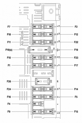

Ok John, so one thing you can try for me. Go into the driver's side compartment under the dash on a left hand drive. There should be a small flap that drops down. This is where the BSI and the internal cabin fuses are located.
On the BSI, there will be one particular fuse we are interested in. It's called the Park Shunt Fuse and has 2 possible positions. In one position it will be APC+ which will only allow things like the radio co come on when the car is running or when the ignition is switched on. If it is inserted in the other position, supplies are wired to the battery permanent.
I suspect the Park Shunt fuse has been removed for testing at some point and inserted in the wrong position, and this is why some of the systems are not getting power once the ignition is switched off and also why the settings are not being stored
So here is a diagram of the fuse in question (click diagram to magnify)
It is a 30A Fuse 19 / 19 (a).
Position 19: When it is in position 19 shunted to the right, it is in transit position and cuts permanent supplies to locking and Audio and internal lighting systems as examples.
Position 19(a): When it is in Position 19(a), shunted to the left, it is in the normal Customer Position and allows a permanent 12V supply to certain equipment as mentioned above.
I think this is is the solution to your issues.
