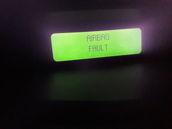

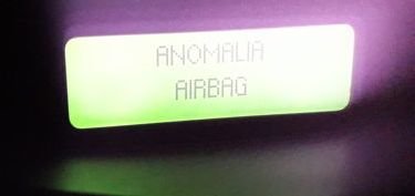

Can you please describe or put up a picture of the error lamp / message?5. On ignition-on, it gives an air bag problem error;

See pics, in English and Italian.Can you please describe or put up a picture of the error lamp / message?

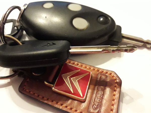

Here's a pic of the two different keys.

Your second key will have the transponder chip built into the plastic part in that case.
