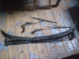

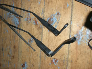

Anyone know which way round the wiper arms go?
and a supplementary if I can
The plastic scuttle (I think this is the right term for it) mine is in 2-bits is this normal?
I had a windscreen replaced and the scuttle was not resealed and just butting up against the screen. It appears there was a originally a rubber sealing strip. Its US now and I am in the process of scraping the remains off.
On reinstalling the scuttle is a bit of bathroom silicone the type of thing required to seal the scuttle/screen?

Hi Neil,
The scuttle should be one piece. Don't use bathroom, sealant, its crap. Use proper windscreen sealant or instant gasket to reseal the scuttle trim. If you want a good replacement one, I have one here spare.
The wipers as positioned in your second picture are correct for re-assembly, the longer arm before pivot goes to the drivers side.
Robert

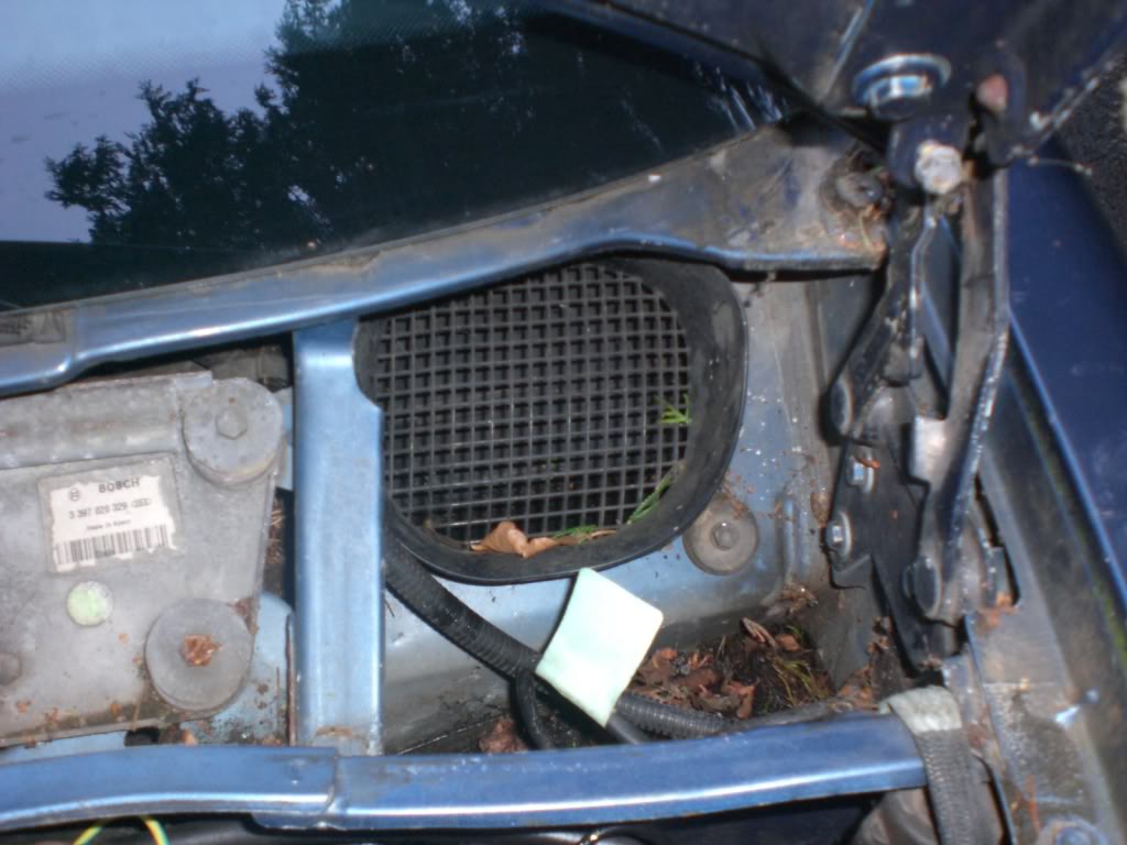

I had it just 100% wrong. Thanks for letting me know you have a good complete one available but for now I think I will just use the old one and seal it up with some decent sealant. Is a duff windscreen scuttle seal one of the reasons for a soggy footwell?
Thanks
Posts: 55003
x 8331
Re: Xantia-Wipers & Scuttle
Absolutely Neil, if the scuttle is cracked and not properly bonded to the base of the windscreen then rainwater will simply pour in through the air intake and straight under the passenger footwell carpet.
Only one way to dry it out and that's to have the carpets and underlay foam out. That means having the seats and centre console out :(
Robert's right. Only use quality automotive grade silicone RTV sealant on the scuttle panel.

Here is the missing scuttle, and the air intake
add a soggy Northumberland Sunday

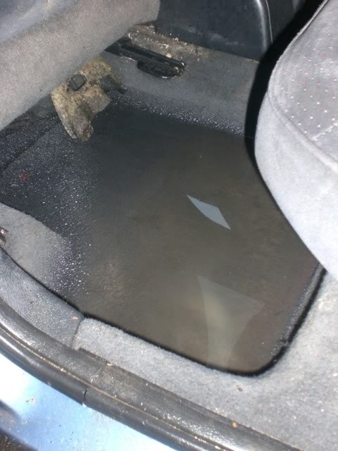

Here is the puddle in the footwell
VertVega
Posts: 1178
Joined: 01 Nov 2008, 19:39
x 13
Unread post by VertVega »
It seems that it has been raining cats & dogs :)
Heater blower must also be soaked totally. It's worth checking if there are other
places from where rain water got in. Start with lifting rear seats. Are they wet?
If it's an Estate then check under the trunk carpet also.
About the wipers, driver's side has shorter arm & longer blade 8-)
