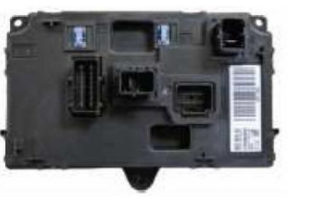

This is the fuse box:
There are specific compatible electrical wiring kits for this vehicle depending on 7 or 13 way. There are specific harnesses that depend on your multiplexed architecture, so I would talk to your dealer to ensure you get the right one - there are over 20 types.... so no point in me listing them all here as the right one is still hard to ascertain.

Re: 407 2.0 16v hdi towing wiring
No I don't have that either. Thanks Marc will check with dealer.
Ok, best option as I don't want to recommend the wrong one - these have different options depending if you have to power a fridge or want additional connections, bulb out warning s etc...
