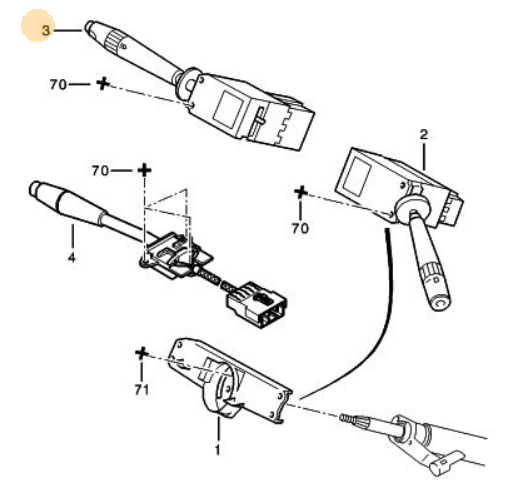

Ok, so this has the earlier individual stalk modules. On these, it's the internals that wear out.
The part number is: 625369. Watch out on ebay as there are some pretty grotty used ones for the same price you can get a new Valeo one.
Here's a link with some options - the Valeo one looks a good buy:
https://spareto.co.uk/oe/625369
No programming, just remove the old one and plug the new one in. Be aware of the airbag and always disconnect the battery and leave the vehicle for 15 minutes after to discharge the Airbag ECU capacitor. I don't have a removal fitting guide, but should be relatively easy:
Item (3) below:
Item (3) below:
