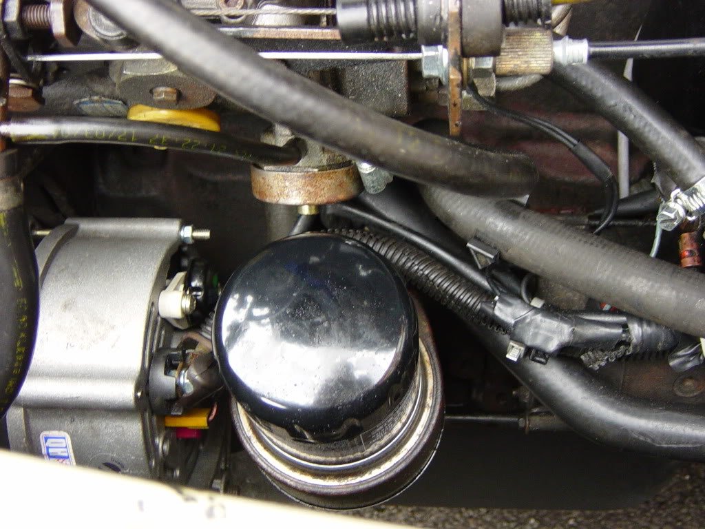

Is this the problem item (pancake cooler under horizontal oil filter) ?
↓ click to enlarge
↓ click to enlarge

Yes that is the problem. The engine currently has that type of oil cooler fitted, but it is touching the radiator.
The upright cooler some 205 turbo diesels had looks like this Just having some trouble finding a part number for the cooler on servicebox

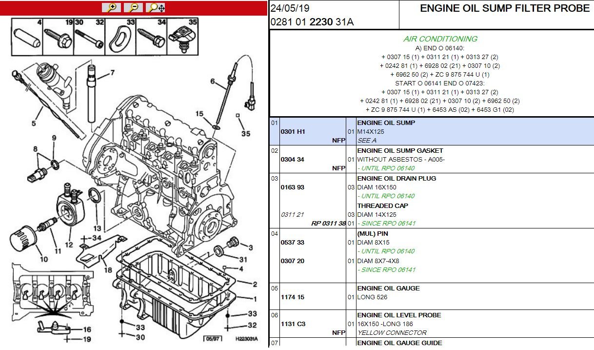

There is a part (an aluminium casting) that turns everything through 90deg.
The machined smooth surface on these engine blocks will accept
- a horizontal oil filter screwed directly on
- a horizontal oil-water heat exchanger + oil filter (like the diag above)
- the casting I mention, which will support heat exchanger + filter.
All have identical smooth mating surfaces and M20 threading, and use the large square-section O-ring you find on oil filters.
Will try to find a part number for you tomorrow, unless night-shift gets there first.
