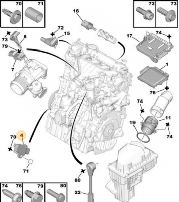

Ok, so may be better news initially in that all these faults with the exception of the pretty standard glow plug fault are related to speed anomalies. As the speed data is essential for many components (Engine ECU, Suspension, ABS, Gearbox etc.), a fault here will have a knock-on effect.
The most likely suspect is the Engine Crankshaft Sensor / Speed Sensor. In simple terms, it's a Hall effect sensor that, as the teeth of the crank pass the magnetic tip of the Crankshaft Speed Sensor, it sends a low or a high wave (voltage) when it detects either a tooth or a gap in the Crankshaft. So P0337 and P0338 are saying there are too many low signals one minute and too many high signals the next - which would indicate that the sensor is knackered and sending the wrong data.
I would not ignore this as you have seen, although the car may run ok for now, this will likely get worse and can result in bigger problems. It certainly won't do the gearbox any good or the engine with all the jerking that may increase.
The Sensor is located at (4) below, and is part number: 1920GJ, and costs £62.14 direct from Citroen inc. VAT if you want an original one.
I think that's your best starting place. Once you have the sensor replaced, you should clear the faults, then take the car for a good run and that should clear the other related faults all being well. Any remaining faults ca be looked at knowing that the crankshaft sensor has bee replaced.

All fitted. Faults cleared. Done about 20 miles. So far so good!
Thanks again Marc!
