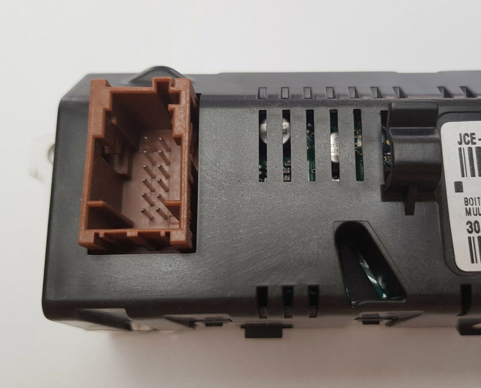

Re: Peugeot 407 Display Repair or Replacement
Is this a Johnson Controls unit?
- x 6946
Yes - you can also see the label 'JCE'
