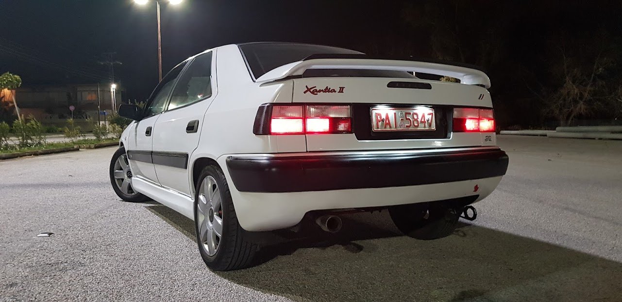

So, after almost 3 years of having this car, a lot of changes were made.
Visualy, the car is black topped now. The hood and the roof are dressed with carbon look film, as well as a lot of exterior parts.
The front headlights opened, painted black to the outter mirror part and got their LED lights.
The front indicators as well as the red part of the tail lights were tinted a little.
The front bumper got a bottom lip, a couple of holes nearby the licence plate (for better ventilating) and I manufactored a pair of headlight water injectors (this part wasn't available in Greece, cause this model was not imported with this extra feature).
The hood front grill was replaced with a mess grill that I also made.
The front foglights were removed (for now) and the holes are used as air intakes for the air filter.
The rear bumper got a big opening at the bottom (I might make a rear diffuser there)
The factory trunk spoiler raised by 2 centimeters, and got a rubber lip as well.
The Zender sideskirts were found (This part , also, was not importex in Greece) and installed.
Mechanically, the engine was replaced - combined with a 1800cc 8v. I kept the ECU , the intake, the fuel injectors and the cam of the 1600cc 8v, and replaced the engine block and the cylinder head. So, now the car is a 1800cc 8v.
All the engine hoses are upgraded, and I installed an oil catch tank.
Every hydraulic hose that was weathered is replaced partially with Polyamide hose, and the plastic multi-connectors are replaced with metallic ones.
I, also made a custom air filter intake, and I installed a grounding kit.
All the plastic parts of the car that were weather or cracked, were replaced with new ones.
In the interior, I have replaced all the lights with LEDs.
The radio unit is replaced with a 7" radio screen.
The floor carpet is replaced.
One small repair - upgrade at the time. I have a lot of plans for future upgrades.
