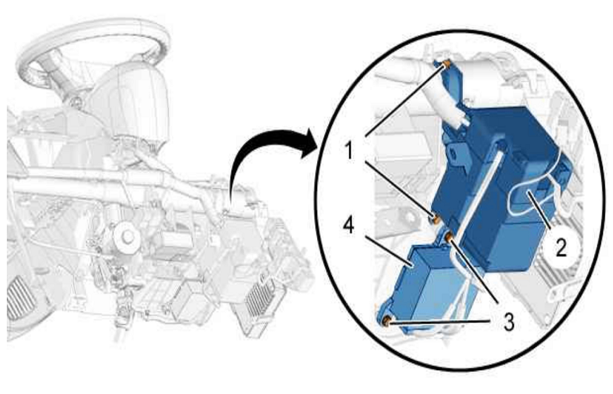

Can anyone tell me where the power steering electronic control module is on a Peugeot 107 (06 plate) and how to remove it?

I'm afraid I can't help with the location, except to say that Service Citroen has the ECU on the same diagram as the rack suggesting it's located above the rack... What I will say though is, why do you need to remove it? Have you conclusive proof that it's faulty? Only, I've recently been looking into the EPS on my mum's car which is also an '06 107 (on 24k miles) and there were numerous inconsistencies with the amperage draw measurements in Diagbox and occasional limp mode with the only fault listed as being a speed sensor associated with the EPS ECU.

On the 107 with electronic Power Steering, the ECU is actually located in the upper dashboard Danmichael maurice wrote: 19 Jan 2020, 00:09 Can anyone tell me where the power steering electronic control module is on a Peugeot 107 (06 plate) and how to remove it?
The Control unit is (2)
The ECU is (4)

Aha, thanks for pointing that out Marc
I had a feeling near the rack was a strange place to locate a sensitive ECU. How do I access the actual layout like you have, is that the paid subscription part of Service Citroen?

To be fair Dan, some are actually mounted on the steering rack so are easier to access.
