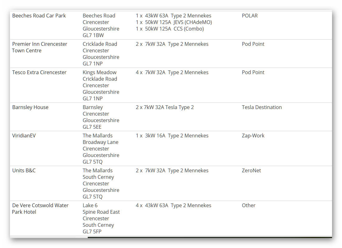

So, thinking about buying a Leaf but its range is just about on the scary point for a trip from my place to Cirencester.
Had a look for charging up there but what does all this mean ?

ABout 38 Miles? I would be topping up in Cirencester, with an alternative and range in hand should it be out of action. Stroud seems to have a few chademos.Gibbo2286 wrote: 18 Jan 2020, 14:50 So, thinking about buying a Leaf but its range is just about on the scary point for a trip from my place to Cirencester.
With a Leaf when you are out and about the Chademo is the only rapid charger you are looking for. For me Charging from 20-80% will take around 40 Minutes.
The other chargers rated at 7kWh/32A will take around 2.5 hours to charge from 20%-80%. I have a 6.6kWH charger in my Acenta Leaf. Not really practical if you are out and about on a longer journey.
As mentioned in this thread, there are many clubs and providers. I joined Polar Plus part of BP Chargemaster and the one which operates the Chademo charging point at the Beeches Car Park Cirencester.
The others on your list run by Pod Point require a smartphone app to activate. Lidl and other supermarkets tend to partner with them.

49 Miles each way for me Neil without doing any wandering about that's why I was looking at the likely pitfalls.
Maybe I'll stick to the Nissan Note diesel idea for now.
