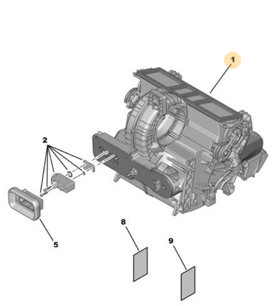

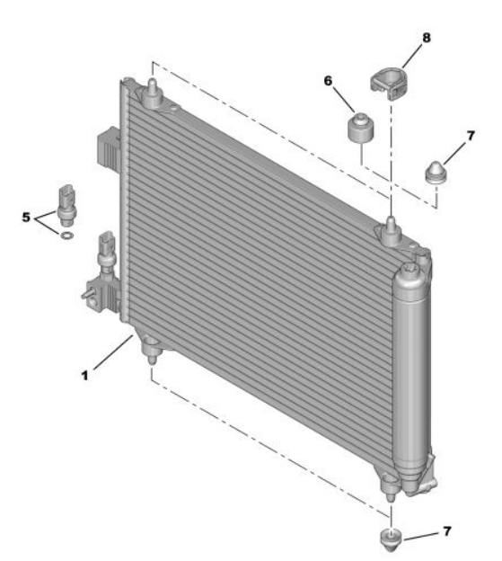

Just to be clear as terminology is often confused:- are you referring to the evaporator housing or the actual condenser drier unit (radiator)?
Evaporator Housing UnitCondenser Drier Unit

So if it is the condenser, Citroen offer a cheaper alternative for cars >3 years: Part number: 1610161580, £271.46 inc. VAT from Citroen.
However, just Google "Citroen 1610161580" for plenty of aftermarket options.

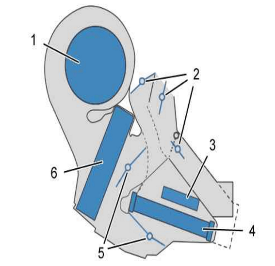

Unfortunately I can't locate a separate part number for the evaporator alone, item (6)
(1) Air blower .
(2) Distribution flaps.
(3) Heating resistor (Depending on the versions).
(4) heater matrix.
(5) Mixing flaps.
(6) Air conditioning evaporator.
