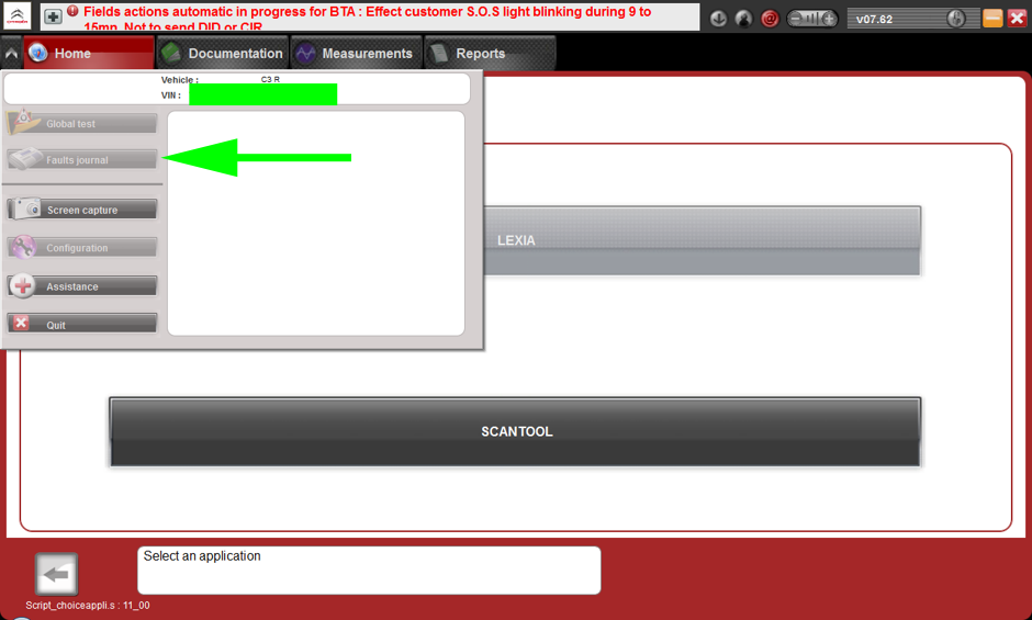

Re: Am I being done over? C4 Picassio 1.6Hdi 2011
You're all wrong on this
There should also be a history of fault codes that can be accessed. I've seen it a number of times when i wanted to know how long a fault code has been triggered.
I had this for a rear light on one of our vehicles - reversing light had been intermittent - no permanent fault code generated - but there was a history of it in one of the log files. It showed me that the fault had been triggered over a year or longer and had about 100 triggers - and the same with other faults we had (oil pressure switch), again no fault and has been cleared, but showed up historically - which is useful to see. These were using Lexia. The diagram below is for Diagbox as Roger has a C4 Picasso which will use this software.
This log is maintained by the BSI itself - accessible from the top left menu somewhere IIRC. It should list all the historical faults.
Update:
I've just dug up my Diagnostic kit to show you - Here is where you access historical logs: There is an arrow in the top left corner under the Citroen logo. Click this to get the drop down menu shown.
Now most mechanics / workshops rarely go into this section (as it is always closed), so there is a good chance that you can retrieve this data (remember it will be stored in the BSI and not with the dealer, so I would suggest Roger, that you try an locate somebody with Diagbox who can access this log and print it off for you as evidence, and hope that the entire history has not been manually and deliberately erased.
This is different from a Global Test and reading / clearing the faults from a diagnostic scan - this is a historical record I am talking about here which will remain until it is deliberately erased.
Update:
