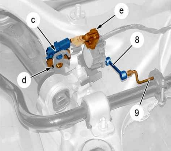

I tried to look at the height sensors, the rear one seems okay. The front one i couldn't find?

The front height sensor is on the right front wheel (standing in front of the bonnet facing the windscreen) near the subframe. Not easy to get to.
It may be sending incorrect height data to the suspension ECU, so it keeps operating the pump. I suggest you don't get underneath it unless you have is supported independently - or there is a serious crush risk if it drops.
Don't keep the pump operating either - leave it in normal height position unless absolutely necessary - or you will overheat the pump, blow the fuse and cause more issues.
I had both mine replaced as it was sometimes raising other times not - would stay at normal height - but it also deactivated my directional headlamp functionality for obvious reasons. It was done under warranty by the dealer as the subframe needed to be loosened several centimetres - wheels off to get to.

What Diagbox will do is will show you the heights as you change position - you should see reference positions against actual if memory serves. But the height correctors are analogue devices, without an ECU incorporated directly - they just send the track data to the suspension ECU. If they were given off the scale readings the suspension ECU would log the data as invalid - but all the time the data is within acceptable ranges form low to highest, it may not throw a fault.
Best thing is to run a global test, then go into the suspension ECU (Suspension_ECOTECH) and then select some of the standard parameters and see what you get.
