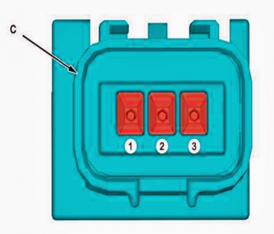

But the supply voltage is 5V....
Pin 1 is the Output Signal.
Pin 2 is the Earth
Pin 3 of the connection to the differential pressure sensor is the supply voltage (5V)
Pin 2 is the Earth

Have 5V on pin 1 and 3 on this car.

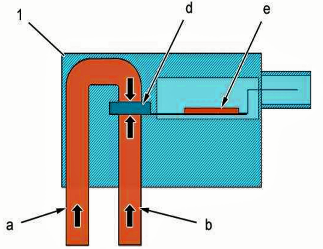

Re: Peugeot Boxer, fault codes and turbopressure
Ok, that is also normal and within parameters, depending on the pressure difference:
The particle filter differential pressure sensor measures the difference in the pressure of the exhaust gases between upstream and downstream of the catalytic converter and particle filter assembly.
Function of the Differential Pressure Sensor
The resistance of the particle filter differential pressure varies as a function of the difference between the pressure upstream of the particle filter and the pressure downstream of the particle filter (the greater the difference in pressure, the greater the resistance).
The sensitive membrane "d" receives the pressure upstream of the particle filter on its upper face and the pressure downstream of the particle filter on its lower face.
An electronic stage "e" amplifies the signal produced by the sensitive membrane "d".
So the graph shows us that 4.5V (and there is a ± 2 to 4% tolerance of error depending on the temperature) is a valid reading. Not quite the 5V you measured.
So what you have to determine is whether the 5V on the output pin is due to a blocked DPF (higher voltage where there is higher pressure difference between downstream and upstream) or whether the wiring has been damaged by heat / is shorting out and is causing incorrect / permanent 5V on the output pin.
So a thorough check of the sensor wiring harness is recommended first of all before looking at the DPF and whether that is blocked and needs cleaning, or the sensor is faulty etc...
But as I mentioned - on this specific vehicle there was a technical bulletin because of this specific problem as I mentioned in my PM.

Have been thinking about, if this can cause the differential pressure error ? Or what do you think Marc ?
Sigbjørn
But do you have some idea or seen before why I have so high values on temperatur particle emission filter upstream : 1271 celsius ? And it does not regulate... Be same after change the temperatur sensor. Have also checked the wiring to this temperatur sensor, but same as the pressure sensor, can not find some problems in the wiring harness. (When last time checked.)
Sigbjørn
