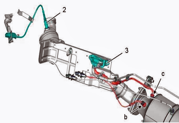

Engine ECU!
Ok, that's clarified it... and I think you are referring to the differential pressure sensor... I'll take a look shortly.
This is the location of the sensor while I look at the diagram for you.
(2) Oxygen sensor .
(3) Differential pressure sensor.
"b" Temperature sensor upstream of the catalytic converter.
"c" Pressure take-off upstream of the particle filter.
